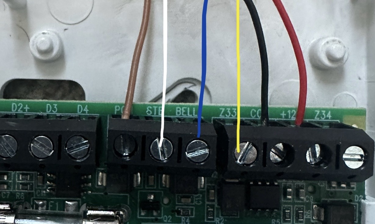

Hi I would like to wire Texecom siren on an Enforcer Panel and have the backlight turn on and off via user outputs. I have wired Core into 0v on siren and wired into PGM and link it with coms
But doesn’t seem to work is this possible to do I know u can do it on Euro panel as NC and link C to 0v on the top left relay

Hi Guys thanks for the reply, after posting I figured it out but I’ll share anyway.
In the texecom odyssey x siren wire it as normal but undo the backlight negative & twist with a spare core and jelly crimp it & wire into PGM on Enforcer PCB.
Then you go into change outputs
Endstation outputs? press yes till u get PGM O/P make this User defined 1 (0170)

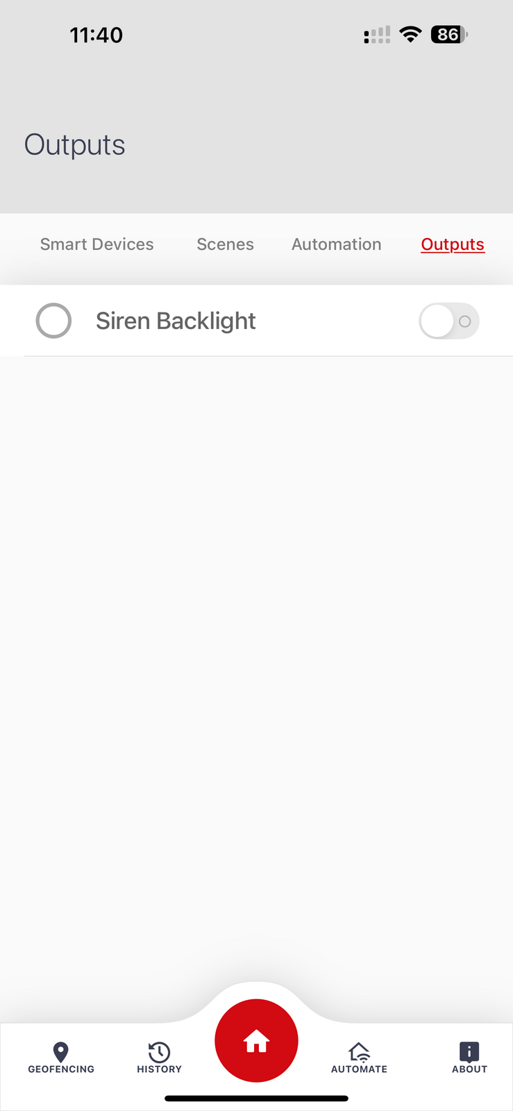

Then go to User output? Yes then output no 1 name it Siren backlight and type to be Latched
Then go on Home control 2.0 app & in Automate you will see the output there this allows customer to turn backlight on and off on the siren so it isn’t always on. This can also be done on Euro & Texecom panels it was just my first time doing it on Enforcer panel client requested
