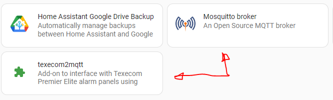

On HA go to Settings - Add-ons
Do you see Mosquito broker and texecom2mqtt? If so you have installed the Texecom add-on.
I should have the texecom but installed as I added repository and installed that eventually but not sure where I can add the bits I need to are located ie ip address udl in yaml file
okay done. looking a little better, helps if you make sure it is green and it has actually started, can see the configuration

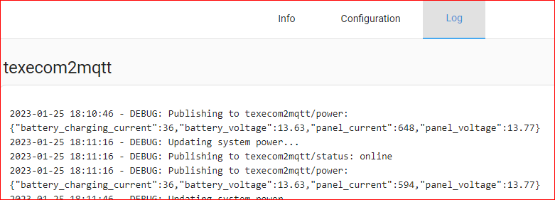

In Settings - Add-ons - texecom2mqtt look at the log tab at the top of the screen. If it is fetching data from the panel you should see something like:

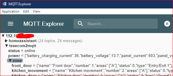

It also helps to install MQTT Explorer on your PC (not on the pi). Then you can use it to see what has been sent to the Mosquito broker and watch the zone status change from 1 to 0 as the zone is activated:
