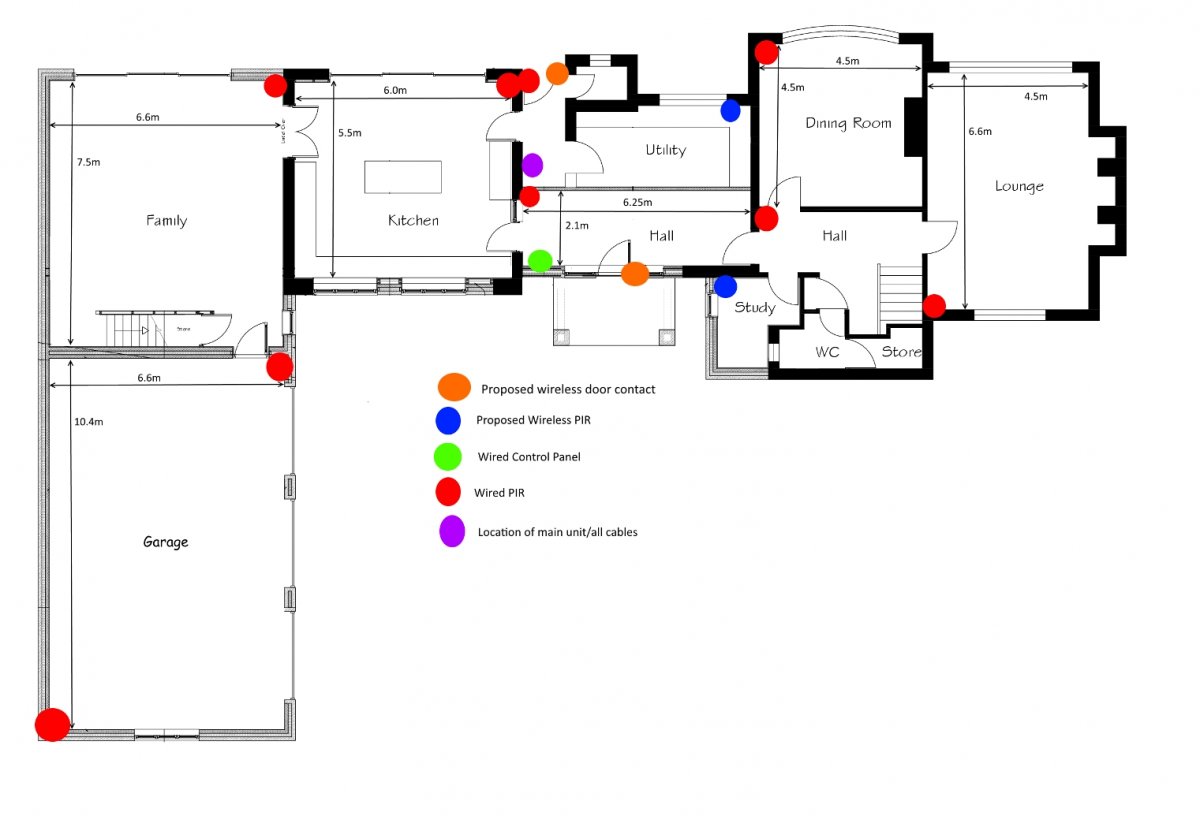

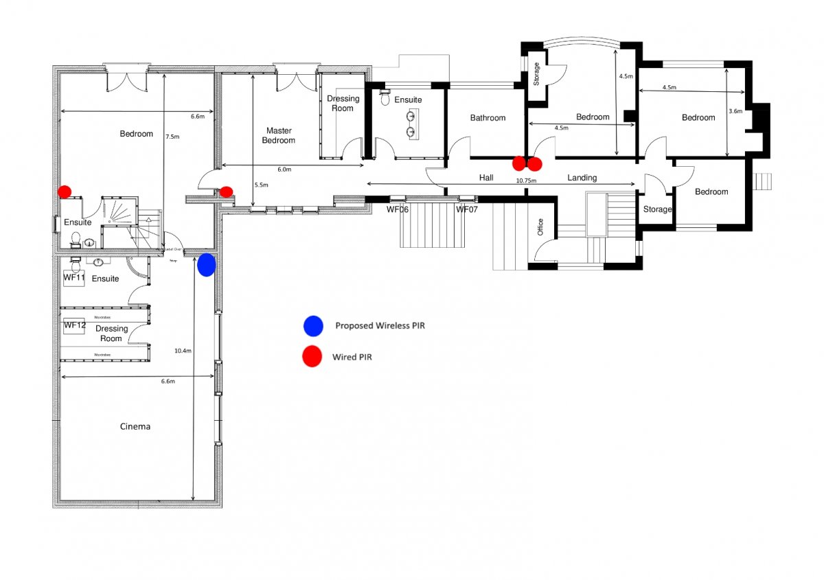

Im starting to think that wireless and my home just aren't good friends! Myself and the heating installer spent an age trying to get the evohome to work properly and had to re site some of the receivers for the boiler and hot water. If honeywell employed the mesh technology, the install of that system would have been so much easier. Its not that the house is ridiculously large, more that it is spread out and has more solid walls than a modern home.
Anyway, heres the layouts. Ive decided against door contacts on the juliet doors on the first floor (playroom and master bedroom). As there are PIR cables to those rooms anyway.
I am uncertain whether there is a cable to the cinema room for an alarm sensor, so have put down for a provisional wireless sensor in that room.
Im thinking of mounting a panel in the garage, using the cable I have installed for one of the PIRs, then running a PIR off that panel. Also installing a third panel in the rear hallway, and wiring two of the PIRs into that, seeing as the cables all run back to that area.
Out of the two sensors on the landing, I think I may be better off removing the one on the left (as any intruder would be stuck to the bathroom, or would be entering through another alarmed zone first) and using this cable to go to one sounder on the front of the home. It may be that a second sounder on the rear could be wireless, as it would be much closer to the main box, sited in the rear hall downstairs.
All walls downstairs are solid, and other than the stud walls that create wardrobes or en suites, all upstairs walls are also solid.
I think the only "ask" of a wirless system may be the sensor in the cinema room, but if this can relay through the door sensor on the front of the house, it may work - thats if I havent run a cable there.

Ground floor: Alarm Ground Floor.jpg
First Floor: Alarm First Floor.jpg
Is upstairs all loft or is there flat roofs ? You could mount expander in loft and run bell box from expander plus will also free up cable for bellbox
Nice house, I would ask whats in the kitchen behind the proposed spot for the panel, as sparkymarka suggests there are ways of freeing things up.
Just have to keep in mind on what you want on the system hardwired and wireless. Theres a hand full of wireless devices near the main unit and one near the cinema.
The distance shouldn't be a major issue, depends on the construction for the signal worst case its a device or two somewhere between the wireless expander and the cinema pir for increased signal security.
where you have detectors back to don't use DT's as they will interfere, with each other.
Mark is a lot closer to you than me though if your looking for a pro to do the install.
out of interest whats the walls construction and what cables did you use 4,6,8 or 12 core?

The solid walls downstairs are block, but not the light modern type, they're 1960s solid b*ggers.
The walls of the kitchen are all brick cavity walls (it was built out of the old garage and they just kept the double skin walls). So between back hallway and kitchen is cavity wall. Same between kitchen and family room.
This also follows upstairs, so wall between master bedroom and play room is also double skin cavity wall. Wall between playroom and cinema is cavity wall too, as is the wall between family room and garage.
I'm sure it will save a bit on heating bills, but it makes it a pig for wireless signals. Just noticed the evohome keeps losing one of the radiators in the cinema, first world problems eh?
If either of you fancies this project let me know. I've got more than enough on with the rest of the house, and a pro would have it sorted a lot quicker than me anyway.
Edited to add, cables are 8 core and it's all loft, no flat roof.
