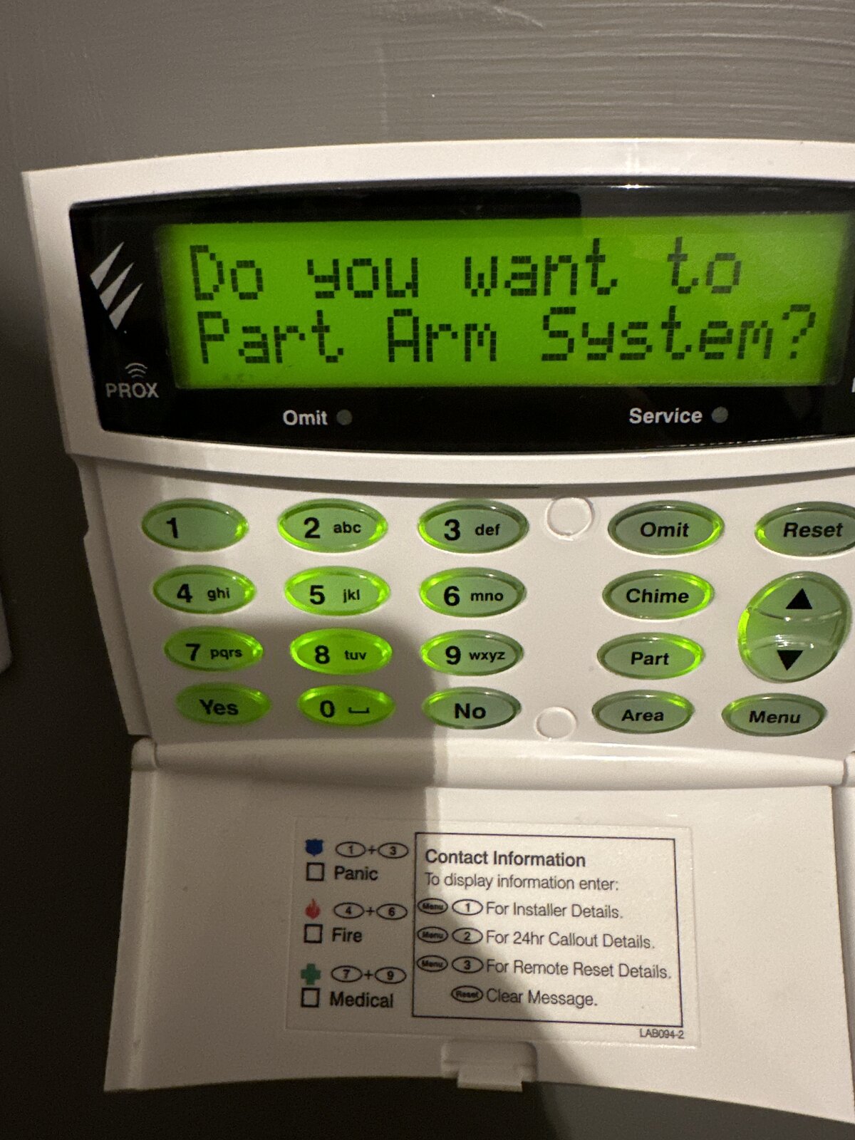

It looks I possibly don’t have the engineer code as I thought i did. I’ve been using my arm/disarm code as that took me to many menus. When I use it and press 2 it takes me to part arm system. I’ve tried 1234 and that doesn’t do anything. Looks like I’m stuck!
Here’s what I’m getting after code and 2.

The enable engineer is for the user to authorise the engineer Not to put in engineer mode.
until it’s sorted properly start the part arm and press chime, should silence thee it tone, although this may vary from firmware to firmware.
default Eng code is 1234 but this may have been changed or locked.

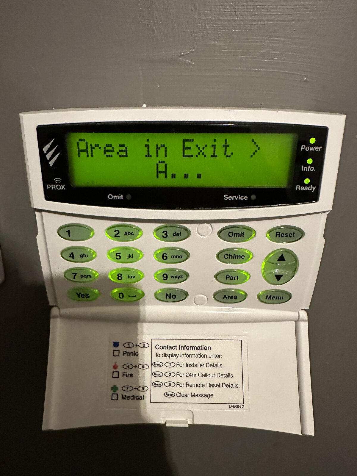

I’ve tried that and it does stop the chime, thank you. Next issues I’ve found is it looks like part arm is programmed to arm all. I’ll have to test in the morning. I get the same message for part arm as I do usual arming. Area in exit A. I was told A is for all.

is there a screen shot missing?
without checking, normally you select the part arm required.
so if you look in the event log what does it say about the process you have just gone through?
I’ll do the above again and report back what event log says.

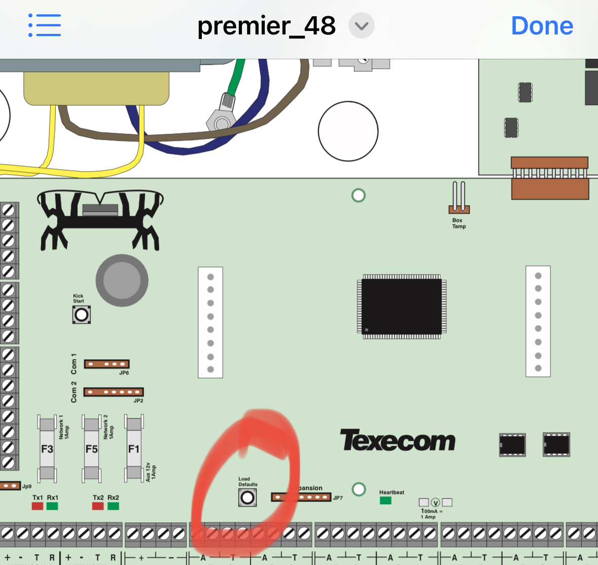

If your not on contract, then I would look at defaulting codes only and see if that frees up the engineers code.
As for prices can't comment on rates on your neck of the woods but doesn't sound overly priced in current market.
This button on the panel?
Edit. Just read the manual. I’ll give this a try. Thank you.
If he gets it wrong …..! How many times have people on here totally defaulted panels back to factory !
