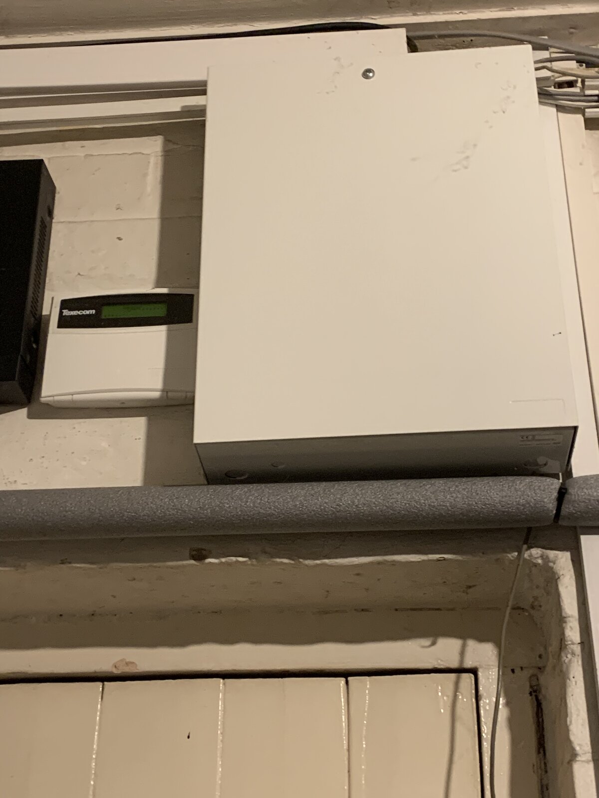

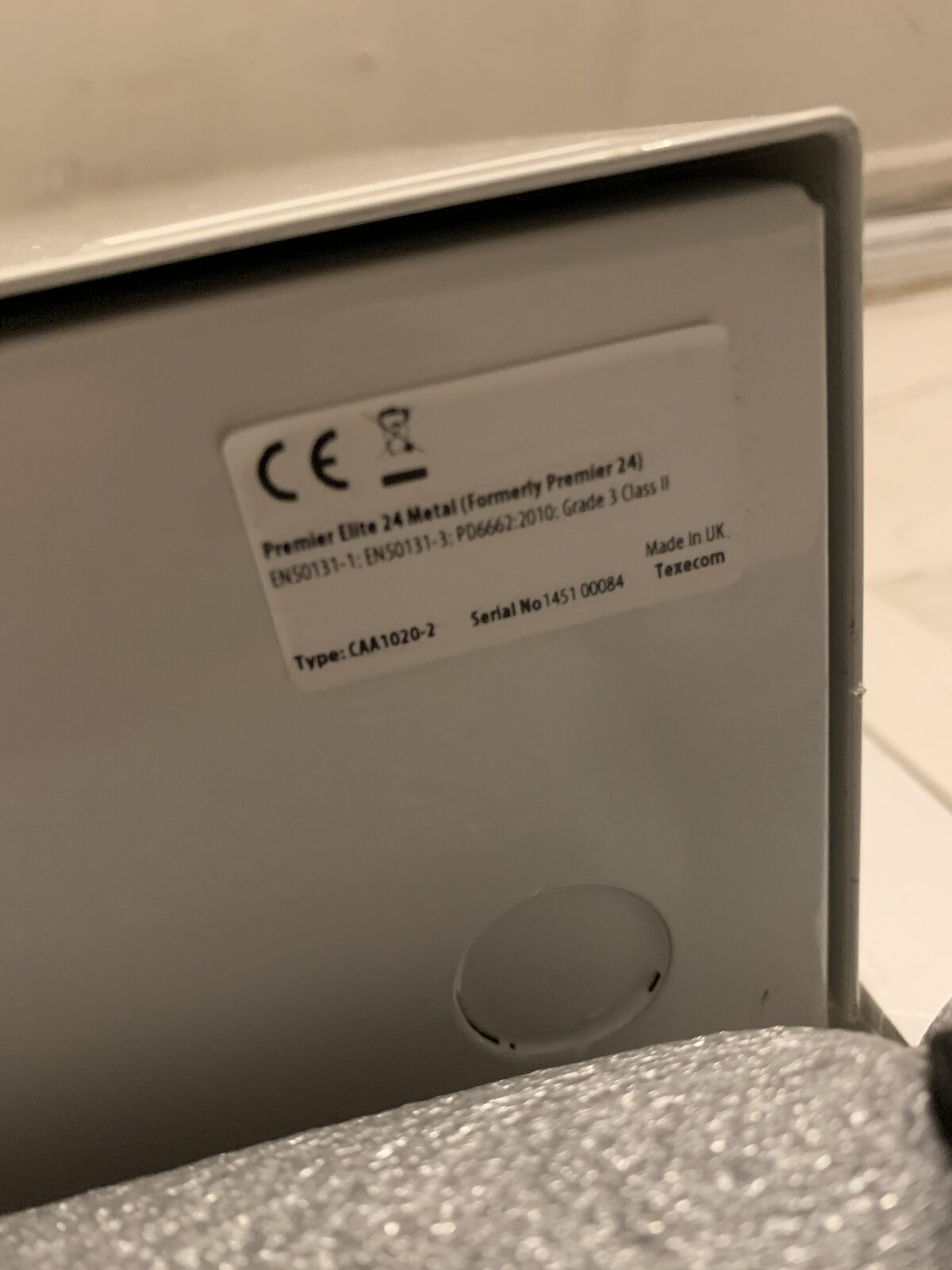

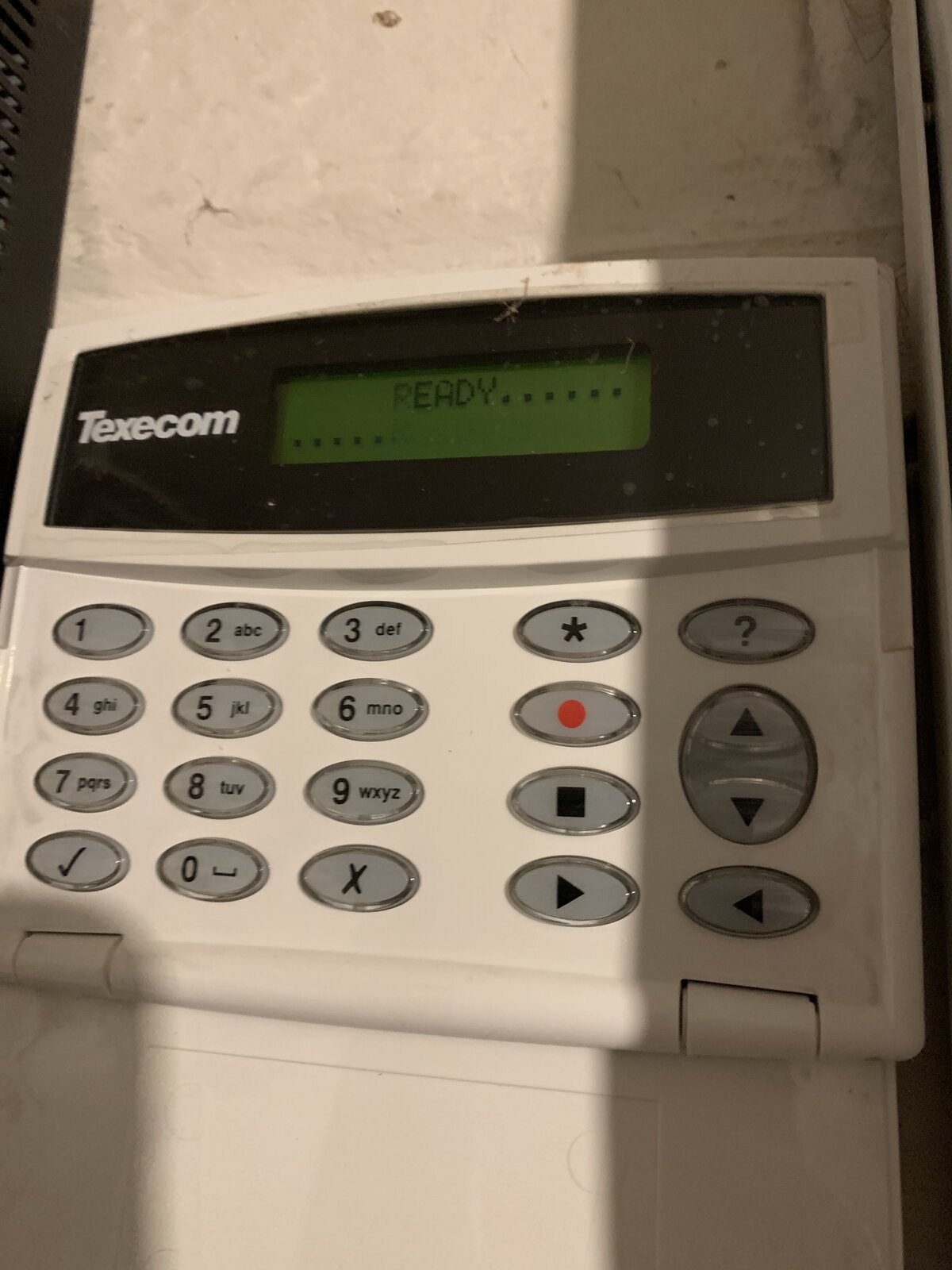

Right I was wrong there are two boxes in the garage.
The large is the Premier Elite 24 panel
I’m not sure what it does but it seems to have play and stop and record buttons so it might be connected to the security camera system…. It doesn’t look like a wireless expander that I have seen on the internet….
So do I need to get a wireless expander installed to use a SmartKey?

Perhaps I should explain all this was here when we moved in…
So if I enter the master code
Press the up arrow 7 times til I get to “do you want to view zone status”
Press tick
Then I can scroll through the zones and there are 16 in total….. seems each room/sensor is a different zone…
Is that the limit of the Elite Premier 24 box?
I wonder if there were 8 zones in the panel, the
Texecom CCD-0001 Premier 8XE Local Zone Expander for Premier Elite 24​
Was added and so there are 16 zones now and all 16 zones are used up so the only way forward is to add a
Texecom Ricochet 8XP-W Ricochet Wireless Expander GCD-0001​
Am guessing here …..(obviously)….
Thanks for help…
