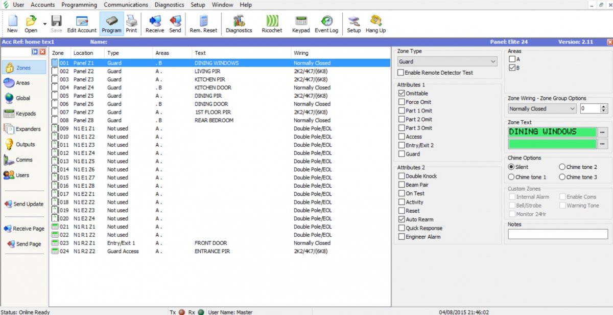

Ok, I have got it to semi work. Now when it gets to the time the panel just flashes 'Time arming > .B' and 'Timer 01 Active' (I have set the timer for zone B).
How long does that flash before it actually arms? I waited over a minute.
This is my configuration:

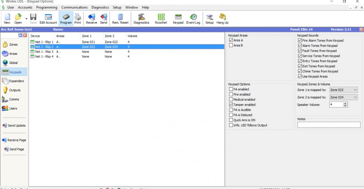

The installer put the front door and entrance PIR on zones 23 and 24 which have icons of keypads. Is this an issue?
I changed some of the areas to B as I am trying to create a timer on a part arm. Do I need to change any of the settings on the second page below?
Thanks.
I didn't arm at all?
It did eventually change to flashing between *Part Armed* and Timer active after a good few minutes, but I opened the doors and it didnt set the alarm off.
(If I do a normal full/part arm they do set the alarm off).
Your event log should be able you to identify what the panel recorded, if you armed area B and activated an area A zone then the alarm wouldn't have gone off.
but I don't know how its programmed or what the panel has in the event log so I would be just guessing.
