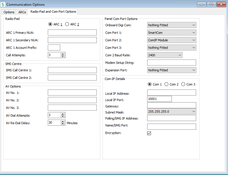

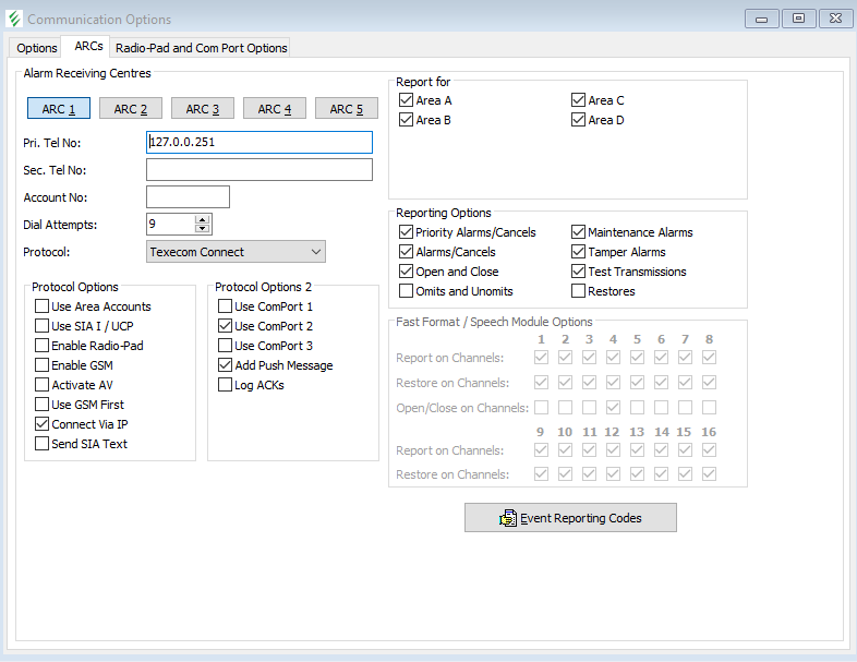

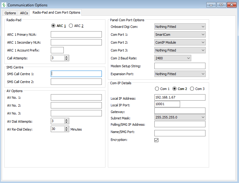

Hi all, thanks for all your help so far.
OK, on site now and I can confirm the following...
- Premier Elite 48 Firmware version is : 6.05.03LS1 (recently flashed)
- SmartCom CEL-0001 firmware version is 3.0.21 (Hardware revision 21)
- Wintex Version is : 8.2
I have the SmartCom connected and the 1st (from left) and third LED's are on (solid, not flashing). The SmartCom is connected to the board with the 4 wire cable to COM1 and the 2 wire cable to COM2.
I can connect to the panel via Wintex via IP so I know that the SmartCom is on the network.
The sequence of messages when trying to Enable Texecom are still the same as in the original post, I just end up with NO CARRIER.
Attached are the screenshots of what is configured.
Any further ideas?
Thanks again, I appreciate your help.
Are these details in the pane?
It sounds like the Texecom Monitor mode is on, Thid needs the programming off.
Then program ofg for the smart com and connect and then tirning it back on in the order specified in the manual at the keypad is probably easiest after the Texecom Monitor mode is turned off.
