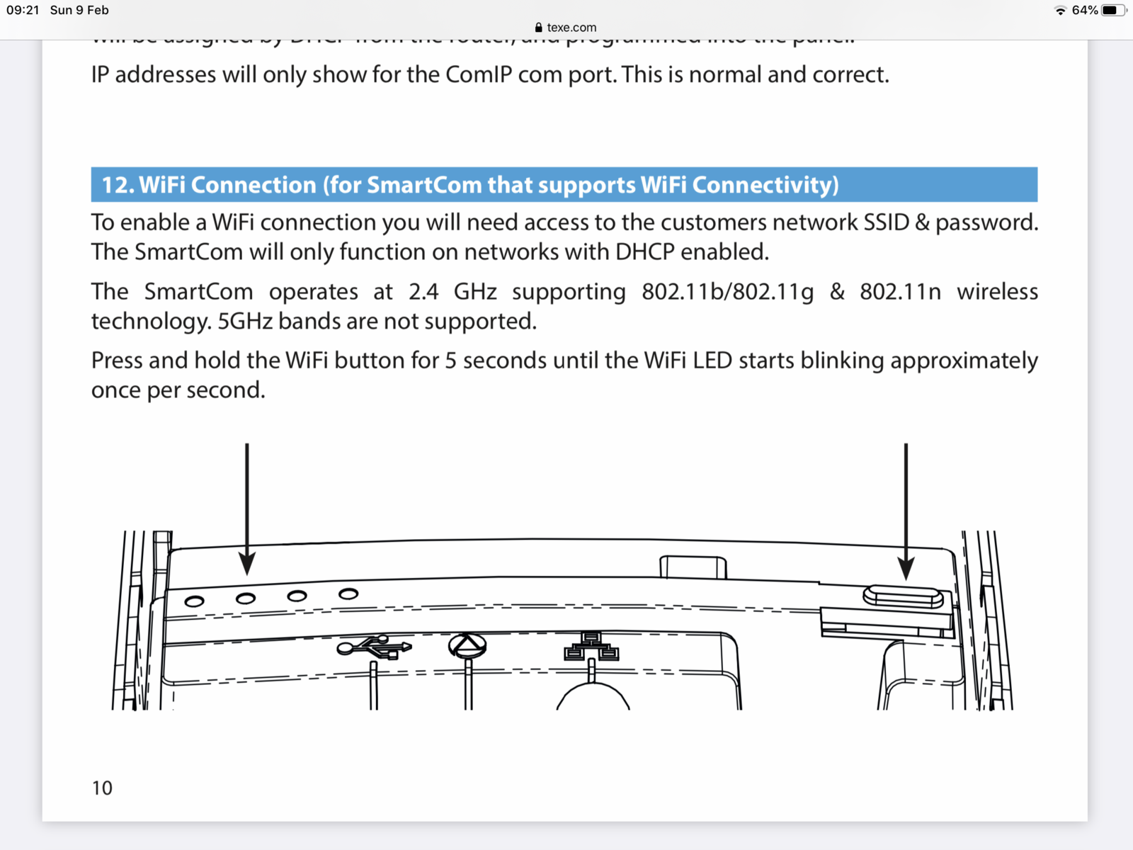

Is it a dual band router ? I’ve had to disable the 5g part before for the smartcom to connect to the WiFi
Hi sparkymarka. Single band router on 2.4g

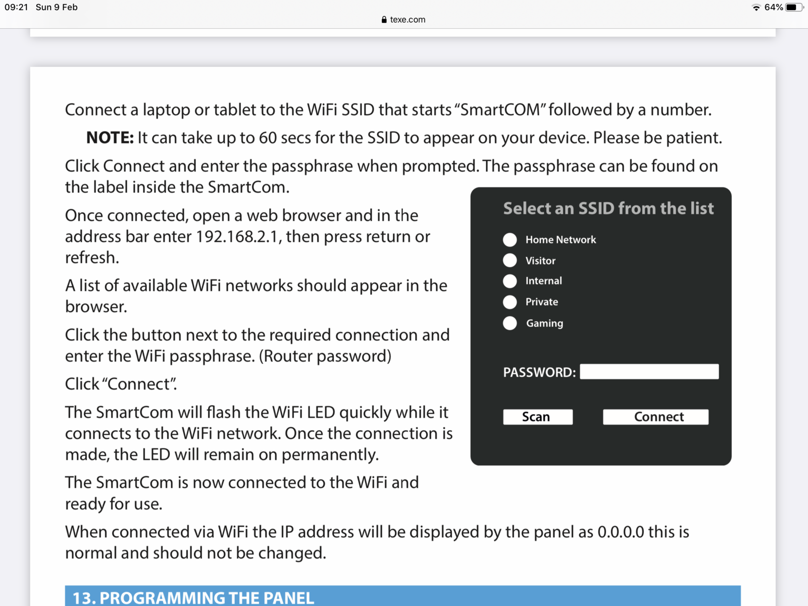

Did you follow the instructions on how to connect your smart com via WiFi ? It reads as you have just connected by Ethernet and expecting the unit to know the WiFi settings !

The SmartCom seems to be pre set with 192.168.2.1
Initial set-up states that when logged on to the Smartcom you the then use web brouser to search for 192.168.2.1
The search reveals nothing or it is timed out
To use the wifi on the smart com you need to press and hold the yellow/orange button for a few seconds.
connect a computer or smart phone or tablet to the wifi ssid ARH-----, pass inside the smart com unit
Once connected in a wen browser use 192.168.2.1
then select your wifi from the lst and type in its password
then once that's in you can come out of the smart com ssid and connect to the internet connection as normal.
if the router can see texe_hub then the smart com is successfully conected
