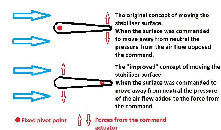

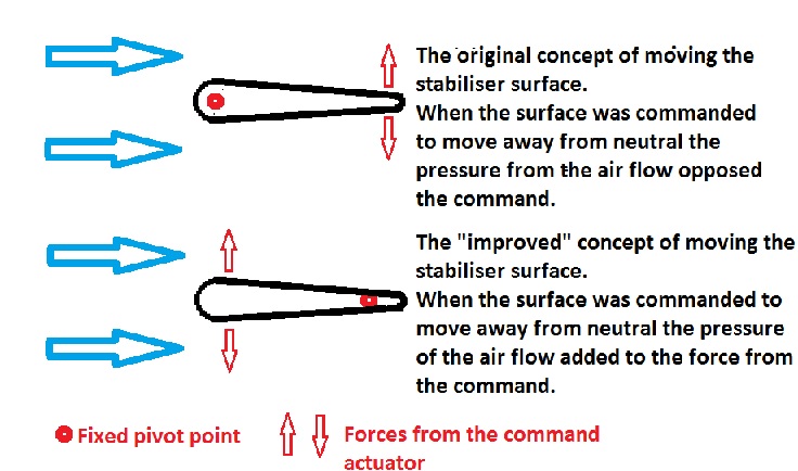

I cannot understand the logic behind the decision to move the pivot point of the horisontal stabiliser from the leading edge to the trailing edge.
With the pivot point at or near the leading edge the stabiliser air flow will try push the stabilisier back towards the neutral position. Force has to be applied to move it to create nose up or nose down when that is required.
With the pivot point at or near the trailing edge once the stabiliser is out of the neutral position force has to be applied to prevent the air flow pushing the control surface further and creating a steeper descent ( nose down ) or climb ( nose up ). This force has to be applied by the pilots if the electric motor has been switched off.
The MCAS system moved the stabiliser to an angle where the aero-dynamic force was too high for the pilots to crank the trim wheel enough turns to remove the nose down before the impact with sea / land. Had it happened at 30,000 feet then the pilots might have had time to turn the trim wheel enough times to remove the nose down
