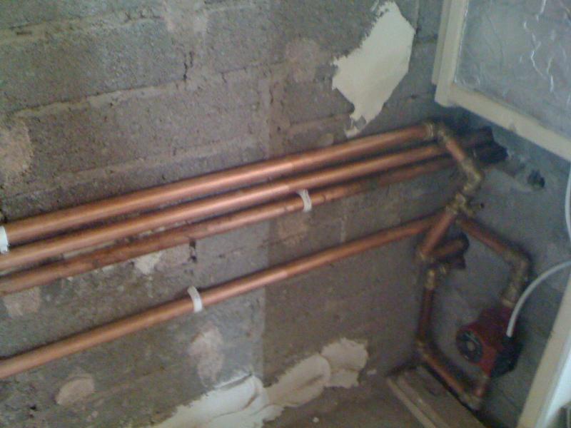

Anyone out there have trouble with a boiler stove gravity circuit?
Trying to pin down my little nagging problem - little to no heat rising up the gravity flow pipe. I've read dozens of pages on the subject - and of course no two systems are the same or reflect the same problems so I am relying on the hard facts of plumbing/engineering rules.
The stove is 14kw (9.5kw to water). The pipes are all done in 1" coming off the stove at the top left for the flow and bottom right for the return, as per the makers spec. The gravity is horizontal for 6' and then rises vertically for 6' into the ceiling joist void, where it is horizontal but rises about 5" over 8' to rise dead vertical again to the cylinder. Pipes are lagged in the ceiling. Cylinder is 240L triple coil. Gravity is to the secondary coil, Primary circuit is the pumped heating. Thermostat is on the Primary return, set to 50degC. Open vent is on the Primary. Primary circuit has an autoair vent and I bled the gravity for air also.

Without seeing a picture of your installation I would suggest that there is too much horizontal pipe to begin with.The gravity circulation stands little chance of getting started if the 1st six foot section is horizontal.That also applies to the return as well.
If you are sure there is no air trapped in the gravity side, then the problem I would be looking at would be the initial 6' horizontal run (without a rise?). Not only has this length of pipe needs to heat before the vertical run to accelerate the gravity circulation, because of the slow circulation the horizontal pipe could be building up with sludge, restricting the flow further. A flush of the system maybe in order.

If you had then I am sure they would have told you that to get gravity flow initiated the flow output from the boiler should rise upwards for at least two metres immediately above the boiler.

Is there any chance of a picture showing the Stove, connections, and initial few feet of piping leading to the risers?

I agree. It looks like an airlock, and the real answer is to re-arrange the pipe runs. If you can let it boil momentarily, that might clear it, but it is a dangerous game, so be careful. 'Horizontal' pipes on this layout should always have a gentle rise away from the boiler, with the vertical parts of the run nearest the boiler, as Agile says.
Now you have added the pics, I revise my diagnosis. Definitely the horizontals - too horizontal. Even if they had been installed with an upward slope on the flow, gravitation might have a chance.
If you can re-pipe to get that initial vertical run do, otherwise pump. :)

Changing the pipes - no can do. All finished and plastered. Now that I know, given the ratio of horizontal pipe to vertical pipe, I would have my doubts if altering the pipes where I can would drastically improve the syphon effect.
