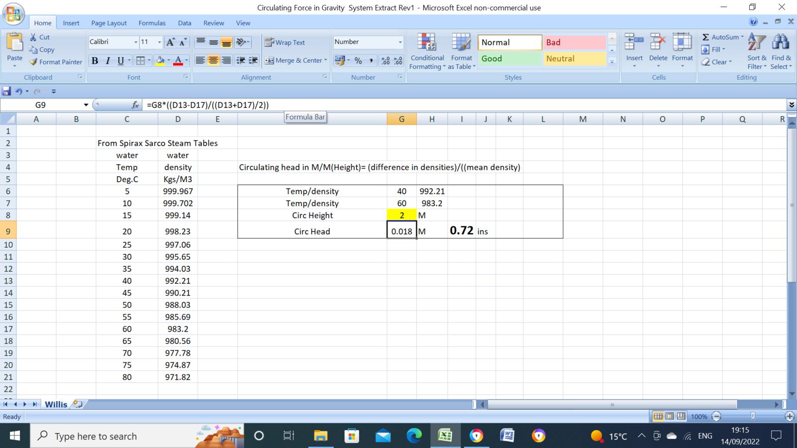

You need everything right for gravity circulation only, as can be seen below, a circulating height of 2 meters with flow/return temp of 60C/40C produces a circulating head of 0.018M, a circ pump has a easy task with a pump head 3M,
