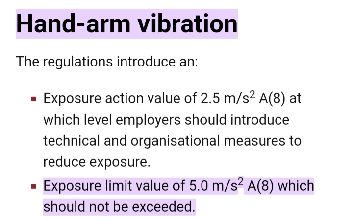

The exposure limits for hand arm vibration, when using impact drivers, can be surprisingly low...
What is HAV - Hand Arm Vibration? presumably? What does that figure mean in real terms?
I'm unsure of how it's calculated, but will look into it.
The 15.5m/s2 comes from the Makita datasheet under - Vibration Emissions (using maximum capacity of tool)
And the EAV and ELV are exposure values determined by the HSE...

Red is a warning! on anything over 82db and ( hav ) above 8 is considered high.

Good spot. You can download the list for each of their tools
Impact wrenches seen to have even higher rates of vibration, but it is worth noting that the tests seem to have been conducted using the tools to deal with the largest capacity screw/nut/etc.
If I had to use a concrete breaker for hours on end, I would be worried about white finger syndrome, driving 50mm screws into softwood for a few hours (with an impact driver) would not worry me too much. That said, If I was doing it for 8 hours a day, that would be a horse of a different colour.
