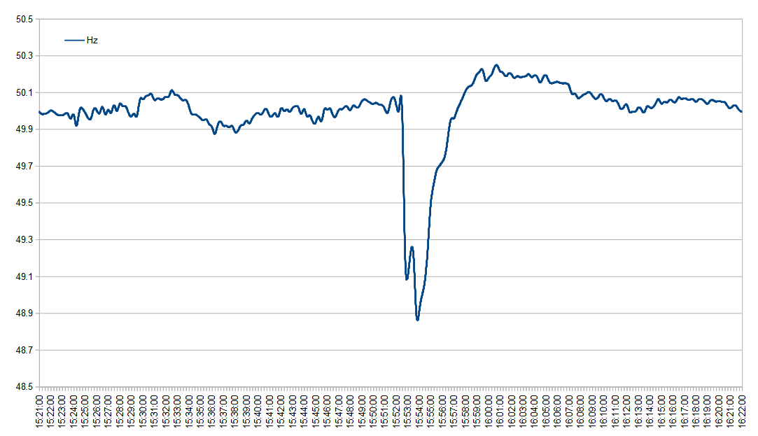

Came across this interesting analysis of the blackout. I don't recall having seen any discussion of the event in here so far ...
... Little Barford power station tripping at 16:52 when its declared maximum output ... dropped from 664MW to 0MW. ... Almost instantaneously, the Hornsea One wind farm (units 2 and 3) tripped, dropping its output from 756MW to 0MW, increasing the severity of the event.
So a loss of near 1½GW - not an insignificant loss of supply. From other news reports, it seems there was a lightning strike that caused Little Barford to trip - but it also triggered systems at Hornsea One which caused that to trip.
There then follows quite an interesting discussion of what happened next. The level of renewables (and interconnects) get a mention, specifically regarding their asynchronous nature. Big synchronous machines have a fair bit of mass spinning round and this helps support the grid over transients - but the level of that has been falling. It does say that the amount they had at the time "should" have been sufficient according to National Grid's previous statements.
A significant secondary effect is fingered as making the problem worse - significant amounts of embedded generation tripping as the frequency dropped quickly.
One other factor that may have added to the problem and explain the secondary drop in frequency is small embedded generators also tripping because of the sudden initial drop-in frequency. These changes have been an ongoing issue for several years with Ofgem continuing its work to make embedded generation more resilient to changing frequency events with a modification[1] being approved at the start of August. This will make embedded generation units below 5MW more resilient to Rate of Change of Frequency (RoCoF) events in the future.
I know we've had one or two discussions in here about how inverters detect loss of grid. It would appear that many of them interpreted the rapid drop in frequency as loss of grid and tripped out. It seems that this has been the subject of some work already and they are already widening the tolerances. That's fine for new kit, but I can't help thinking that few installations will get software upgrades - and given that FITs have beens scrapped for new solar PV, I think that future installs (with the relaxed tolerances) will take some time to become dominant.

I know we've had one or two discussions in here about how inverters detect loss of grid. It would appear that many of them interpreted the rapid drop in frequency as loss of grid and tripped out. ...
Have you seen any information about the magnitude of the drop in frequency?
As you probably realise, what I'm thinking is that it may make more sense for the inverters to simply sense frequency, rather than rate of change thereof - since, even for very small changes in frequency, the rate of change could be very high in the event of the sudden loss of generation (or load), such as recently happened.
Kind Regards, John
Data available here: https://bmreports.com/bmrs/?q=demand/rollingsystemfreq/historic

It's interesting to see the secondary event on the frequency graph. It looks a lot like the embedded generation was tripping as the frequency recovered. So the inverters stayed online as the frequency fell, then tripped as it was coming back up.
It's got me thinking about how complex the grid must be to manage these days. I assume at any onevtime there'll be a lead generator (something agile such as a gas turbine) tasked with following frequency/voltage changes and reacting accordingly. But then you've got all these other systems configured to do stuff (usually switch off) when "some condition" happens. Perhaps one day we'll have a really big event where stuff is happening faster than the control room can react.
Though I doubt we've enough automatic load shedding yet to get into a "generator trip, load shed, generator trip, load shed, ..." cascade.
