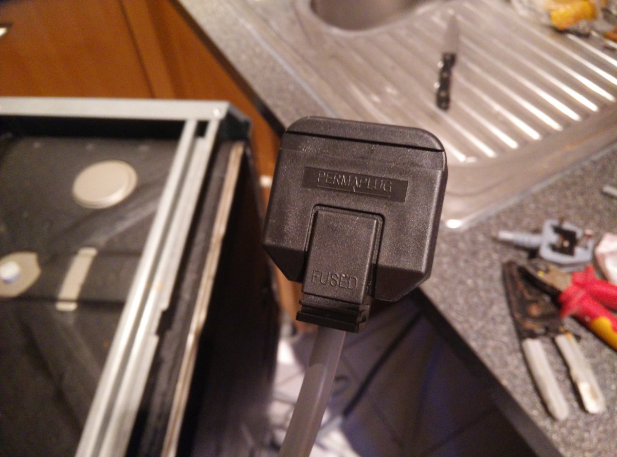

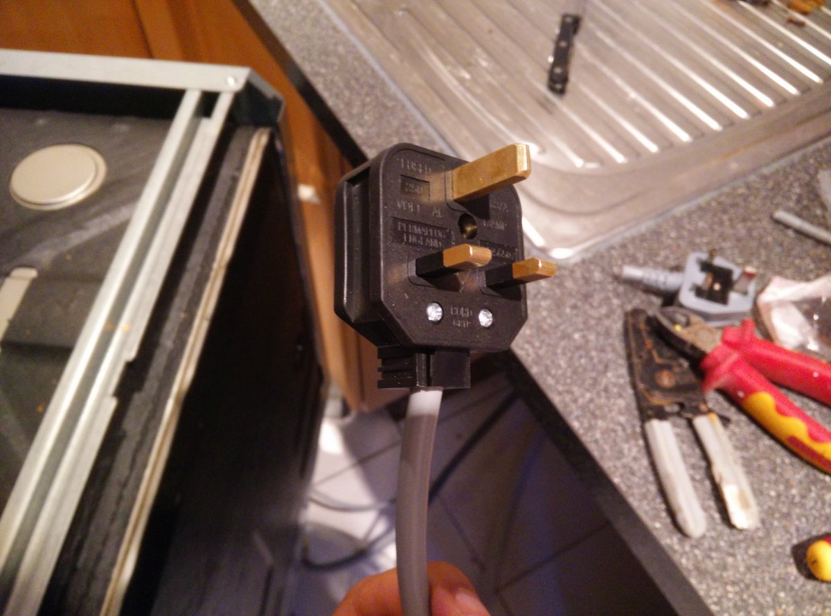

The plug of a dishwasher starts to melt !

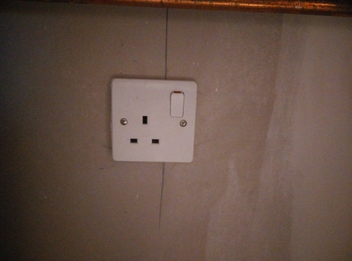

1) Yes, get a qualified engineer to change the socket and check the cable inside the wall at the same time.

However, I still don't know what is the reason why the plug and the socket were burned and how to avoid such things happen again?
Probably just that the socket is old and was making a poor contact with the plug pins. The closeness of the dishwasher wouldn't have helped though.

Is there a fused isolating switch for the dishwasher above the worktop? If so, you can dispense with the plug and socket all together and fit a flex outlet plate.
That would give you more space behind the appliance too….
http://www.screwfix.com/p/mk-logic-plus-1-gang-20a-flex-outlet-plate-white/70006
Yes there is, however, doesnt this mean the dishwasher will be difficult to get out in the future as it will be permanently attached to the wall effectively? Does it require an electrician to remove each time?
The flex is long enough to pull it forward for maintenance. It will need disconnecting if you ever need to take it all of the way out, but my dishwasher has not moved for the last seven years and it would only need disconnecting if/when it needs replacing.

All changed - thanks all, hopefully no more burnouts for a while

For safety make the old plug un-usable by twisting the pins so it cannot be plugged in. If plugged in then the exposed wires in the cut end of the cable will become live.
