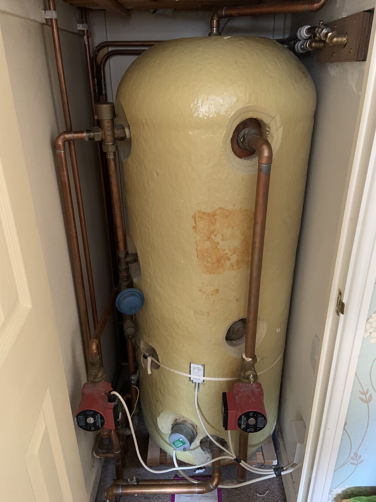

currently using just over 30,000Kwh of gas a year for hot water and central heating in a detached 4 bed that is well insulated and a 1990 build. Need to reduce usage if possible as seems a bit excessive.(cooking is electric)
The gas boiler feeds a vented thermal store tank in upstairs airing cupboard. The hot water is mains pressure so comes from a coil in the tank. The CH also is piped off the tank with another pump for circulation so both HW and CH come from the same tank.
Problem is if someone has a long shower when heating is on the heat is depleted from the tank, you end up with cold radiators whilst the boiler tries to regenerate the thermal store and heat the house at same time. It’s only going to get worse as the three kids grow up.
It seems a bit crap to me. Should I put a larger thermal store in for the mains hot water and have the boiler directly heating rads with a Y plan system?
Its a IMI flow 30 cylinder 180 litres and boiler is a potterton profile looks to be original from 1990.
Also there is a wall switch downstairs that turns on the immersion heater in the cylinder . Electric meter is economy 7 so would the switch be just for overnight heating of the tank?
Any opinions welcome!
cheers
