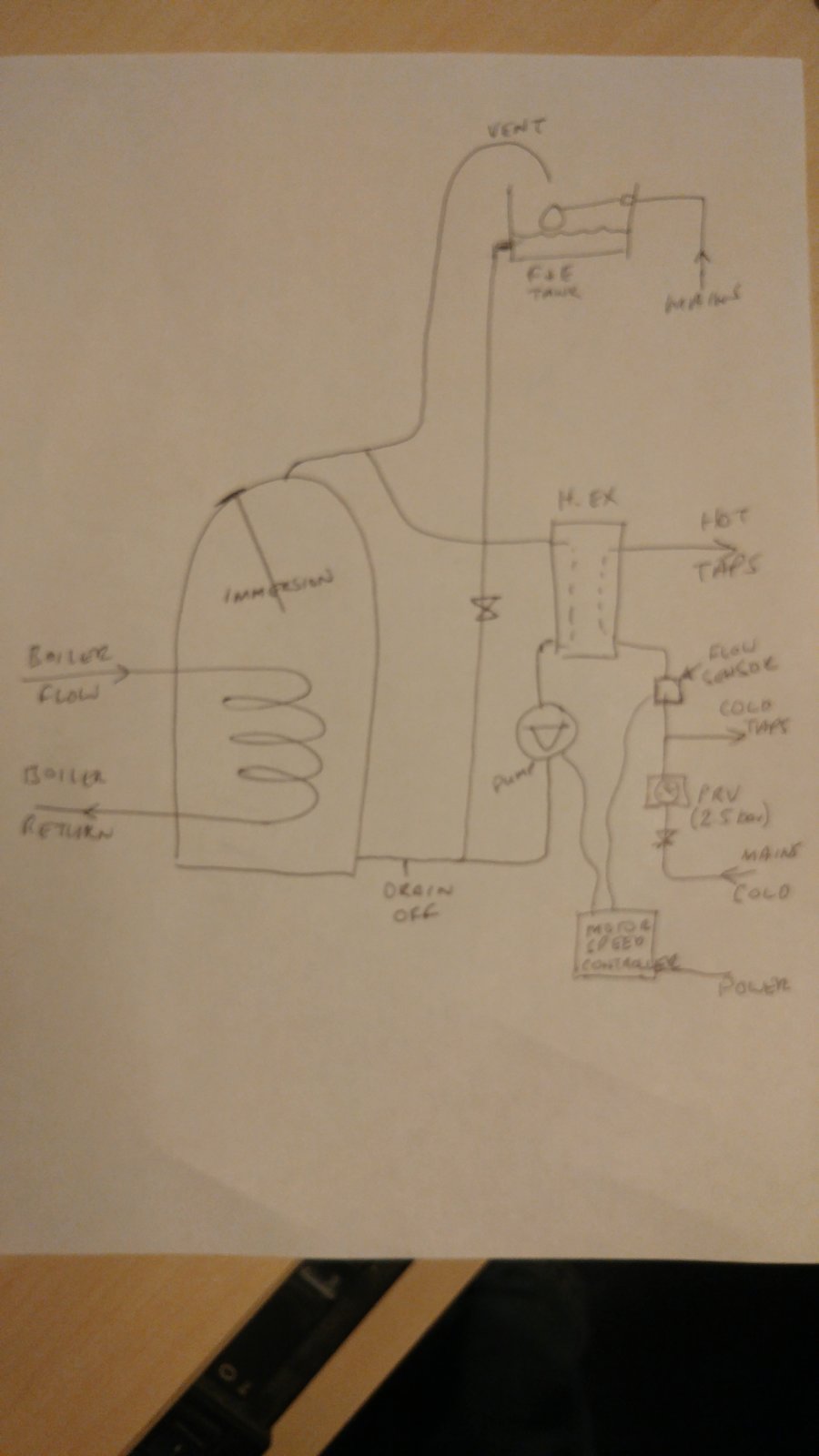

OK. Does anyone have a complete schematic diagram for that kind of arrangement?
I'll scribble something down after I've had my tea.
This is essentially what I have. 160kW h.ex, 4 gall F&E tank, 120l cylinder set to 65 deg C. Enough for 2 consecutive showers. Some improvements could be made.
Fantastic. Thanks. How about pipe diameters if you don't mind?

Everything except for pipes carrying mains pressure is 22mm. 15mm the rest, but then I only have a 1/2" rising main.
Cellar considerations: Note that the F&E tank has an overflow warning pipe (not shown) that goes outside. But then the tank and cylinder could be filled from a hose, and forget the float valve. The practicalities of draining would need to be thought through.
Some pros on here might want to comment.
160kw based on what?
No idea - probably some very unlikely temperature differences. I looked at the rating of the ones Gledhill use on their kit and went a bit bigger.
No way it'll be anywhere near that figure in practice.

That Pandora is very similar in principle to the diagram I drew.
There are no discharge pipes because the hot water is not stored under pressure. Contrast with an unvented cylinder where the discharge pipe is an essential safely feature to prevent dangerous pressure in the cylinder in the event of a failure of the other heat-limiting controls.

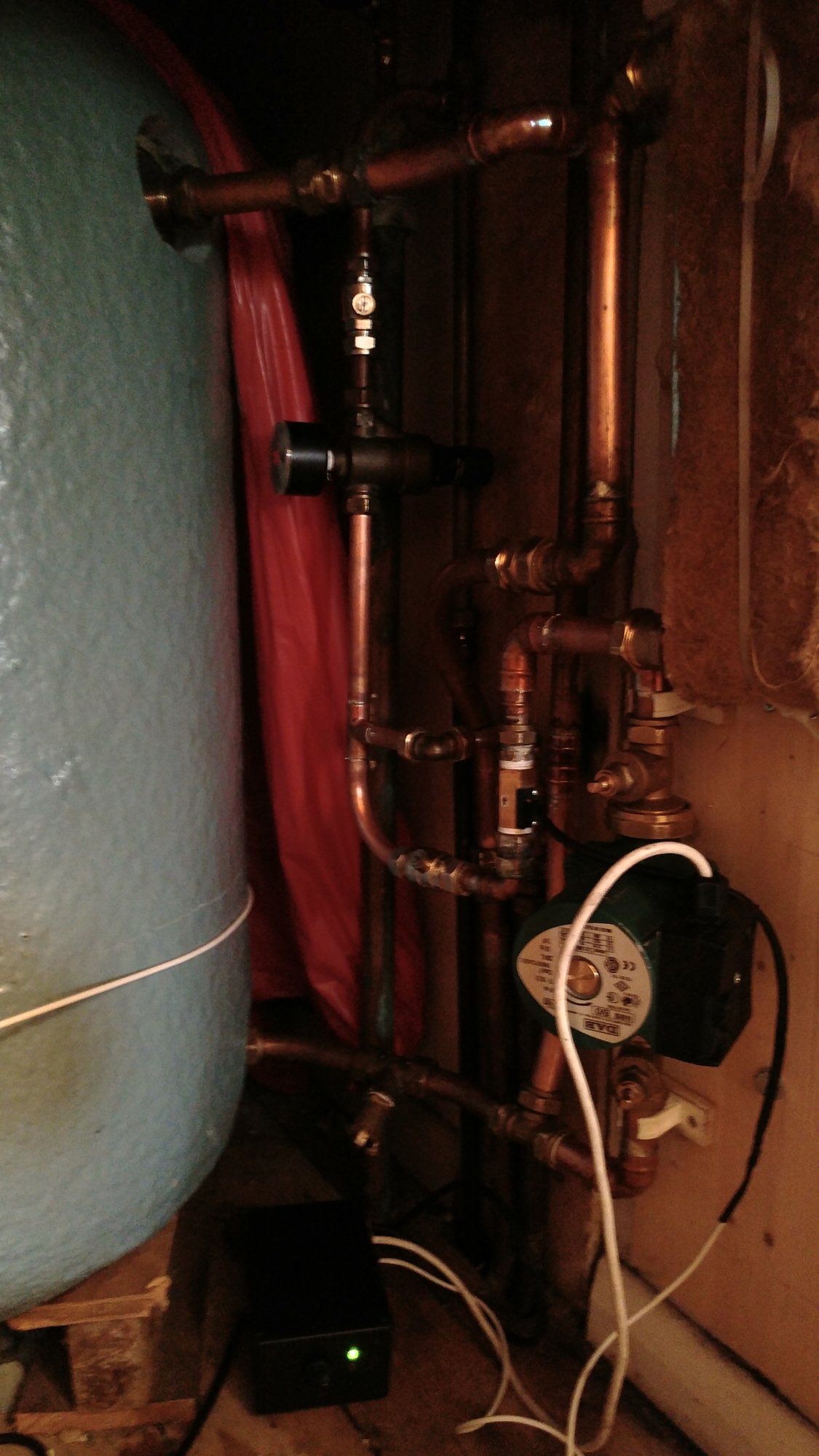

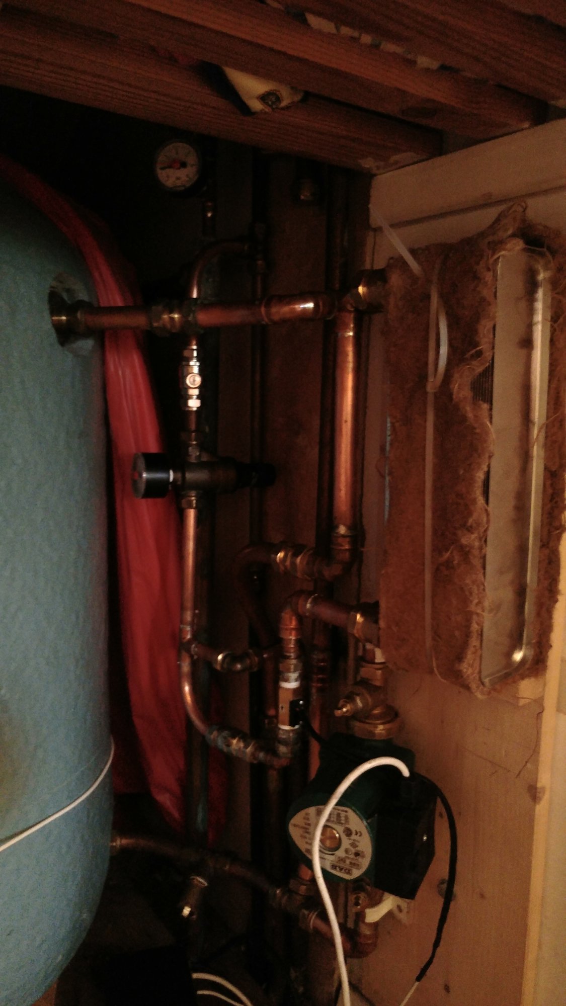

Do you have any pictures of your heat exchanger and plumbing?
You could have used a bronze pump and let the gravity supply some of the outlets. Kitchen sink, bath.
Then in a breakdown situation you still have hot water.
