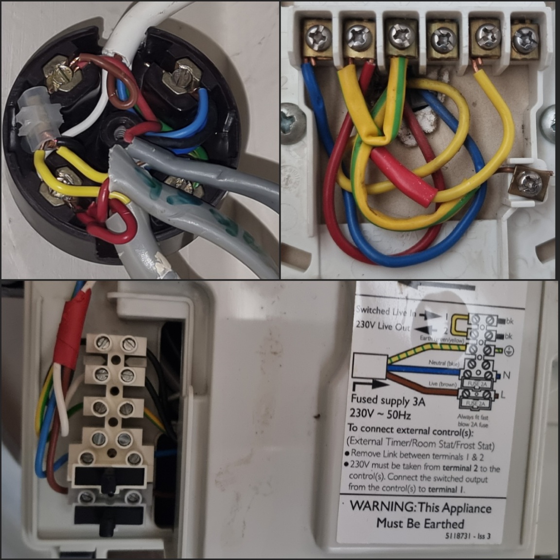

Would some pictures be helpful?
There are two Hives, linking 1 to 3 on single channel, or L to 4 on twin channel should make the boiler run. And wiring a standard lamp to L and N will show if there is power to the thermostat.
But the problem as always is, was it wired correctly to start with? We had bi-metal thermostats for years which did not need power to make them work, so it was all too common to only run two wires to the thermostat, on upgrading some way needed to be found to power them, and I have seen all sorts of fixes, including using the earth wire as a live.

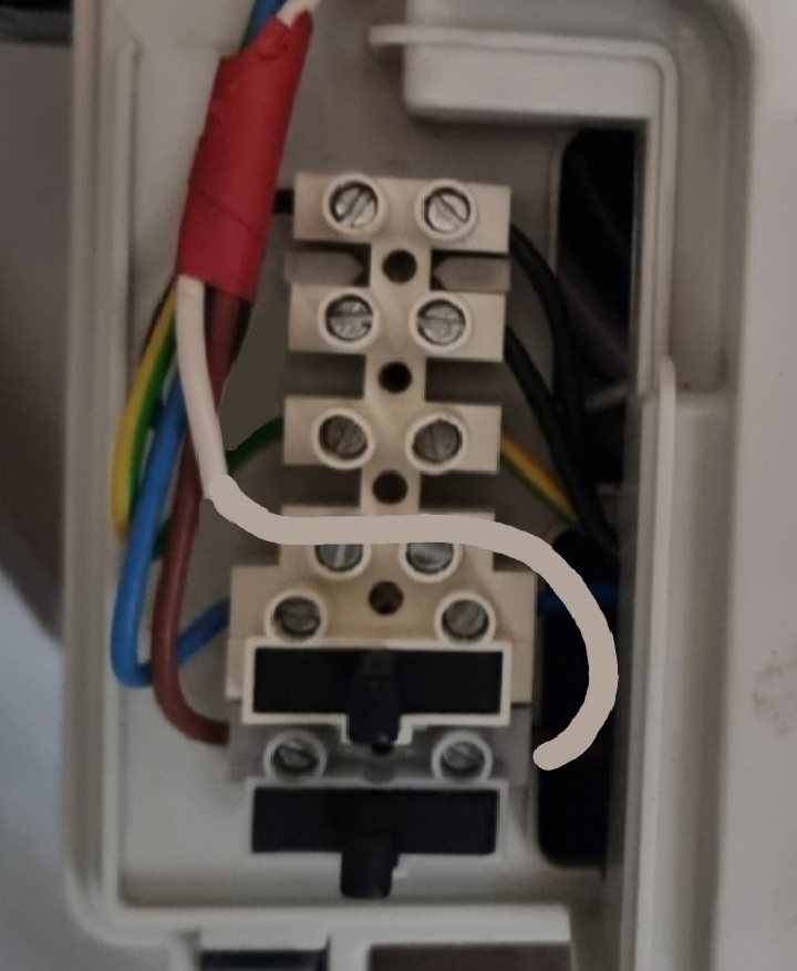

So I've had a chance to do some testing. On the boiler, the live (behind the fuse) is indeed live so all is well there. The boiler is running any way. On the junction box, the brown wire is also live. The white wire out the back runs to the boiler. Finally, on the face plate for the receiver there are no live wires, so none of that works. Any thoughts?
Hi I think the supply to face plate is feed from terminal 2 off boiler is there power there also why would someone use earth wire and sleeve to link live and common.
As mentioned by @garygooner, the power for the stat is currently supplied by the white wire from terminal 2 of the boiler.
Is there 230V on the white wire?
Also (possibly unconsequentially), there appears to be an additional cable connected to the control side of the junction box - this was often the case when a timer and thermostat were mounted separately.

Clearly there's something bad going on with the boiler. The voltage detector is showing no reading from the white wire (terminal two on the connector box in the boiler) that then feeds up to the face plate (becomes the red wire there) So it's a boiler hang up - Potterton Combi Pro Plus HE 28 A if anyone's got experience with those. About to replace it any way with a W Greenstar 4000

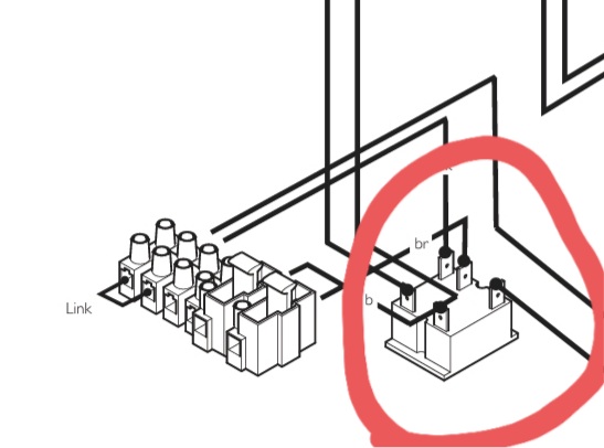

There are only two components between the brown incoming live of the boiler and the white wire - the fuse (presumably ok, as the boiler is on), and the selector switch...
So my money is on a faulty selector switch.
A replacement is even available from Screwfix...
However, for an easy workaround, we could try moving the white wire...

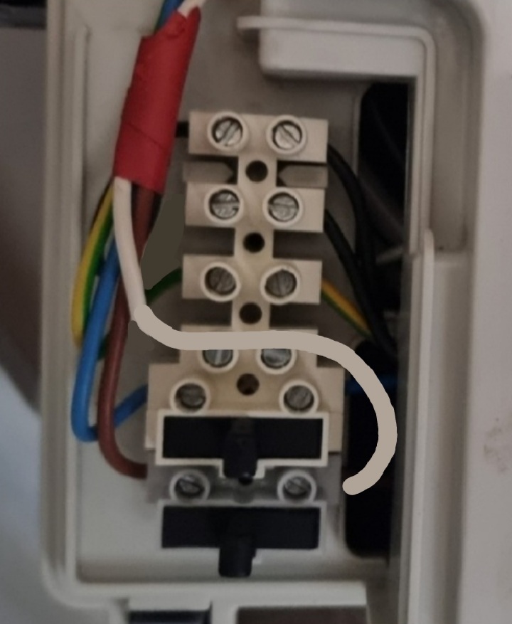

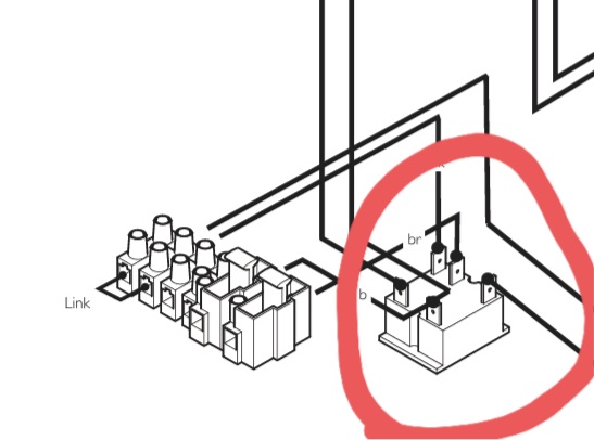

Or the switch is in HW only mode
