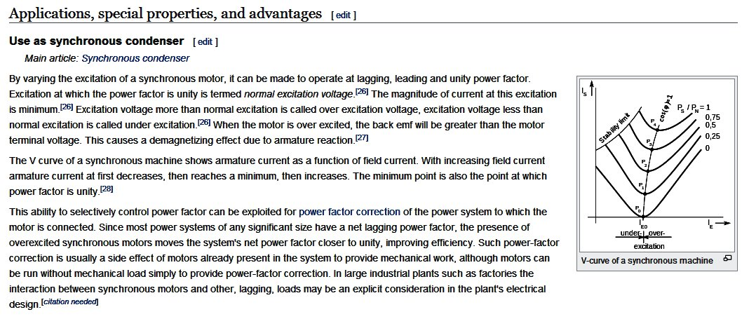

I have not yet got my head around this, but ( from here ) .....

It says it can have a leading PF, and can be used with "ordinary" motors to improve overall PF.
Yes, I'm now reading that all over the place, so I suppose it must be true !!
I've never had reason to think in any depth about, or to understand about, motors, but there is clearly some learning for me to do here!
However, even if I forget that it's a motor and just consider it as a 'black box' with two terminals to which I apply an AC voltage, I still have a problem. The one thing I didn't mention before is that the DC resistance of the motor I was testing was exactly 2.0kΩ. If that were purely resistive, with ~240V AC applied to it, that should result in a current of ~120mA, but what I actually get is a current of ~30mA, which equates to an impedance within my 'black box' of around 8kΩ. However, I am also seeing a PF of around 1.0, which implies a net reactance of zero (i.e. current and voltage in-phase) - so where is 'missing' 6kΩ of impedance within my black box coming from?
