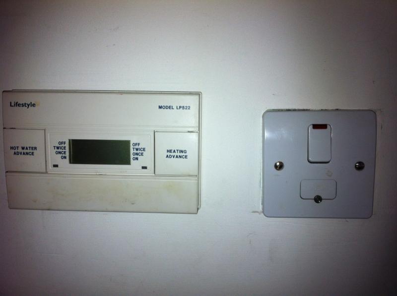

The programmer is a Drayton Lifestyle LP522 Si Programmer Service Interval Model.
The thermostat is a Drayton RTSI Room Thermostat.

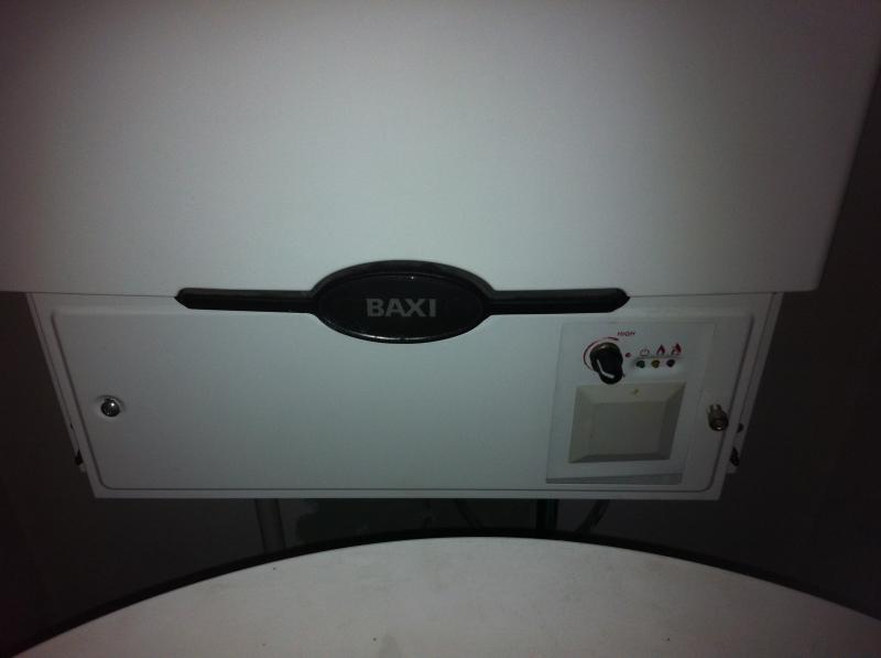

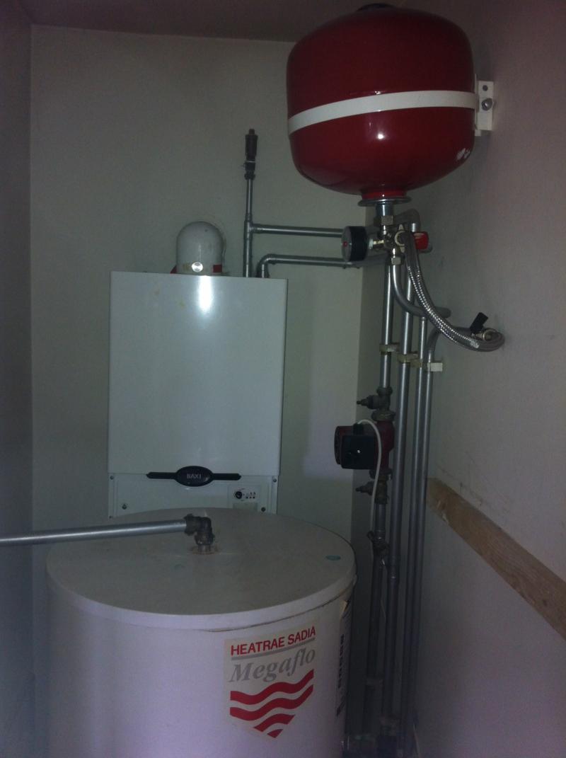

I can tell you the make of the boiler is Baxi although I cannot find the model as access is poor as you can see from the photos!
Your is a Baxi 100 HE :)
I can't see how will an engineer be able to remove boiler casing for servicing with that cylinder in the way.... :confused:

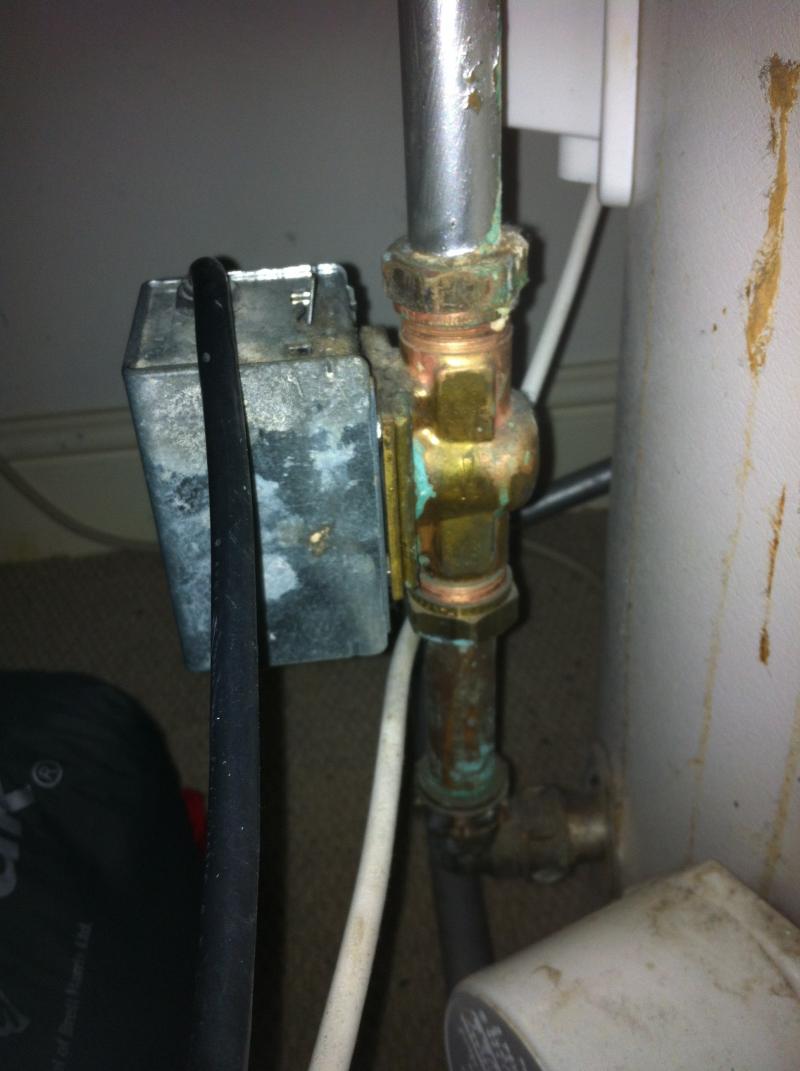

I can see one of them. It's the silver box with a black lead at the bottom of the cylinder at the front. (The thing next door with a white lead is the electric immersion - just for emergencies.)

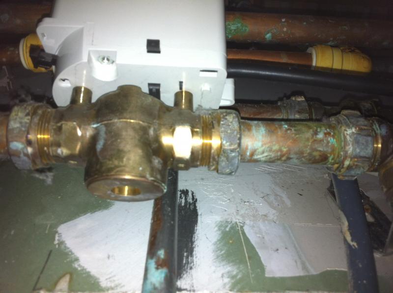

I have managed to locate the second motorised valve and have attached photos of this one.
The first two are of the second valve (which I located on the right hand side of the cylinder).
The last photo is a close up of the one at the front of the cylinder.

The white valve is the valve you need to check as this is serving the central heating. It is a Drayton/lifestyle valve and they are not the best in terms of reliability. Remove the head with the black release tab on the side and check if you can turn the spindle easily with your fingers. If the spindle is free then i suspect a dodgy actuator head. If you have a multimeter it is easy to test these. If not call an engineer ;)

The central heating is controlled by the white valve at the side of the cylinder.

The second sentence in no 2 may appear to be what is happening, but it won't be that. It is usually caused by the switch inside the CH valve sticking closed. The valve may also stick open, so the water can circulate round the rads.
The problem is that if this was happening the thermostat would not keep the place at a cosy temperature. It would get very hot.
As TCCH suggested, you need to remove the head and check if the spindle can turn easily by hand (it will be less than a 1/4 turn). If it sticks, apply a little silicon lubricant (NOT WD40). If not sticking, come back for more advice.
