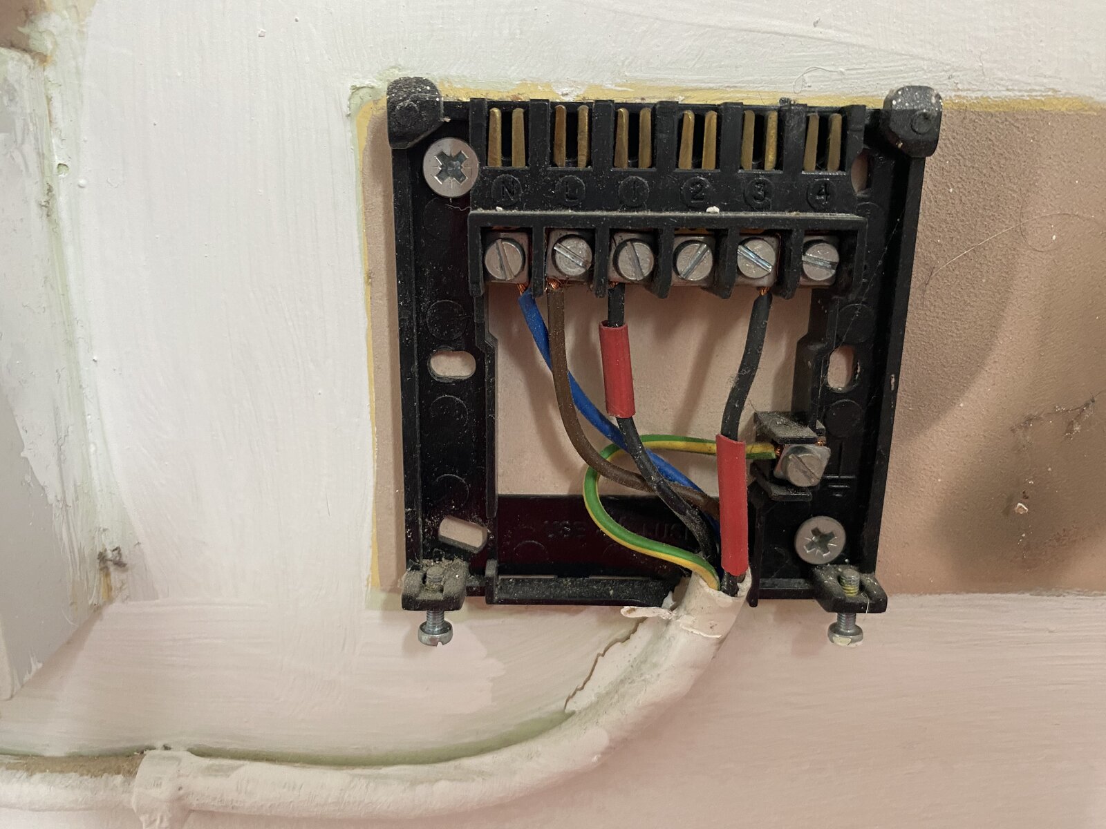

Hi All,
Could someone help me wire up my new smart thermostat?
I’ve successfully removed the old wired thermostat and connect to internet etc.
Just need help working the wireless receiver on my combi boiler.
Photos of the stage I’m at currently.

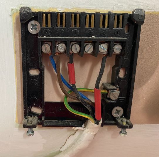

Photos of how the old setup was.

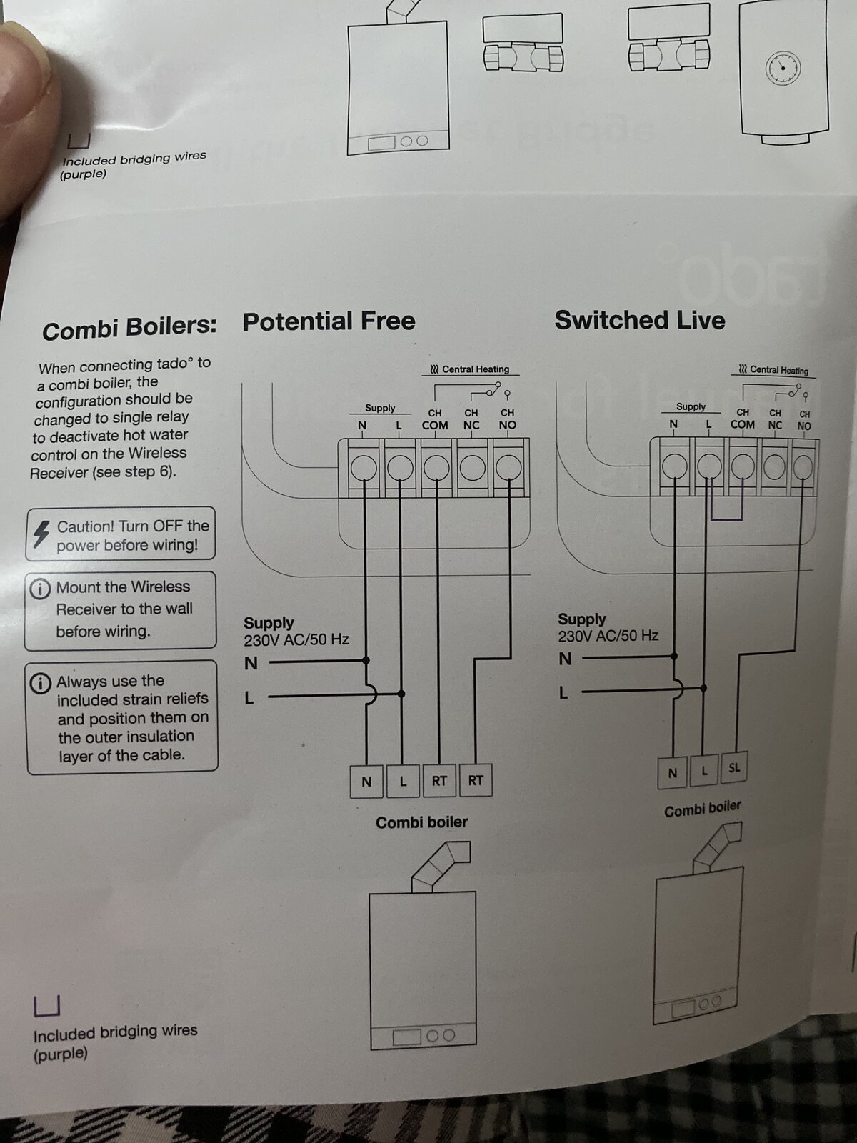

That won’t work as you’ve wired it incorrectly. Are you using the same wiring as this?
At the moment you appear to have connected the live and the neutral to the controller switch. God job it isn't working otherwise BANG!
You also appear to have connected the heating control wires (black wires with red sleeves from the picture below) in the to the N & L terminals. Which fortunately has prevented it the controller operating and producing the aforesaid 'bang'.
So to change this:
To the new controller:
The blue wire in N....goes to the new controller N
The brown wire in L....goes to the new controller L
The black wire with red sleeve in 1....goes to the new controller Central heating COM
The black wire with red sleeve in 3....goes to the new controller Central heating NO
I assume you have a combi boiler and no attached hot water cylinder. If so, the above is all you need to do. No need to change anything else. If you had a separate room thermostat and programmer, the one that is still insitu should be set to be permanently on. If you had a programmable thermostat that had both time and temperature control you can ignore this.
As per @CBW, No idea what the other wires do now you have disconnected them. But they should probably go back as they were.

The photo above with the black casing held a manual ticking timer box which I removed to show the proposed wiring.

So if I reset EVERYTHING to how it was before I touched anything and then make the changes to the new controller as you say above would that do the trick?
This type of backplate is associated with both thermostats and programmers. If the thermostat (or thermostat receiver) was on the front of this, then yes, that's all you need to change.
However, If the thermostat was wired in elsewhere, what product was on this backplate, and what happened to the old thermostat.

This was on the backplate. I still have everything that was removed.

OK, then the new controller can replace the timer backplate as earlier.
The old room thermostat can be left in place and set to maximum to stop it interfering with the new controls, which is the easiest way for a novice. Or, if the old thermostat is removed, its live switching wires need to be linked together to complete the circuit, otherwise the wiring will remain 'open circuit' and the heating won't work.
