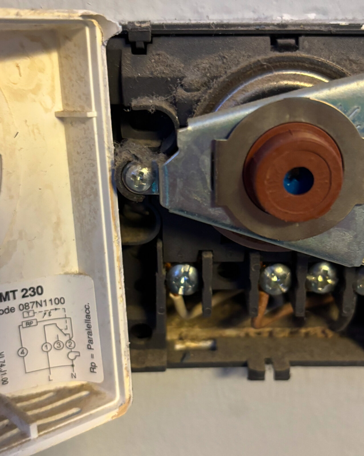

Can anyone help me understand how to change my RMT230 thermostat to a digital one I have bought? (Moes 009 series Gov thermostat)
It’s for my combi boiler

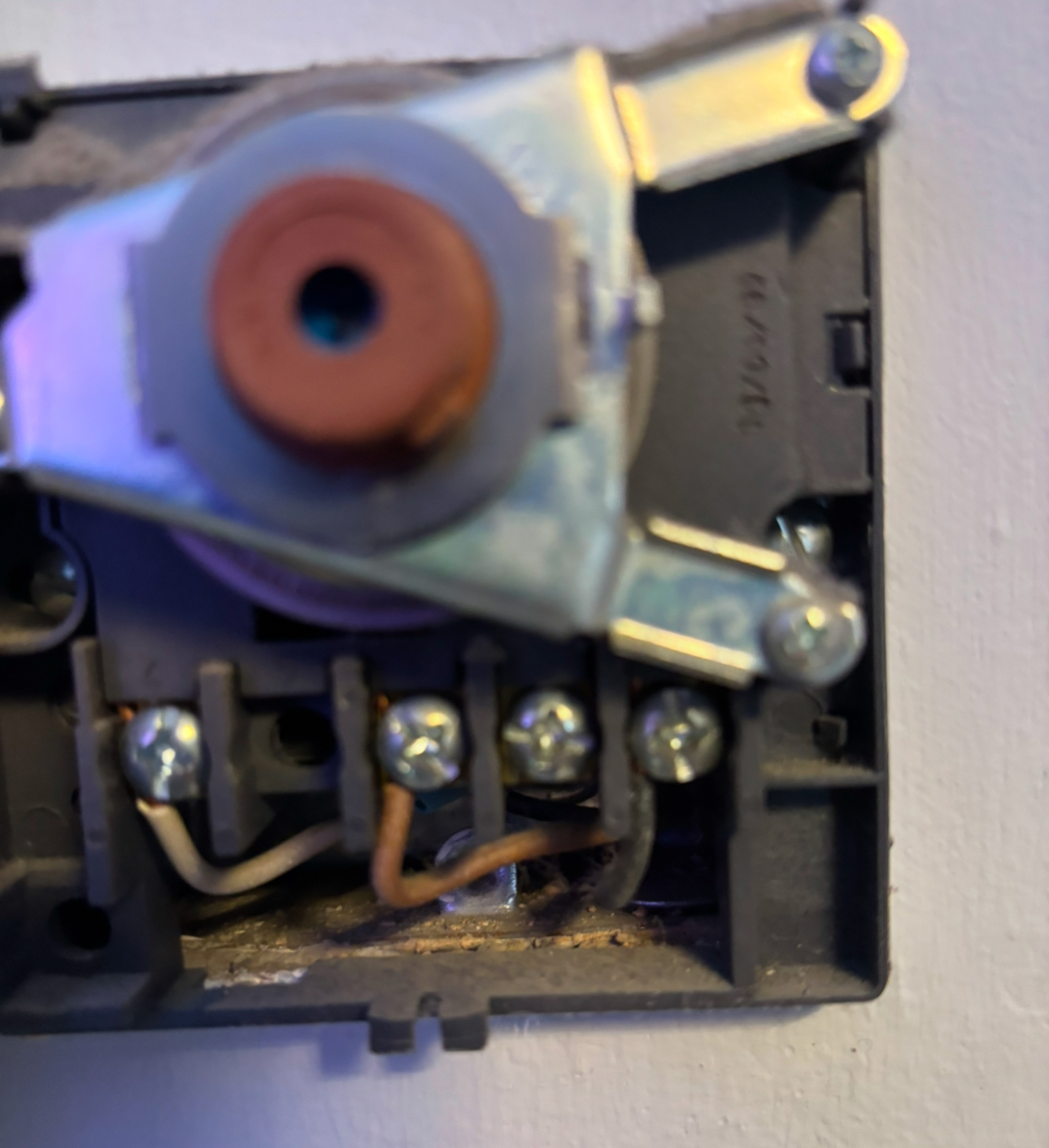

3 wires at in my RMT one (240v)
White=4
Brown =1
Black =3
Just not sure where they going the new thermostat
Picks below
Old thermostat and new one
Thanks so much in advance

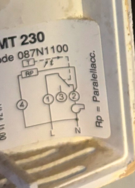

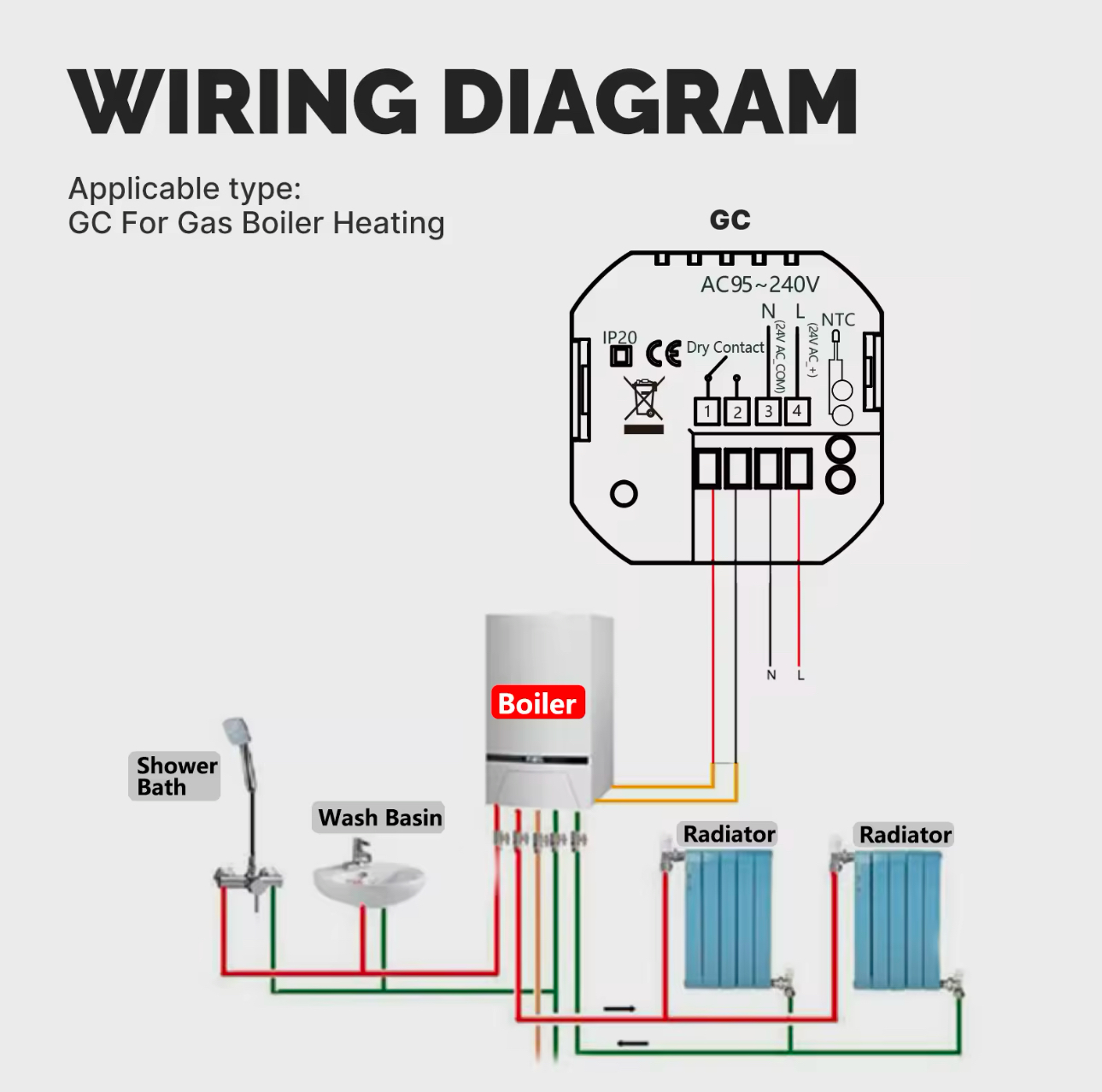

This shows 4 is neutral 1 is line in and 2 is line out to boiler
So wire from 4 goes to 3 on new.
wire from 2 goes to 2 on new.
wire from 1 goes to both 1 and 4 on new, you will need a link wire.
Note old thermostat would work with no neutral, the new one needs a neutral, so I would start with a meter between 4 and 1 and see if you get 230 volt, just in case neutral not connected other end.
New thermostat requires a permanent live and permanent neutral, so possible to use above, but might also not.
Need thermostat requires a permanent live and permanent neutral, so possible to use above, but might also not.

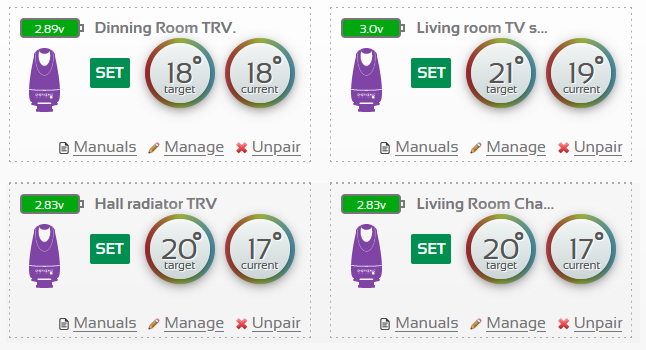

The system needs balancing, and the wall thermostat set to match the TRV, with a TRV which shows 4 TRVs-1.jpg target and current, one can slowly over time get them set spot on, but a TRV which shows *123456 can be used after the lock shield valve is set, but until that has been done, to set two parameters is very hard, as you simply don't know which to alter.

Your directions worked - I had already checked and a neutral was in place
