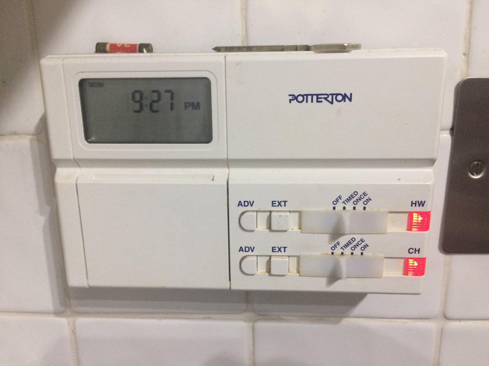

This is the controller for the boiler.

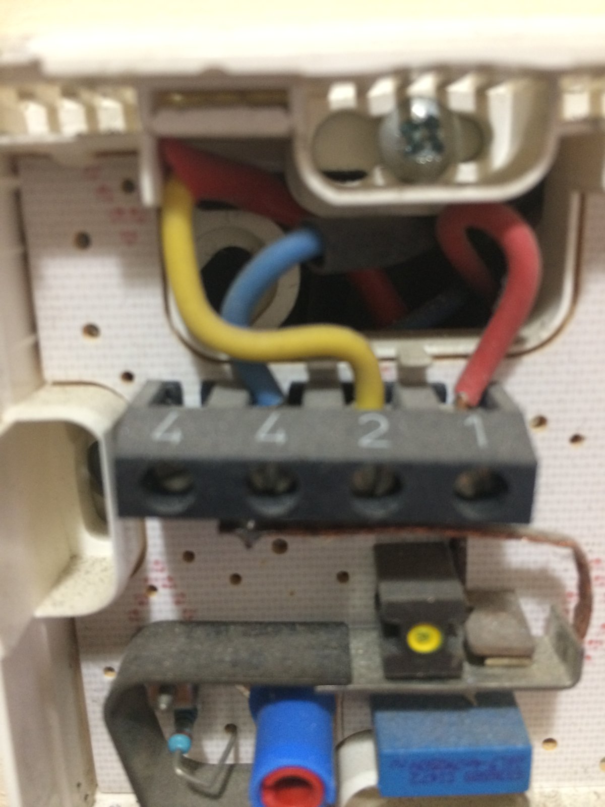

So could I use the battery one I mentioned above or a 240V one? How does my current thermostat work, does it just link like a switch something in the boiler or does it feed back 240V to the boiler?

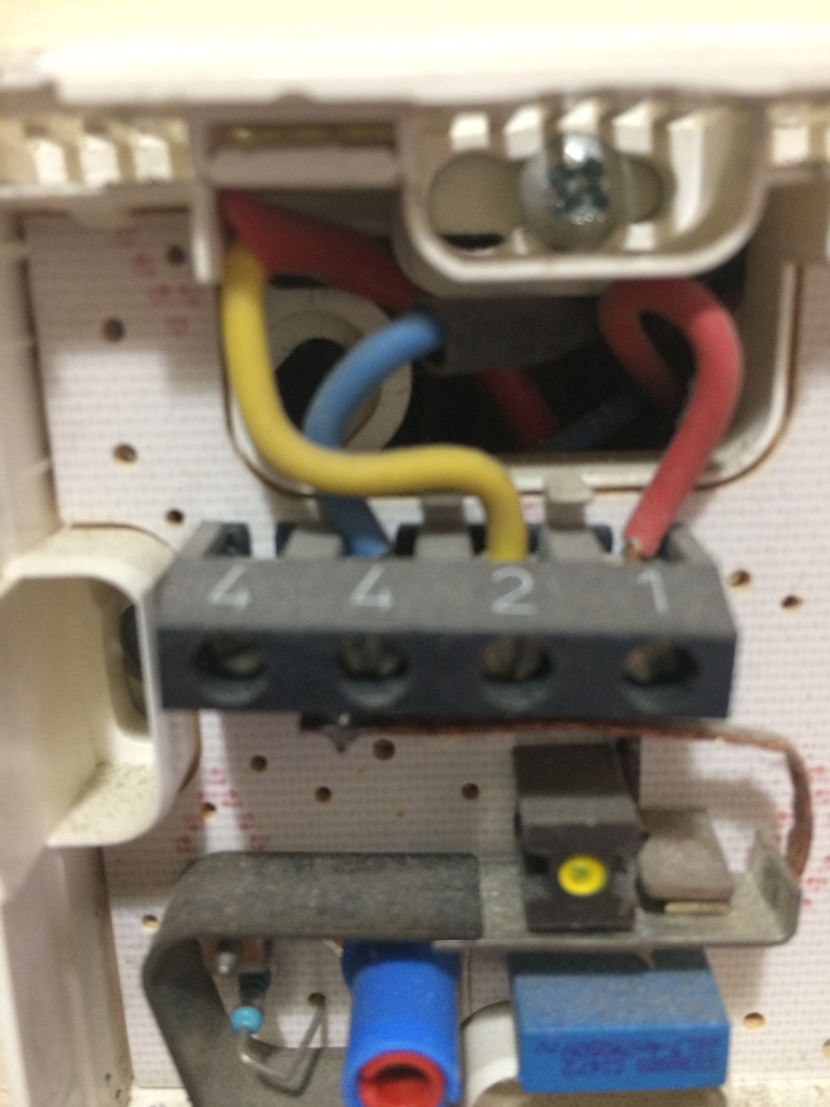

So, this is what I’ve got in the existing thermostat. Doesn’t that make it a 240V? If I were to use a battery operated thermostat, I’d just use two wires? Which ones? Would this do the job?
https://www.amazon.co.uk/dip/B074M8RV45/ref=cm_sw_r_sms_c_api_Si62zb8SYHSD9
Yes it's 230V
1 Red is the live from the existing timeswitch [to be a permanent live if you set the programmer to 'heating permanently on']
2 Yellow is the switched live to control the heating
4 Blue is the neutral
If you use a battery operated programmable thermostat with a potential free switch then 1 & 2 are the wires that would go to the contacts. You don't need the neutral it can be isolated and tucked out of the way.
If you do go for a programmable thermostat and leave the existing timeswitch so that the heating is permanently on, then you have a permanent 230v mains supply at the thermostat which would allow you to use a mains powered thermostat instead of a battery powered one. The red and blue wires providing the 230v supply

I think our last posts crossed in the ether. But I think I have answered it. If you go for a programmable stat You can use a 230v stat or one that is battery operated and has voltage free contacts.

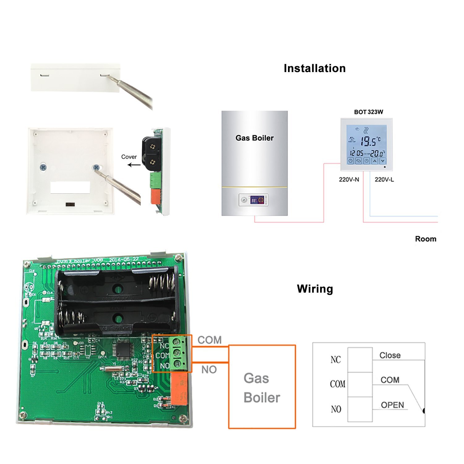

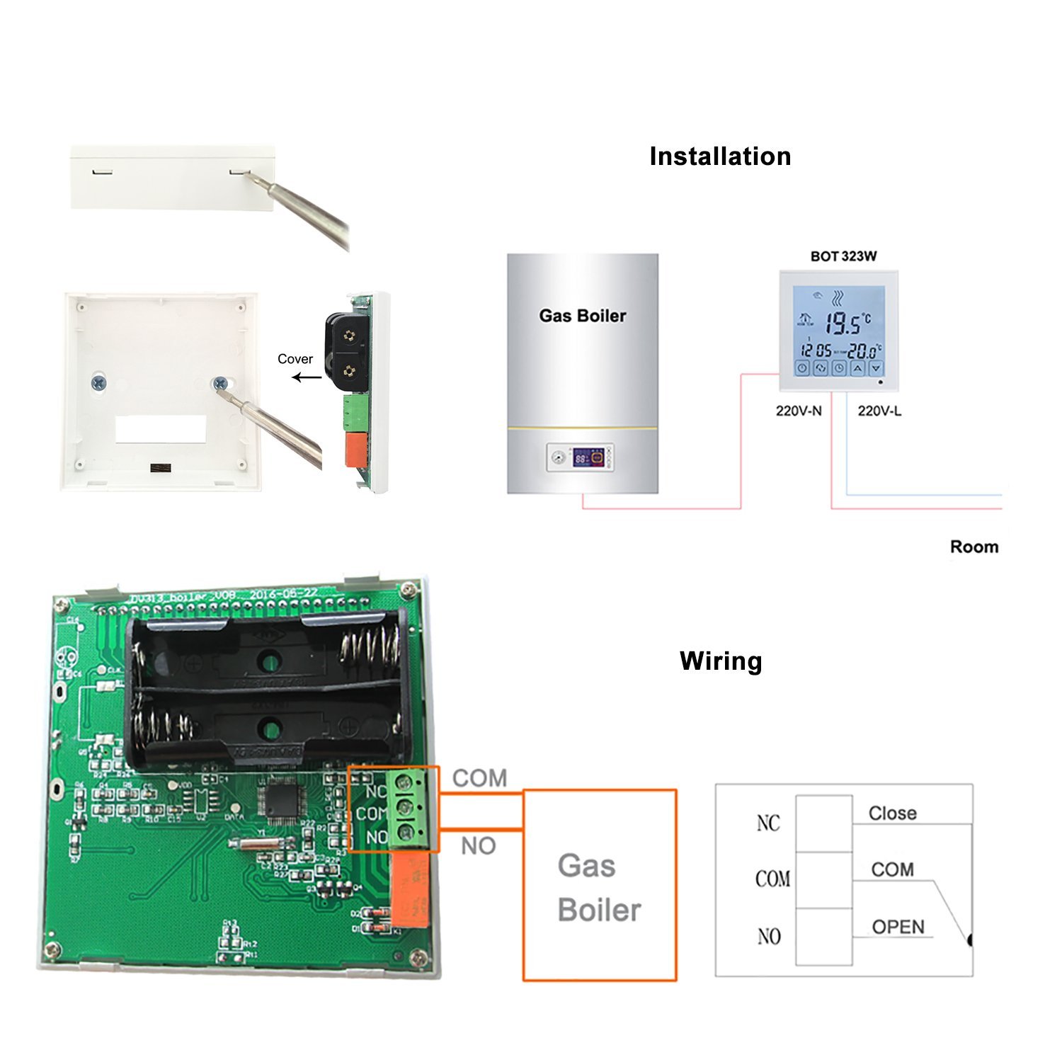

So I ordered this https://www.amazon.co.uk/dp/B074M8RV45/ref=cm_sw_r_sms_c_api_Si62zb8SYHSD9?tag=diynotcom-21 and it arrived today. So, now the wiring;
Blue - leave disconnected and isolate it
Red - COM
Yellow - NO (normally open)
Is that correct?

Ah well that depends what the other ends are connected to, which would have been up to the personal preferences of the original installer. Normally (about 95% of them) are wired as below, in which case what you say is correct. But you do find the odd rogue installation.
1. Red - live supply
2. Yellow - Switched live that controls the heating
3. Blue - Neutral
There are two ways to check for certain. One is to test them with a multimeter, and the other is to identify what they do from the terminals they connect to at the existing Potterton thermostat. Unfortunately I don't have the diagram or instructions for it to know for certain what 1 ,2 & 4 correspond to. Is there a wiring diagram in the lid?
