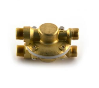

You'll still have the same issue if using unbalanced supplies, the cold would always overwhelm the hot until they can be better equalised.
If you have access to the hot and cold pipes before the shower one of these,
https://www.bes.co.uk/water-pressure-equalising-valve-16711/
Ah interesting. Yes I have plenty of access to the hot and cold pipes at the moment (pre boxing in). Do these work well then?
I've got to decide what's worse, going to the effort of routing a cold feed from the tank, or spending £25. Hmm.
If you can, the tank option is your best bet, these work but it is another restriction on your pipework you could do without if you don't have
a lot of head.
