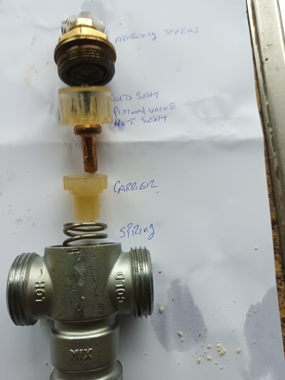

what part is actually doing the temp sensing in the shower valve?

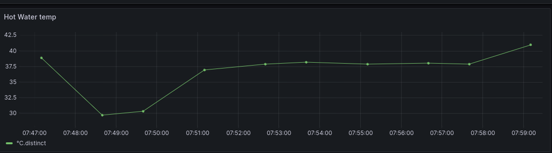

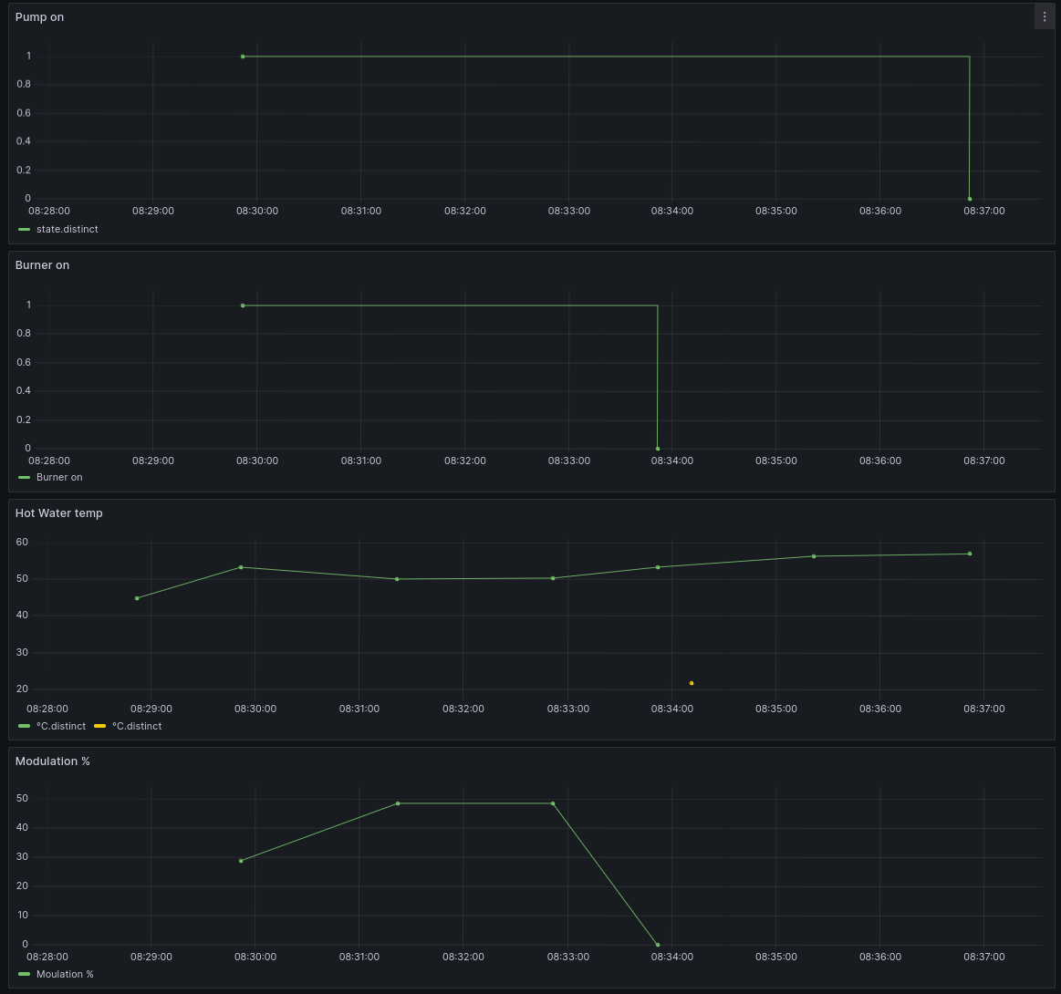

burner turned on 07:47:10 as did pump burner turned of 7:59:10 pump 08:01:40

Photo below of a TMV, they all work in a similar fashion , the piston valve contais the sensing (copper) element (senses the mixed flow temperature) inside in which is a liquid that pushes a little hydraulic piston inside in it and moves the piston valve against the spring pressure to give the correct mixing, that temperature adjusting screw in the top is effectively adjusted in a shower by the temperature control. (or something like that)

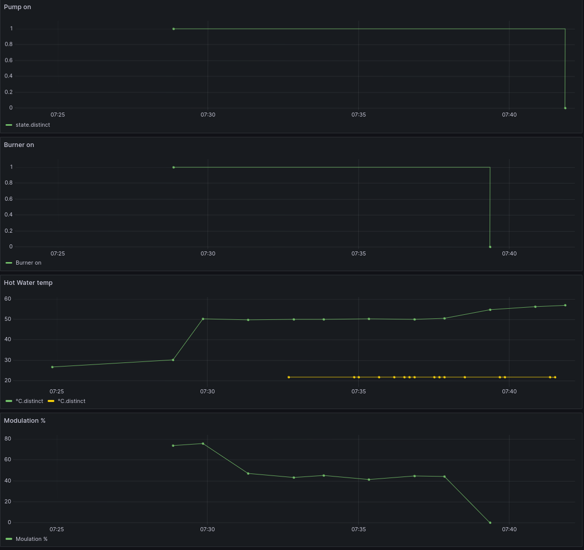

Was the shower still running when the DHW temp rose from ~ 37C to 40C in one minute, 07:58 to 07:59 hrs?.
no that was it heating up after shower shut off but burner was still running and pump

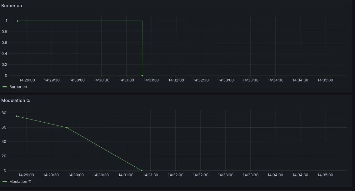

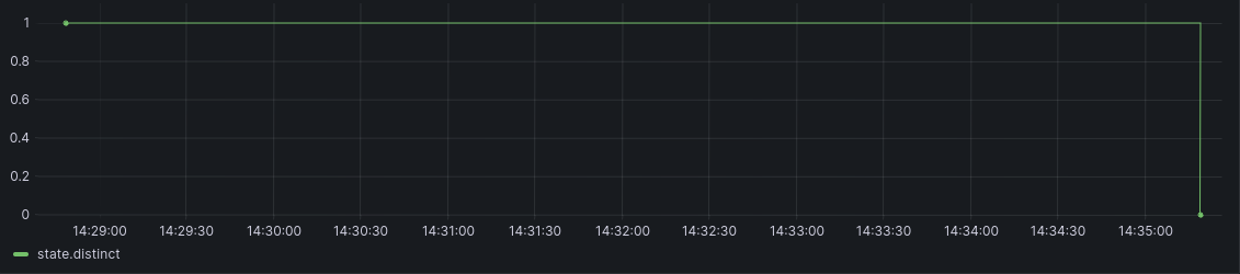

this was when i set it to 50c oops last one is pump on also ignore the yellow temp thats not actually connected to the pipe yet

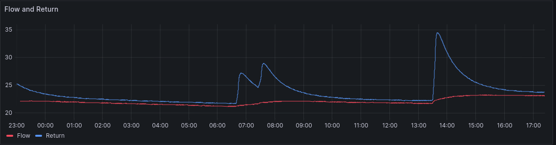

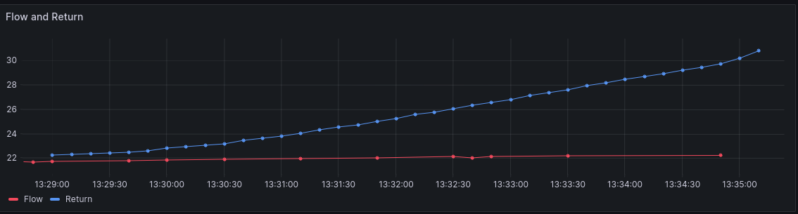

Can you read the boiler's primary flow and return temperatures when DHW only on, like for the shower, at 50C DHW temperature?
ask and ye shall get
just that period and day so far
for ch flow and return temps
I dont think the flow and return temperature readings are actually read (properly) while on DHW only as the primary water is diverted to the plate heat exchanger so probably no flow(s) at the probes under these conditions. if the DHW temp was set to 50C, then the DHW flow as calculated in post #4 will be 9.4LPM (to give a shower flow 15LPM at 38C), we don't know what the boiler primary flowrate is but if 15LPM is assumed then the dT flow/return will be 20C, again if we assume the boiler primary flow temp at 75C then the return will have to be 55C.

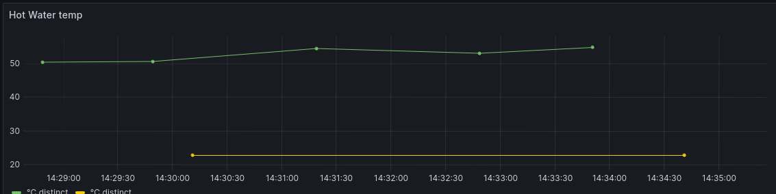

update today much much better! except the wife took a 10 minute shower ;)
mine was much more reasonable ;)
I may try dropping it 1c a day untill i start getting issues then back it off to try save a bit more
The DHW temp is quite stable, dont know what the temperature range on the shower is but say its 35C to 43C then you could set the shower to 43C and the DHW temp to 38C (think you can go as low as 35C?) and see how stable the shower temp stays as the TMV should have the cold water shut off, if, for any reason the DHW rises above 43C then the TMV should stop the temp rising above 45C which, while not very pleasant, wont actuall burn anybody?, the problem with this is if there is a HW demand or HW reduction from elsewhere then the boiler will not respond instantly whereas when the TMV if in control with 50C DHW will react almost instantly
