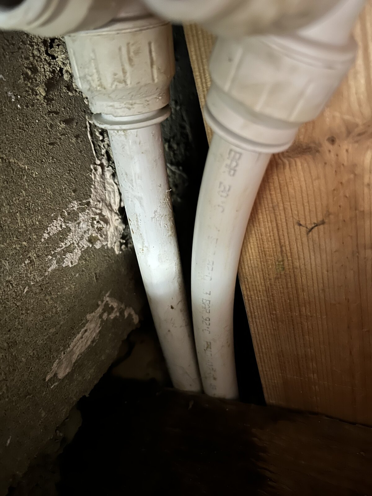

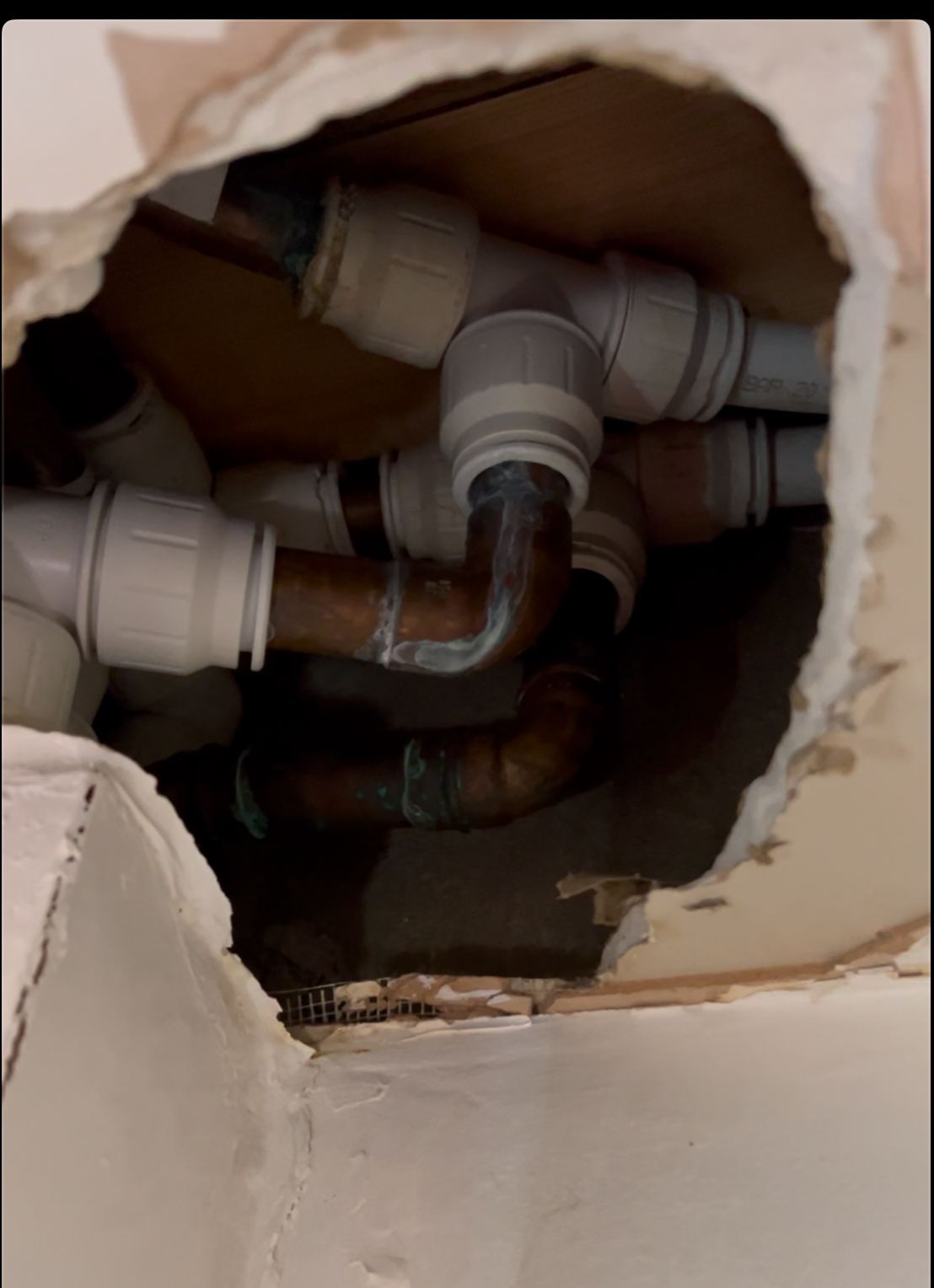

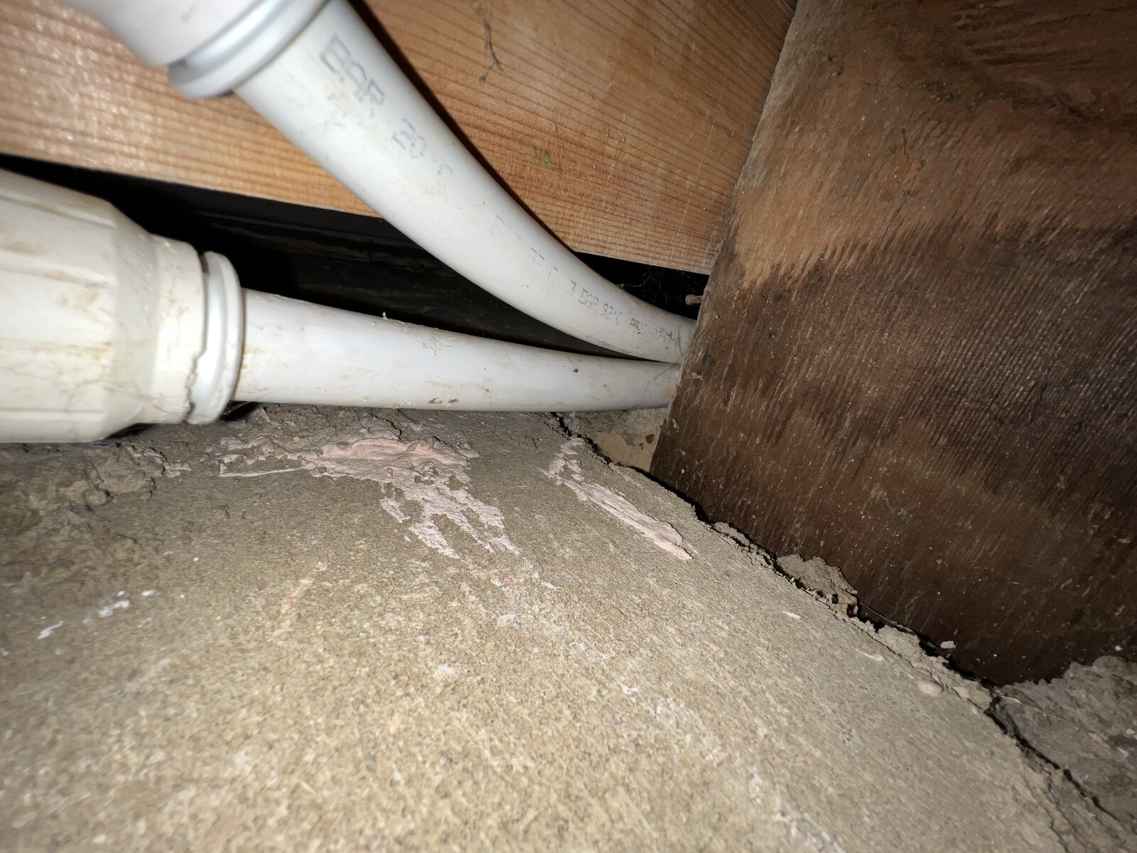

This join has started leaking again

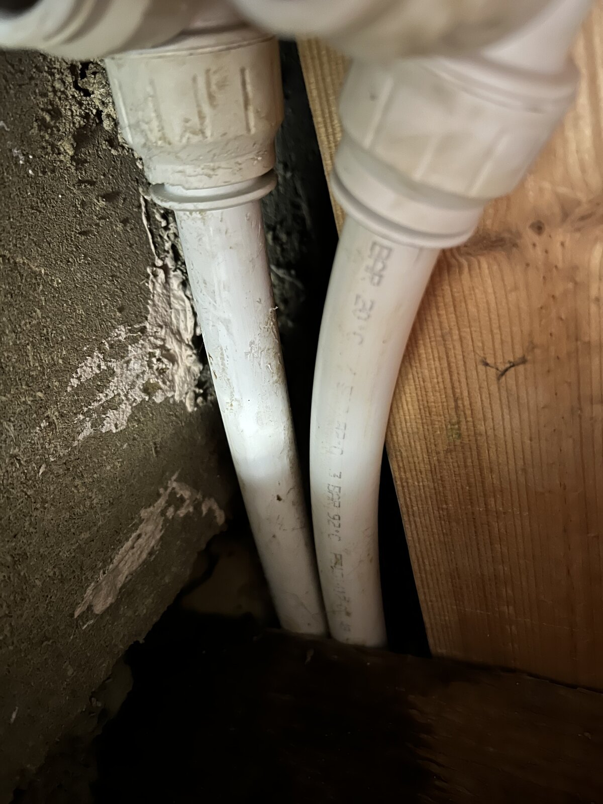

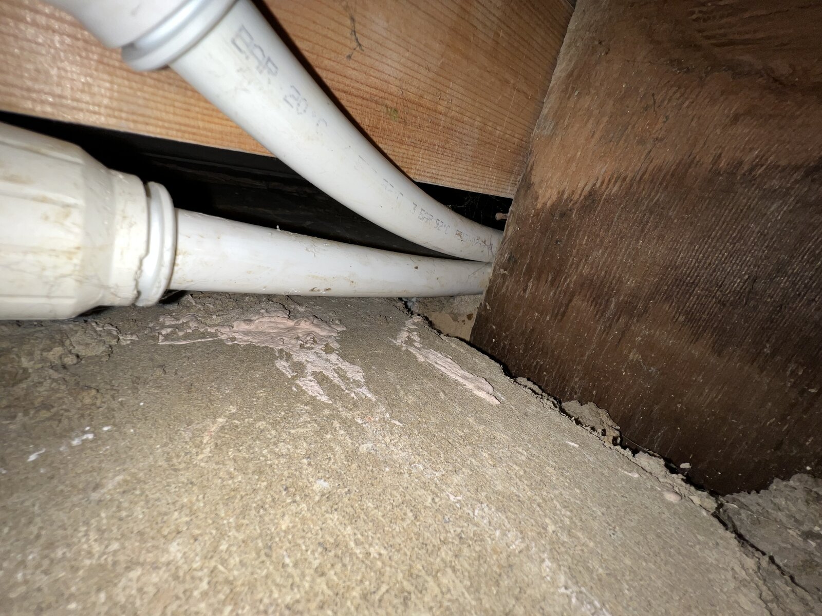

UPDATE - Replaced the Tee with another JG one and guess what…the plastic pipe had no inserts! It wasn’t the leaking side of the pipe though. I couldn’t see a manufacturers name on the pipe and assumed it would be JG. I brought the JG inserts and the first bit went through but I struggled to push it past the first rubber ring on the insert.
Ashamedly, I then put the pipe into the tee without an insert, like it was before. Nothing is leaking yet.
I suspect none of the other plastic pipes have an insert.

OP,

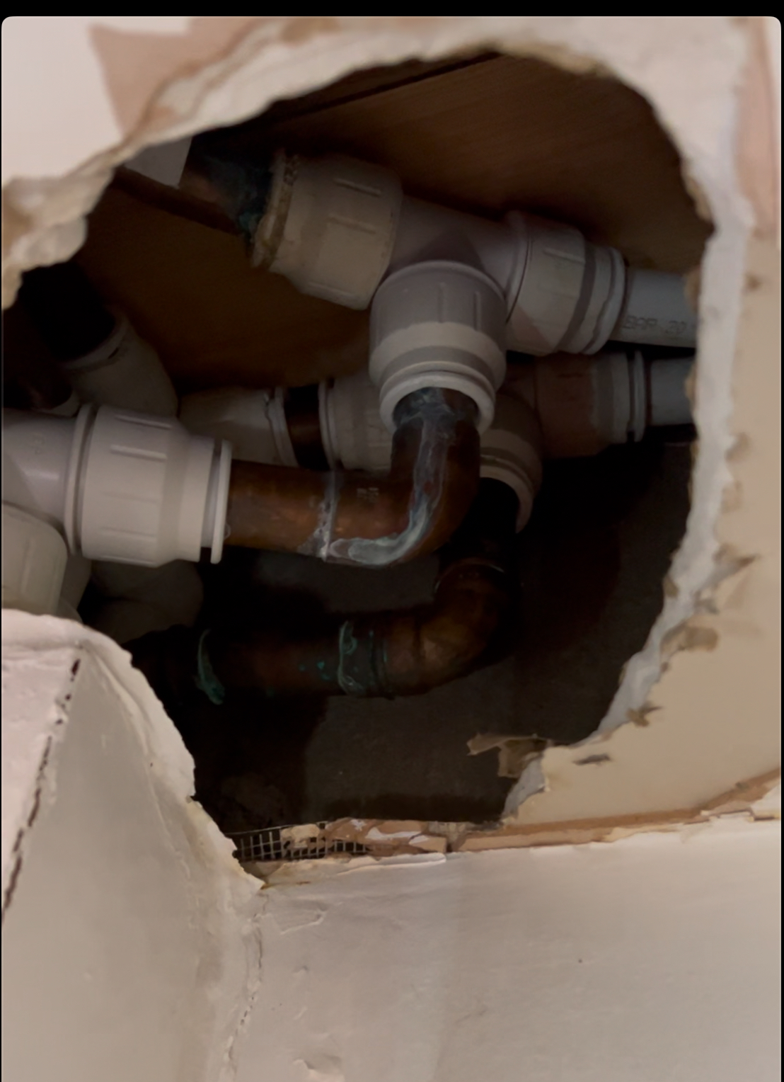

Thanks for the pic but I'm afraid that it only shows more or less the same tangle of pipes.
All pipework, plastic or Cu, should be clipped & under no forced mechanical pressure.
Excess flux at sweated fittings should be wiped off after the joint is soldered.
Ref the inserts etc - why not take the fitting in question to the plumbing suppliers also show them what you are showing us (pics & post) & they should provide the right stuff?
the super seal inserts can be a little tight to get in - I wet them first - though it does look like it could be JG pipe by that writing on the side of it. Either that or just get the standard inserts.
Honestly, don't take the chance, the fitting will hold onto the pipe without inserts but if it deforms at all (hot water and pipe softens etc) then it could blow off .... if it's mains pressure then that's a bit of a disaster.
As above, they can be tight when you get to the o ring, I wet them as well. Definitely try and get the inserts fitted, but it begs the question, how many more are missing?
In my experience - 15mm JG plain inserts (not superseal) will fit HEP pipe with a little persuasion, I use the end of my adjustable to 'knock' it in. HEP SS inserts fit JG but are loose. All makes of fitting and pipe are all meant to be a standard 15mm otherwise they wouldn't all be able to accept standard 15mm copper so the pipe and fittings should, in theory, be interchangeable
JG fittings are easily demountable and if the insert is left in the fitting then just unscrew and take out, dead easy. HEP fittings just don't like letting go of their inserts and 1 in ever 3rd insert will be left in the fitting, making the fitting unusable. I have been able to get the grab ring out of the fitting before now and then get the insert out but most of the time the fitting in then destroyed.
