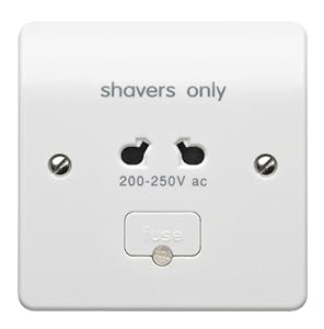

What if some one has a cheap Chinese shaver socket in their bathroom with no isolating transformer
Good point.
I assume one of these would be OK though, as it's not a cheap Chinese one:
The idea of shaver sockets is that they can be used with shavers from anywhere in the world in hotel rooms. That is why they have universal sockets and also two of them for either 120 or 240 volts approx. Also note the regulation on the transformers in them is poor. On low load the output is typically 140 and 275 volts. For this reason if charging toothbrushes etc with 100 to 240 volt input capacity I will always use the 120 v socket.
Maybe the ones with a designated tooth brush symbol are better, I have not checked.
I once believed this too. However, in USA and Europe, the socket in the bathroom is just a standard local mains outlet with no transformer. The shaver socket is a British thing. If you want to shave electrically in another country, take an adapter.
Indeed but there no need to lower our standards to those of the less informed. I have seen UK type shaver outlets in Australian hotels though.
