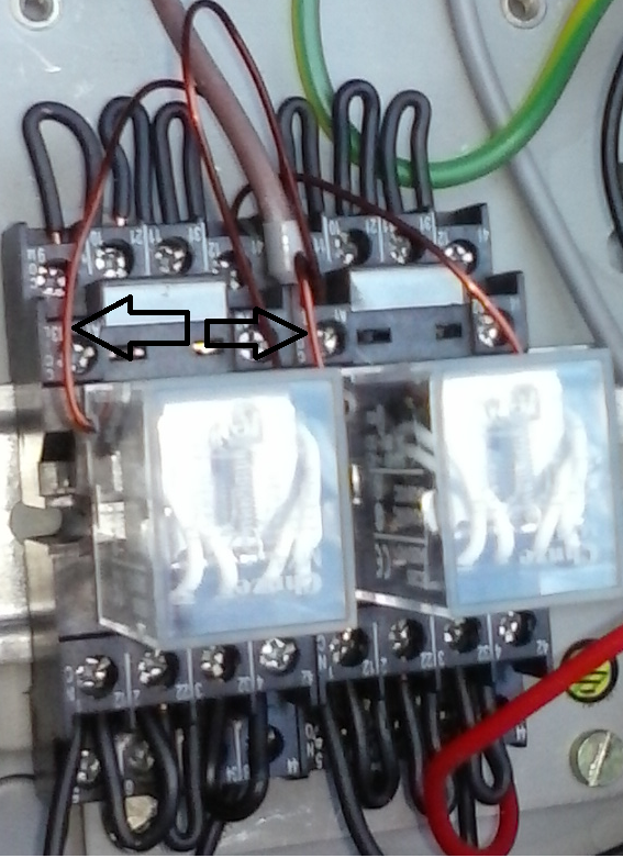

What you require is a current rather than voltage operated relay.
I made my own using 24V AC relays, stripped the enamelled wire from the coil and replaced with some thick enough to take the motor current, adding enough turns to operate reliably.

So nothing particularly powerful. Is my picture obvious?
If not the bit of enamelled wire coming out of the left of the clear plastic is a few turns of approx 1mm in place of the original thousands of very thin wire and exits the other side. I deliberately didn't try to use the original pins due to the high current of the pumps.
In my case I purchased those relay in trays of 50 so 'stock' item.
Cost naff all, free to run and simple.
Otherwise use a current clamp switch but most are solid state 'contacts' and limited to ELV.

Just as Harry says: The method I describe with a current relay (modified AC relay) also has zero standby load and no additional in use load either.
