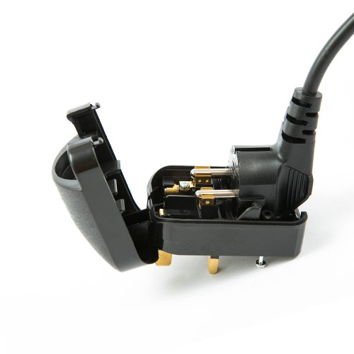

Is this power lead and adaptor suitable for uk use - from china
Would of these adapters connect with the earth on the lead I have?
  • Converts 2-pin continental plugs with side swipe earth terminal to UK mains plug
  • Rated at 240V, 13A, 3120W maximum
  • Product is earthed and fitted with a 13A fuse

May be this one would be better but i dont think i have one of these about.
The white one would do but I don't know what stops you putting the plug in upside down other than it would be upside down.
Has the black one got a fuse?
However - CUT OFF THE EUROPEAN AND FIT A UK PLUG.
Both of those adapters would be OK, but why o why, don't you just buy the correct lead fitted with a UK plug? You might even have one from an old kettle, computer etc.

Dont worry i will , its just i asked on another forum and another machine user suggested maybe just a 3amp lead but on here 13amp,and then im told they are only rated to 10a. Because of this confusion i have asked the seller to supply the correct connection if they can because iv now noticed other people from the uk who bought this machine have the correct connections for uk use.

The fuse in the plug is to purely protect the cable. The appliance has its own fuse as your first picture shows. Therefore 10 or 13 amp in the plug is OK.

Really? The cable in the picture says 0.75mm² on it! I wouldn't want to fuse that at more than 5 amps.
And yet that same lead has a Schuko plug which is typically protected by a 16 amp circuit.
No, me neither.
There is a discrepancy between 7671 and the codes observed by manufacturers and the ESC, which suggests 0.75 conductors of an appliance lead can be protected by a 13A fuse (up to 700W 3A, over 700W, 13A).
