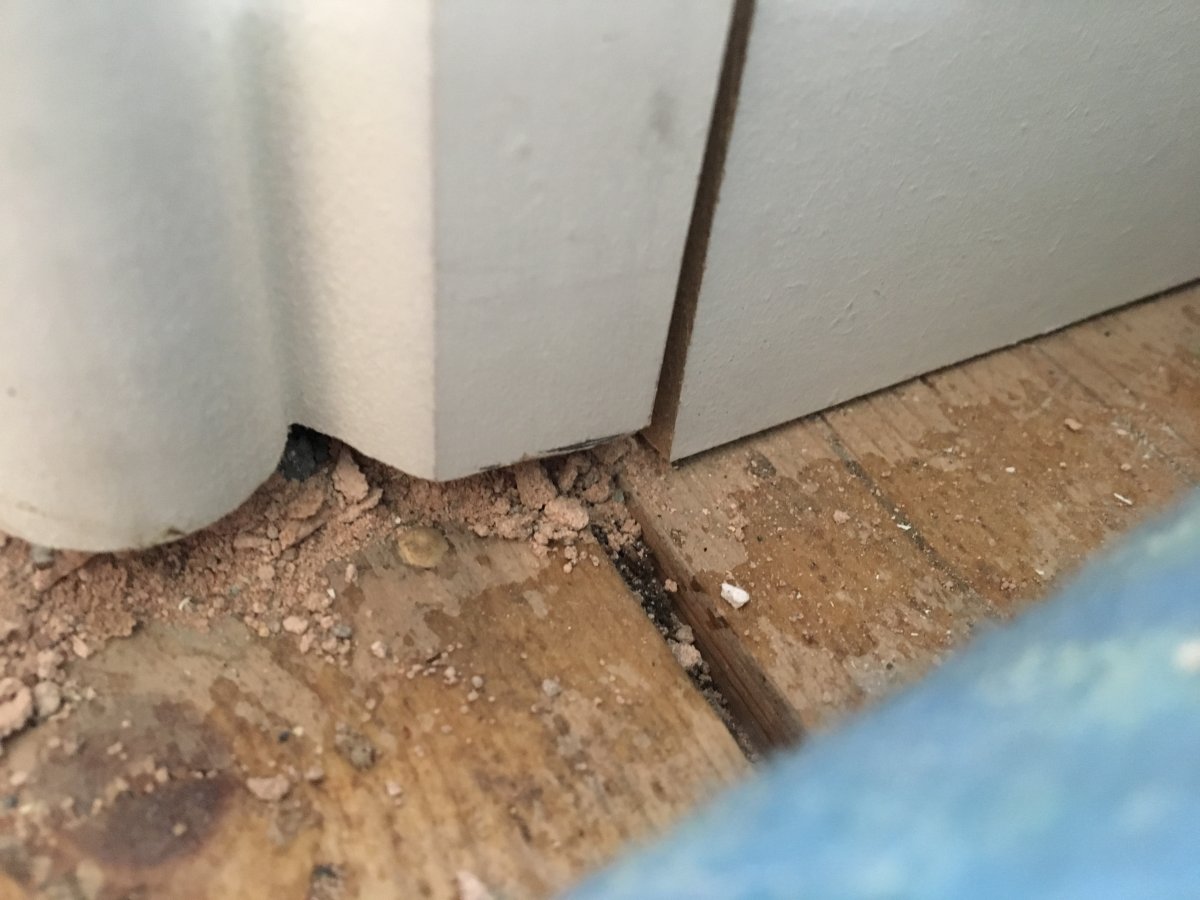

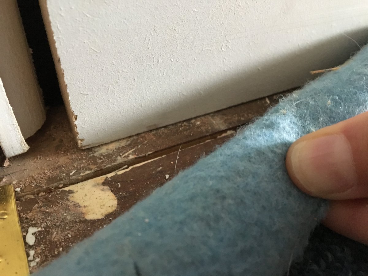

Well just when we thought it couldn't get any worse, we've discovered he's fitted the skirting against the floor. This is despite my husband asking him to fit it slightly higher than the old skirting as we're going for thicker carpet. So we can't get carpet (even if it was almost paper thin) under the skirting :mad:
As you can see from the last image, he's not lined up the skirting to the same height as the architrave that had already been fitted and which had left a suitable gap for the carpet.
We discovered this today when we decided to try and push the old carpet back in place, having now run out of time to resolve this issue and get carpet ordered & fitted before baby arrives.
Have decided to message him tomorrow to say that's the final nail in the coffin now and we'll need to rip off and re-fit the skirting anyway as we can't get carpet under it. I'm telling him I'm not paying him and he needs to compensate us for the cost of the skirting. I'm not having him back to try and sort this out and do another bodge job. I have no faith in him whatsoever now!
Carpet doesn't actually go under the skirting board. The carpet grippers will get set about 5-10mm from the skirting board, and once the carpet has been stretched, they'll then push the carpet down into the gap. Although the covering of the carpet may be thicker, the hessian backing is a standard thickness, and will be okay. Have a chat with a local carpet shop first.
As above. Carpet doesn't go under skirting.
