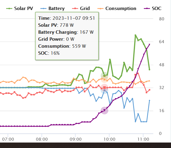

If I look at my solar PV today 1699355648188.png it looks like a saw tooth, but when it does produce it goes direct into the system and can't reverse and send it back to solar panels, but with water a sensor has to detect the water is hot in the panels before starting the pump to circulate the water, or it can cool instead of heat the water.
