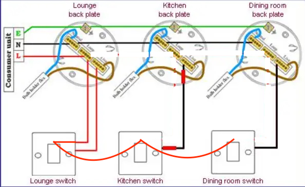

There's a three gang light switch that used to turn on three seperate lights. Two lights are disconnected now leaving only one light which is turned on by the middle switch. However, there's only two T&E cables going to the switch to control three lights which is what I'm confused about. Diagram below.
How does this work with three separate lights?

As crystall ball said - it is four wires rather than the two cables; all four wires + earth could be in the same cable.
I'm also trying to understand how it's all wired at the JBs or roses. This way is confusing me
Just think of what you need as a minimum for one light and then what you need for the other two.
I'll have a guess 1 feed and 3 switch wires?
What would you actually need if all the switches were/are in the same place?

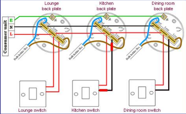

Yes I was thinking like that would mean 3 T&E cables down to the 3 gang switch. But if all all 3 switches were together in a 3 gang it would essentially be like the below, is that what you mean?
But then you'd have runs of just single wire no?

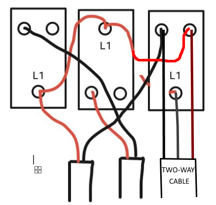

I also need to change one of the switches to 2 way. Is this possible with the two cable (4 wire in) setup? To be honest I'm thinking of just running 2 T&E cables and 1 3-core down to the switch as that's the way I know how to do it with one now being a 2 way. It's all original wiring anyway so wouldn't hurt to replace.

Yes sort of - depending on the location of the lights and the cable runs.
It depends how it is wired. You would (probably) have the two black wires actually running to the first light, then joined to other cables going to the second and third lights. You wouldn't actually use a single wire even if you did not need two.
Yes.
You will need to run a 3core&E cable between the two switch positions.

You don't need to alter anything to make one two-way apart from the extra cable between switches.
To make one of the switches 2 way you need 3C and CPC from the existing switch to the new switch

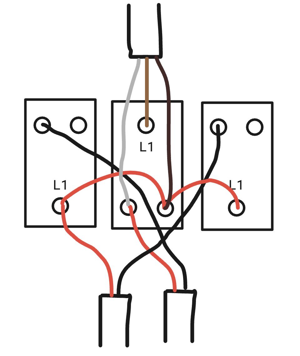

Thanks for all the help, all understood now.
Yes, that is correct.
I would use Brown to connect to the supply reds, but it doesn't really matter.
Whatever colours you use, at the new switch you must use the same colour for the L1 or its equivalent.
