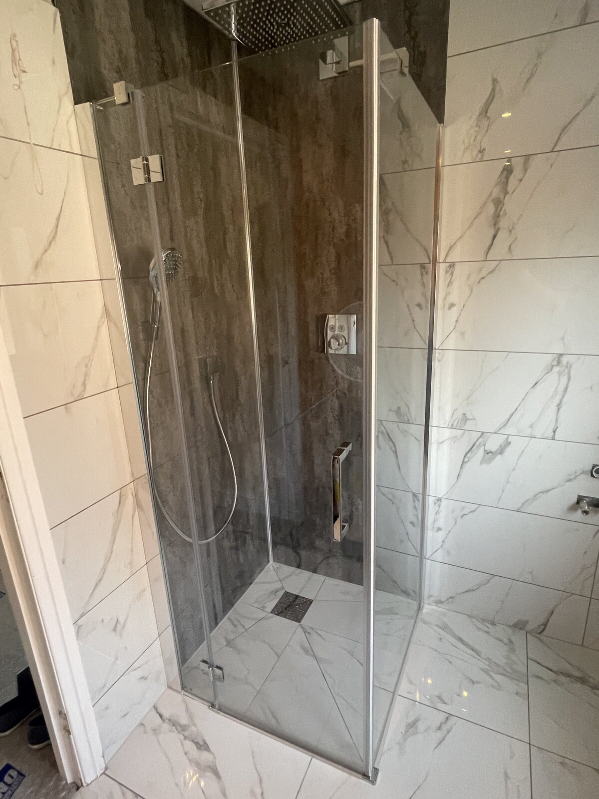

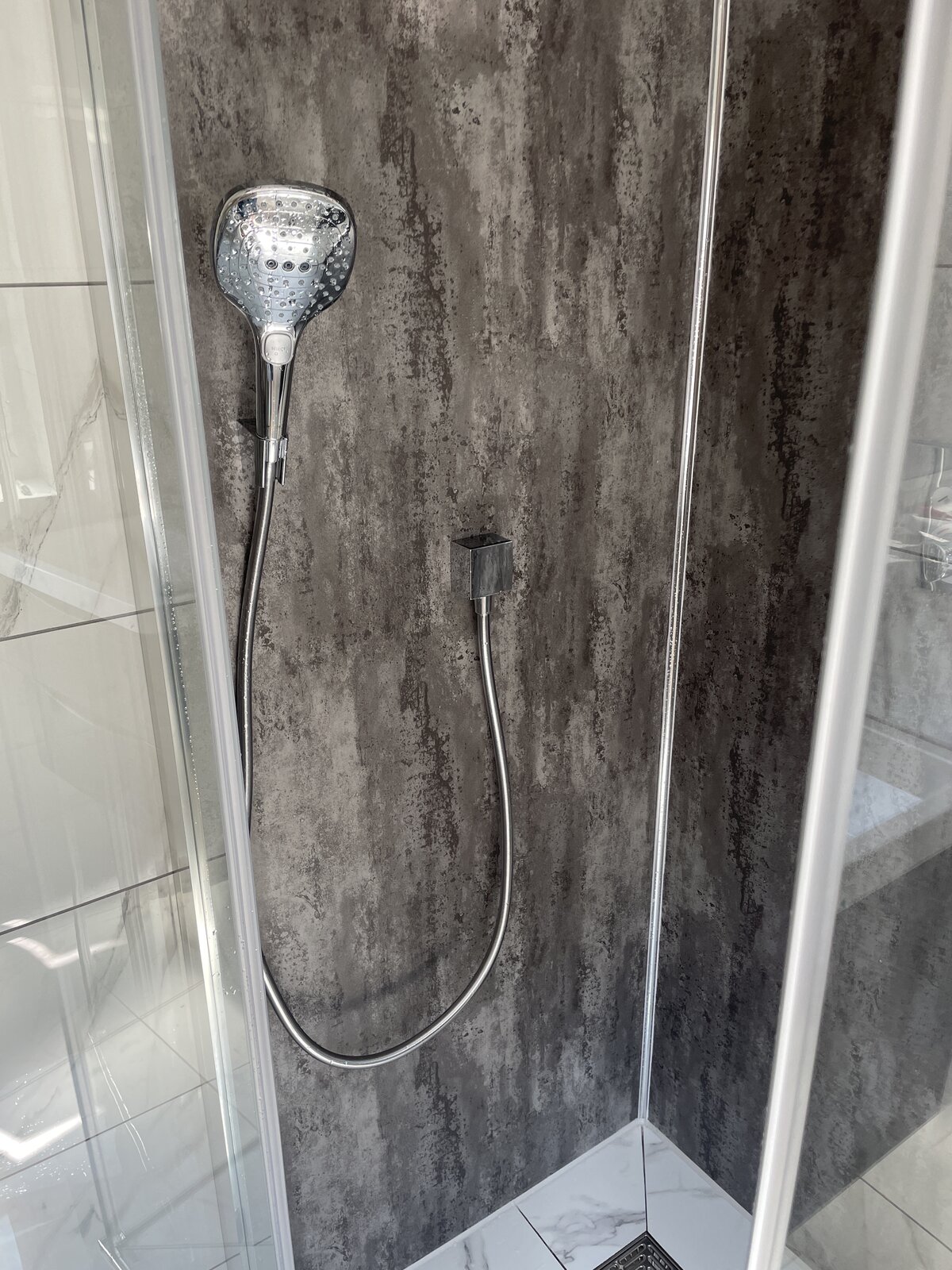

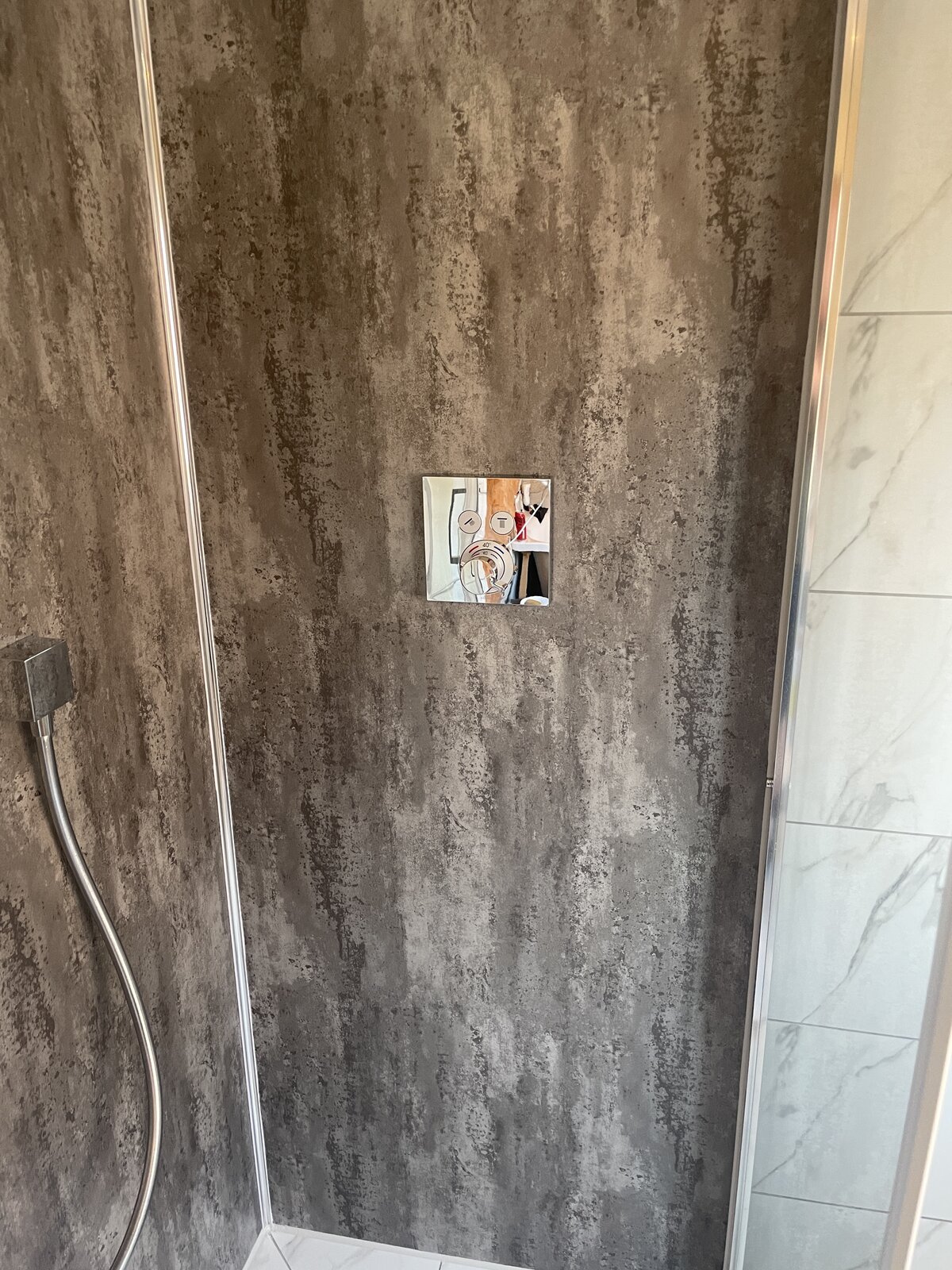

Dispute aside, I wouldn’t have much confidence in the work carried out to be perfectly honest, long term anyhow. Would it be feasible space wise with your shower screen etc to install shower panels ? Easy to install, look great, much easier to keep clean as no grout lines, and as long as you install them correctly no water is getting past them. They would just be stuck onto your tiles with grab adhesive, you would lose about 20mm of space. I’ve just put them in our bathroom, just in the shower and much prefer them to tiles for the shower area. At least you have the peace of mind that the tiles won’t fall off again or the substrate fail.
