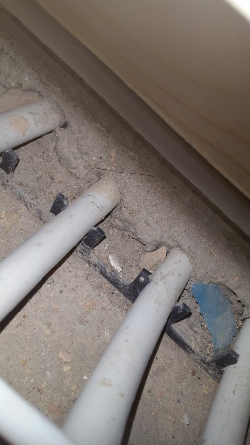

Also some looking about i came up with this not sure if it gives any clarity on the floor situation
I could be wrong, but looking at that picture, the blue plastic could be a corner curl of the DPM. if it is, then asphalt was not needed and has made the situation worse. The encasing cement screed is fine, but an alternative finishing layer like a latex SLC would have been better.
I can't see the asphalt in the image so I will wait until a tile comes up before commenting further.

Here is the floor design
From clay ground strata approx 200 mm of compacted mot stone fill, 25 mm of sand blinding , plastic membrane , Jablite insulation , 200 mm reinforced concrete slab , underfloor heating pipework fast end to secured plastic rail system , approx 65 mm floor screed , with approximately 18 mm of asphalt underneath the carpeted area's but not under tiles.
