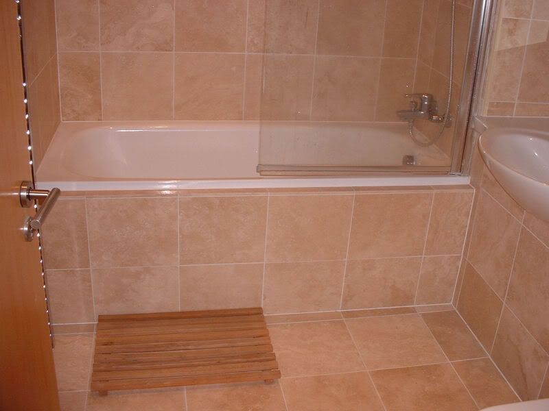

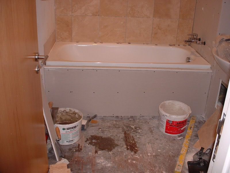

Like i said, that bathroom was done 4 yrs ago, feb 05, its still as good as when first done, no problems whatsoever with tiles coming loose, grout lines breaking up, water ingress.
Unfortunately you are assuming it was not tanked, however it was with a system called "Latex Expel".It was new on the market at the time, and if i remember correctly it was made by Sovereign, You actually applied it to your walls 1/2 hr before tiling, it was applied with a plasterers trowel,left for 20 mins, then it was primed and left for 10 min.Then it was ready to be tiled, finally it was finished off with "epoxy grout". Which was my choice of grout to use seeing as its waterproof.
I see your tanking kit is 'plasterboard colour' :LOL:
Tell me, why the slither? It might have been avoided if you didn't install the unnecessary ledge on the Bath Panel.
Give me a shout if you want a tip on getting the finished panel recessed slightly
