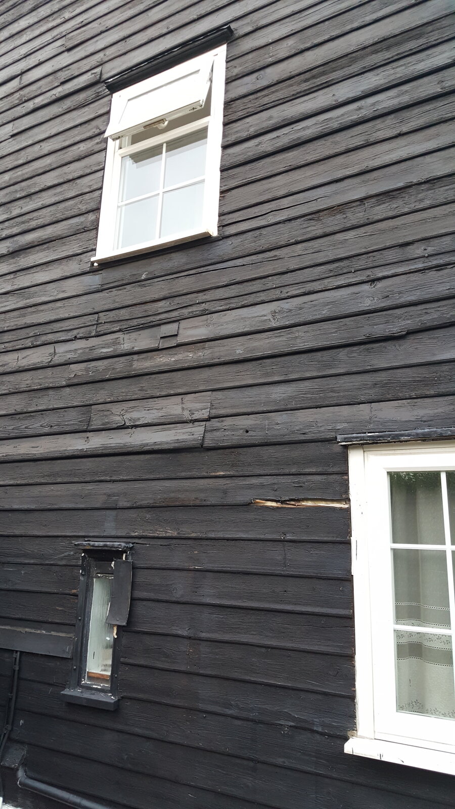

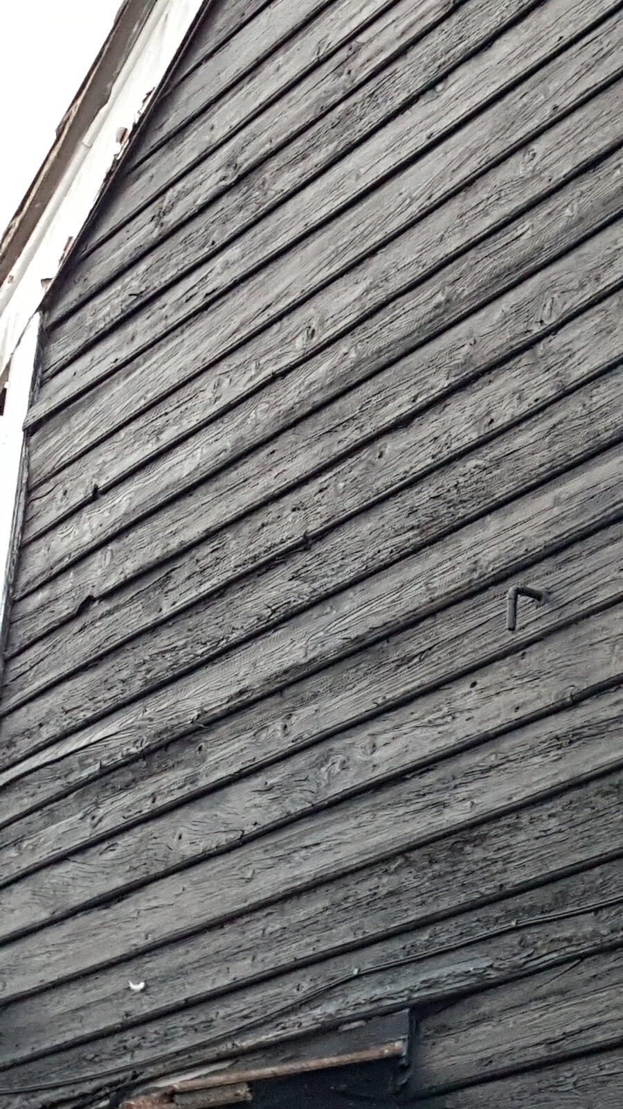

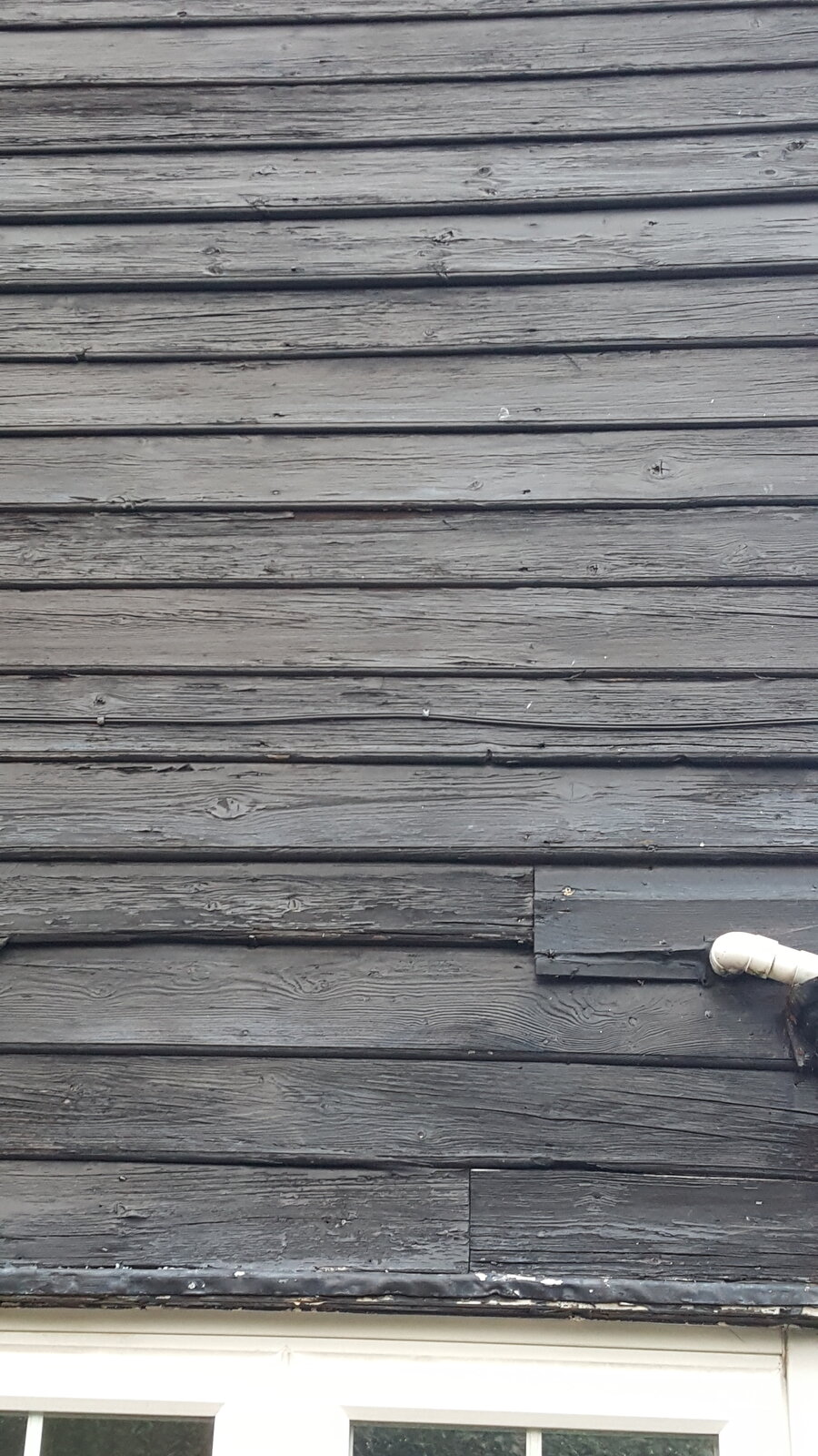

Hi All, I bought a timber cladding house which built in 1920. My neighbors and the previous owner also claim that they never need to replace any timbers, just paint over it. But then I look at tje current stage of the wall, I am not quite sure does it needs replacement to all or just a few broken one, and then brush up tje flake then repaint it. Any advice if i should replace all of them? Thank you for your time, greatly appreciated.
It would need a good poke around to be certain, but I'd say those boards are in the last quarter of their lives. I reckon a clean up, prep and paint would give them another 10 to 15 years. Depends how you would want them to look really.
Agree, good brushing down with a stiff bristled brush (e.g. https://www.toolstation.com/stiff-general-purpose-brush/p97606 and/or https://www.toolstation.com/industrial-stiff-yard-broom-with-handle/p29500). Make sure any bare timber is back to solid wood.
The treatment - ideally ought to be proper 'Creosote', very difficult to find nowadays or a mix of creosote and Bitchumastic. You need a liquid to soak into the timber. Modern wood preservatives just don't last as long.
That's difficult decision now, when I poke it from the bottom it feels like there is about 15% of board that need replacement. So the question is should I spend the money to replace a few rotten one and paint it all over for it to last another 10 years. Or should I replace all and then it last for 25 years (as wgt25 suggested, nowaday modern wood perservation don't last long)...any advice would be greatly appreciated.
