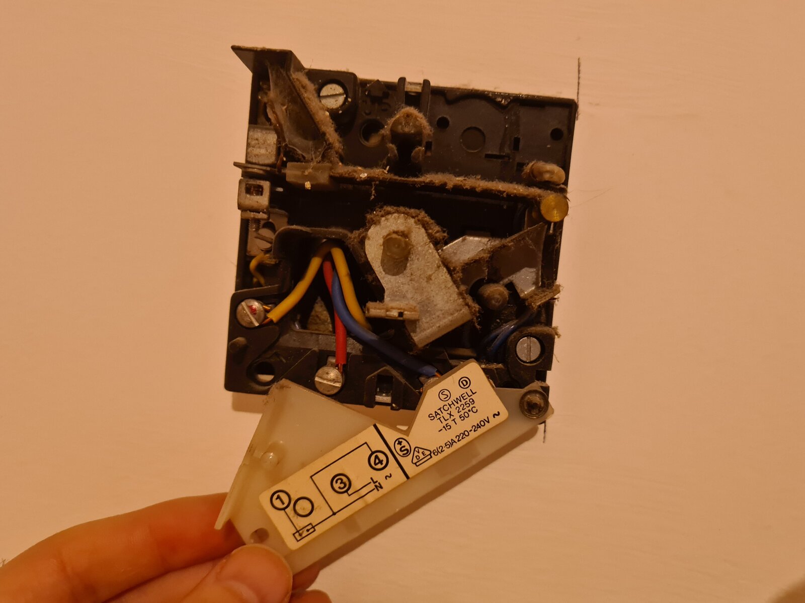

Looking to replace tlx2259. Wiring looks like this - can anyone give me a steer on what is is/isn't compatible with? Ideally I'd get a Google nest. Newbie here - any help much appreciated!
The red is live. The blue is the neutral. The yellow is call for heat.
you can use those connections to most thermostats that can handle 230volts.
That includes Nest and other devil’s contraptions.

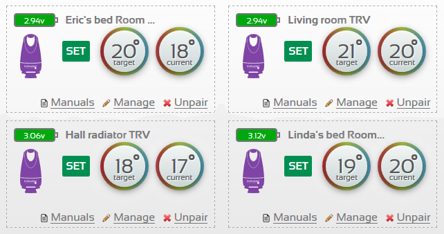

I have Energenie TRV heads which were claimed to work with Nest, they don't, but they have a OTT anti-hysteresis software so set to 20°C when room at 16°C and it can take 3 hours to reach 20°C, so I would set at 22°C for one hour, then 20°C and it was at 20°C in one hour. However can't do that with geofencing, so the Drayton Wiser TRV head claims to have built in algorithms which work out time taken so can rewarm the room within the hour. Not used them so don't know if that is true.

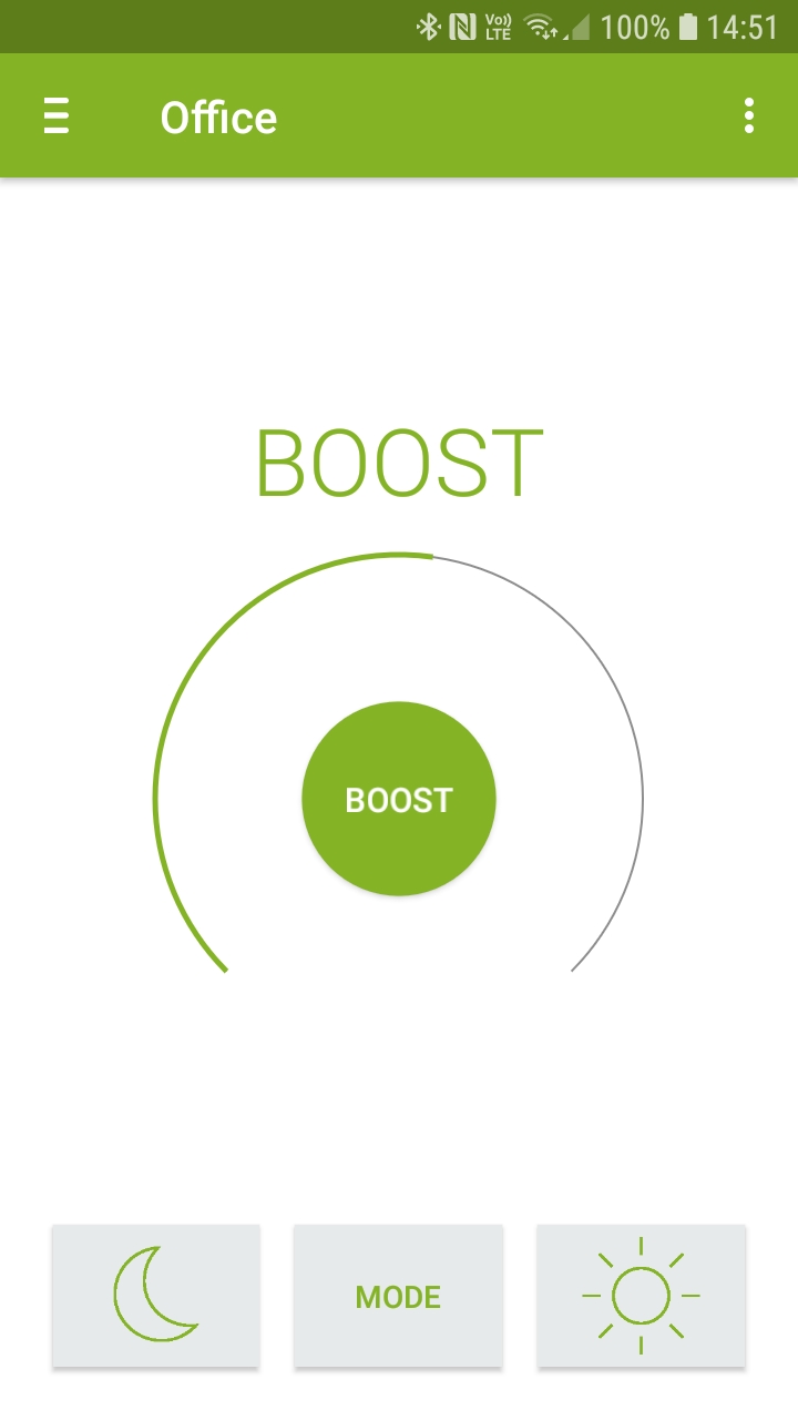

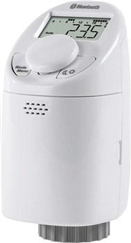

What we want is a comparison between makes of TRV head, although eQ-3 and Terrier i30 electronic heads are stand alone, most connect to a wall thermostat or hub, some are controlled from the wall unit, EVO-home1.jpg others need a phone, tablet, or PC to access the system, this TRV-report3.jpg looks good on the PC, but this EQ-3 Bluetooth Smart Radiator Thermostat.jpg is so much easier, on touch of right hand button and swaps eco - comfort or comfort - eco, yes can use bluetooth Screenshot_20190725-145157_calor BT.jpg but I do not walk around at home with my mobile glued to my side.

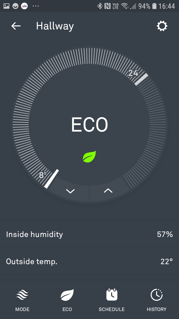

Same applies with wall thermostat Screenshot_20190726-164415_Nest.jpg in the main I simply turn the dial Hot water boost.jpg
