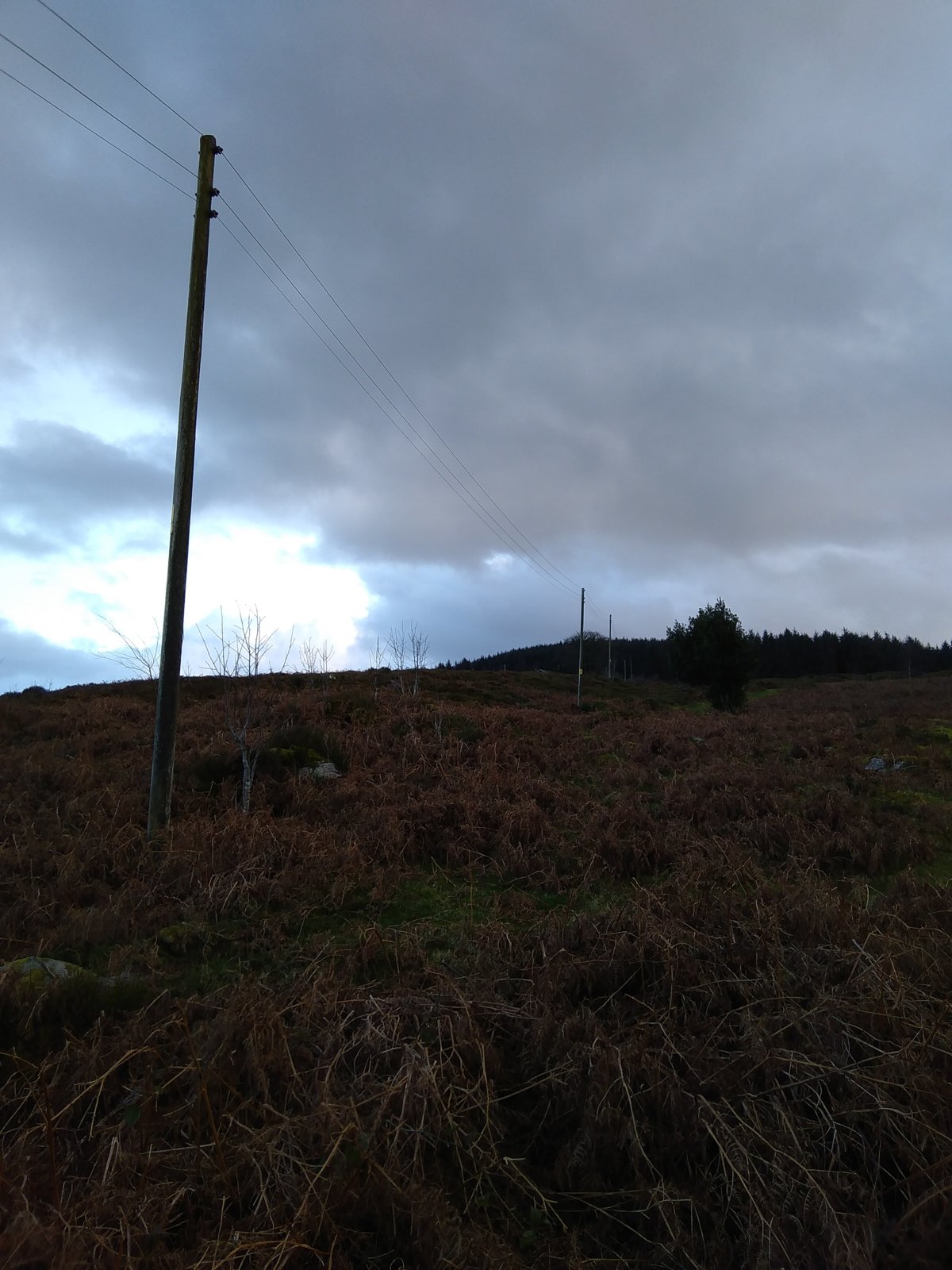

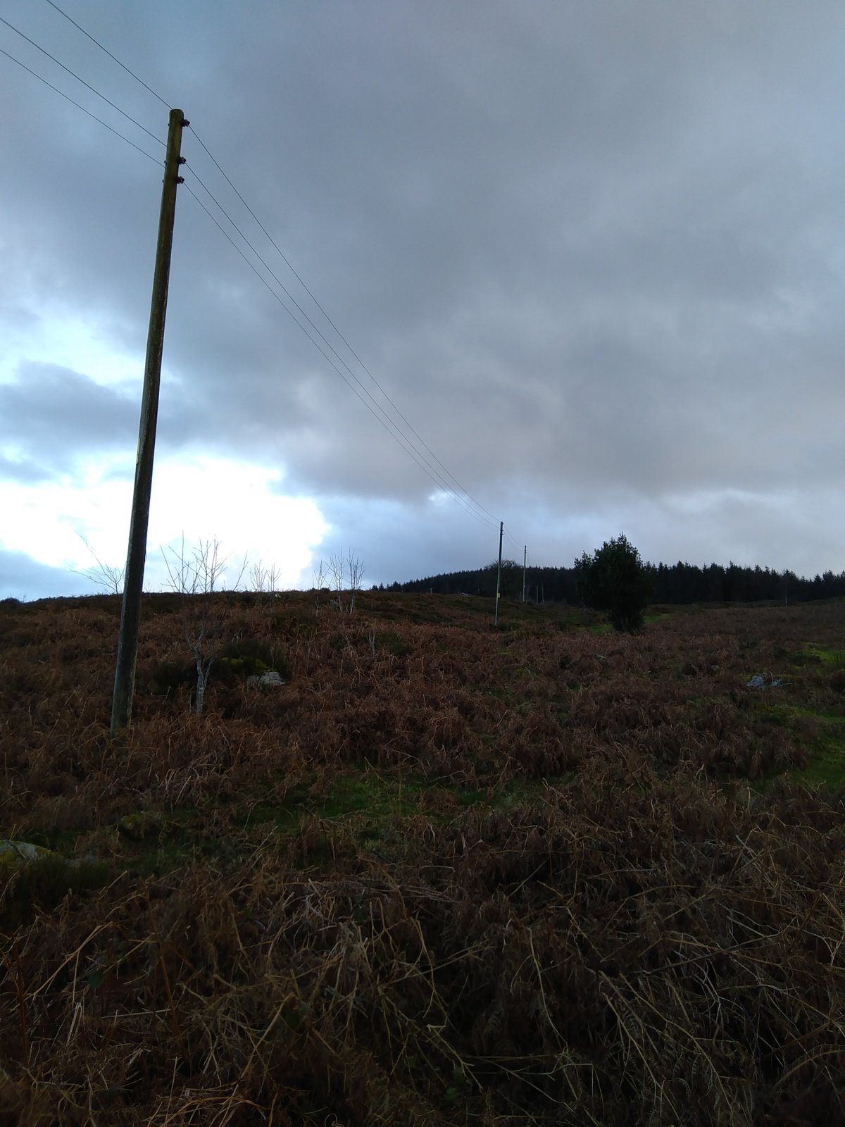

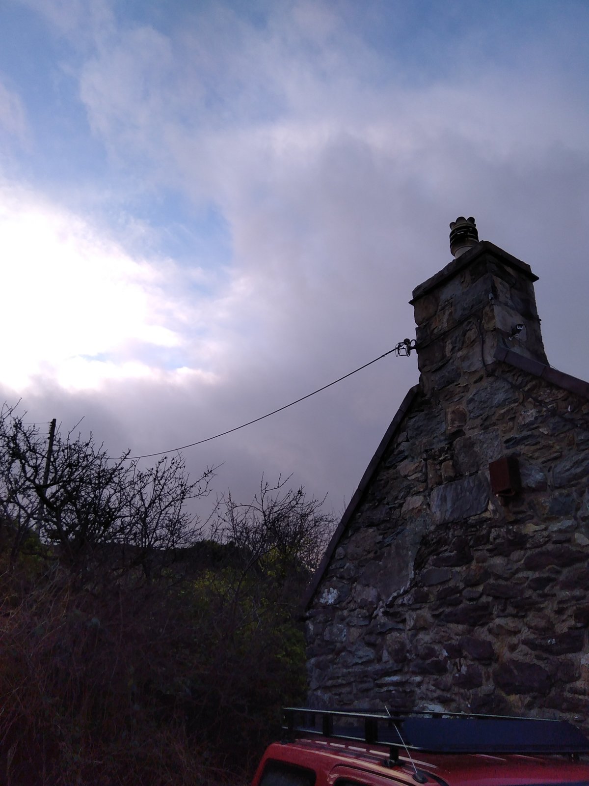

I have often been puzzled regarding the earthing of my parents cottage.
It is supplied by an overhead supply from a transformer serving three properties (including my parents)
It is a very long overhead line and my parents home alone is supplied by six poles, the other two properties are right in the vicinity of the transformer.

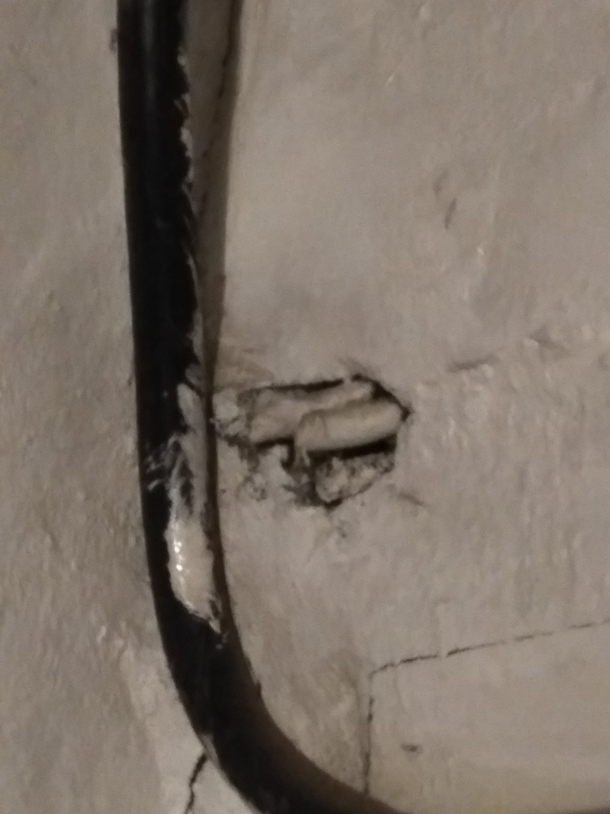

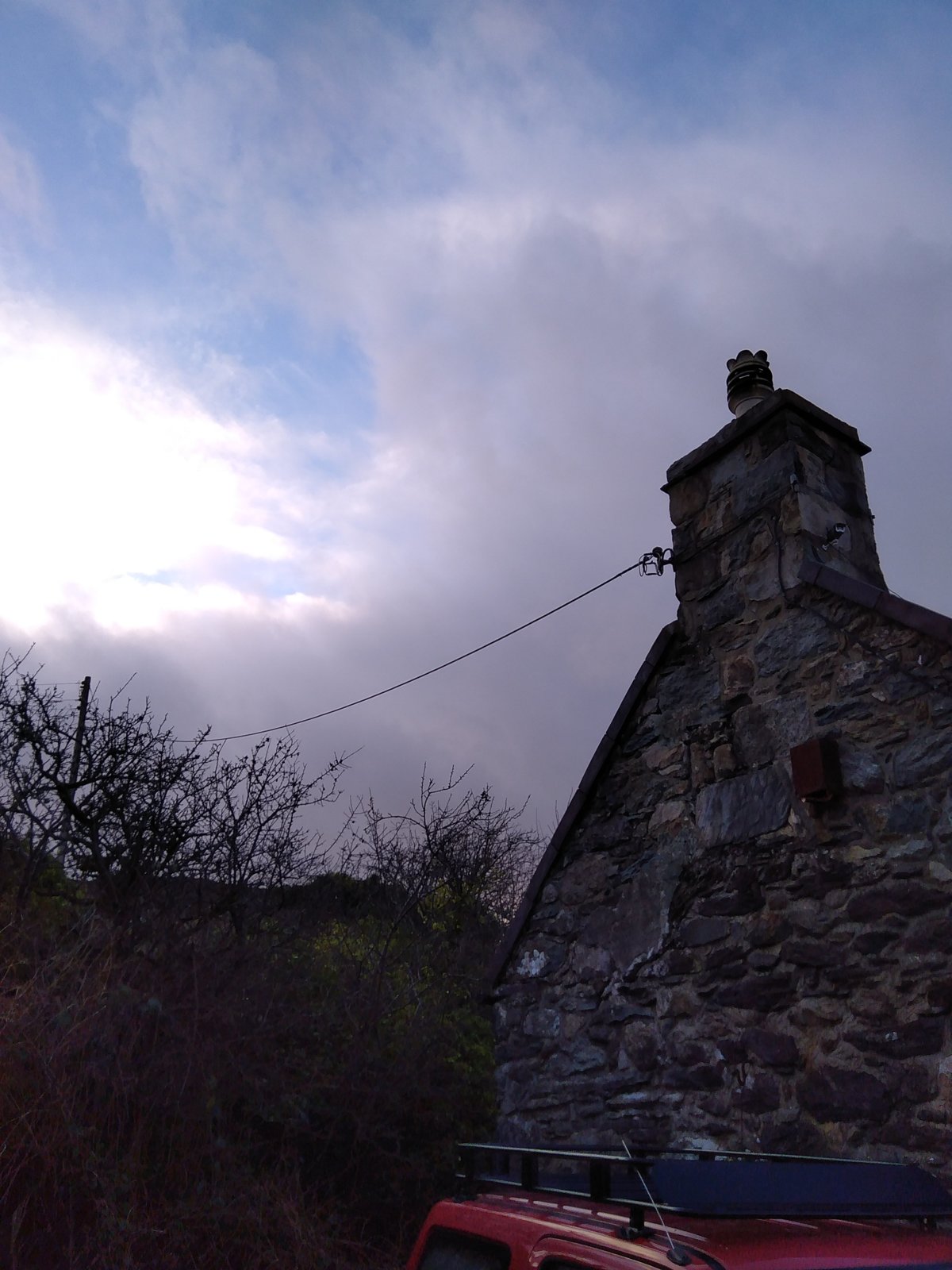

In 1990 the cable drop from the pole to the house was installed to replace three separate cables from the pole to the house (a short length of these redundant cables are still inside the house in the wall). The incoming cable appears to be a split-con cable and on the left hand side of the cutout where the earth block would be is a plastic cover (it 'wobbles' a bit....I know you shouldn't, and was wondering if this might have been a cover that slides off, but that is not possible now due to the consumer unit been in the way)

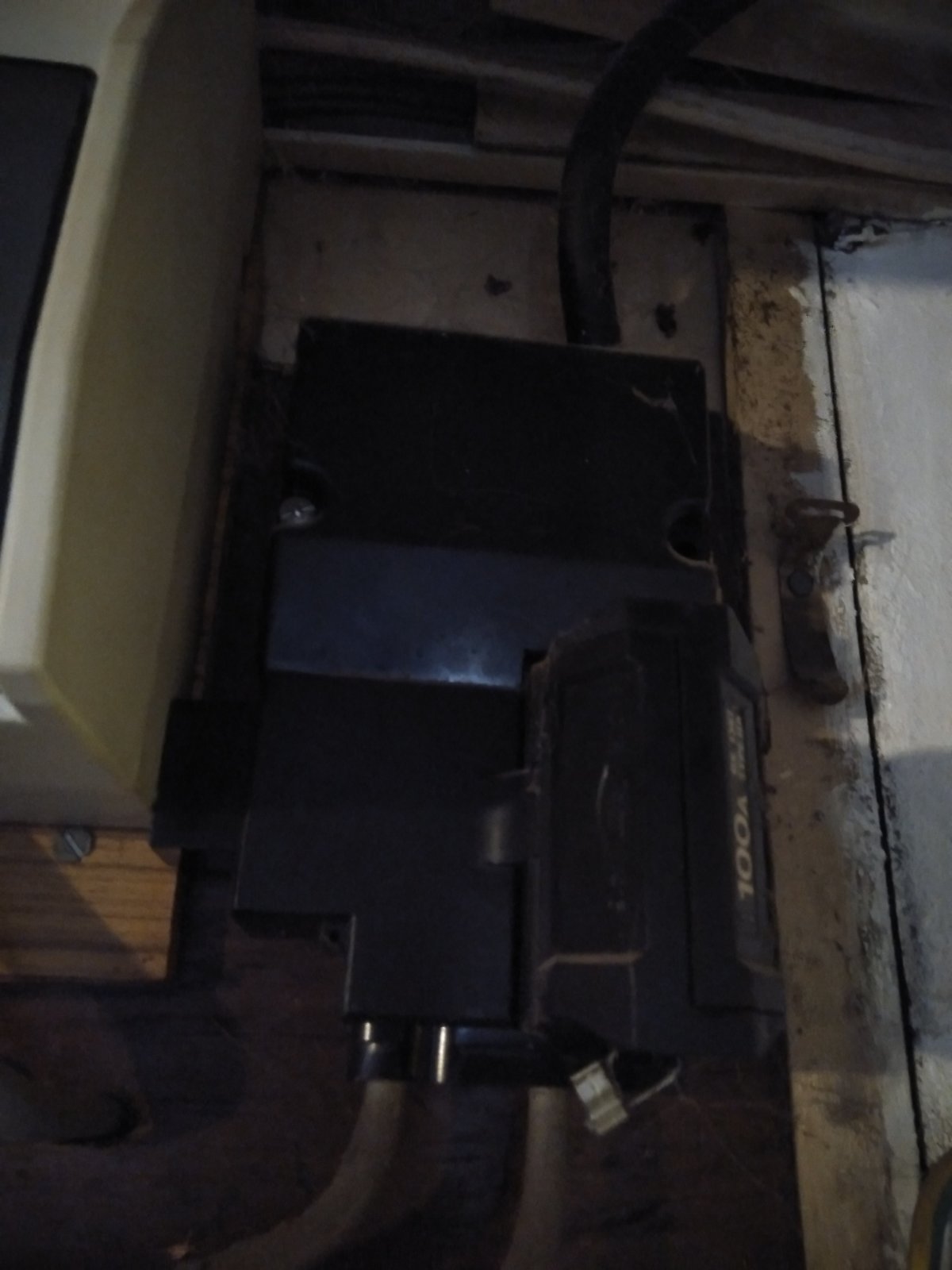

When the cable was replaced there was an old 3036 board and the old cutout together with the meter was directly below it. When the new cable was installed, the cutout was put in it's present position and the earth cable from the 3036 board was left connected to nothing! (not long enough to be connected to earth on new cutout)-house not earthed for a few years!.

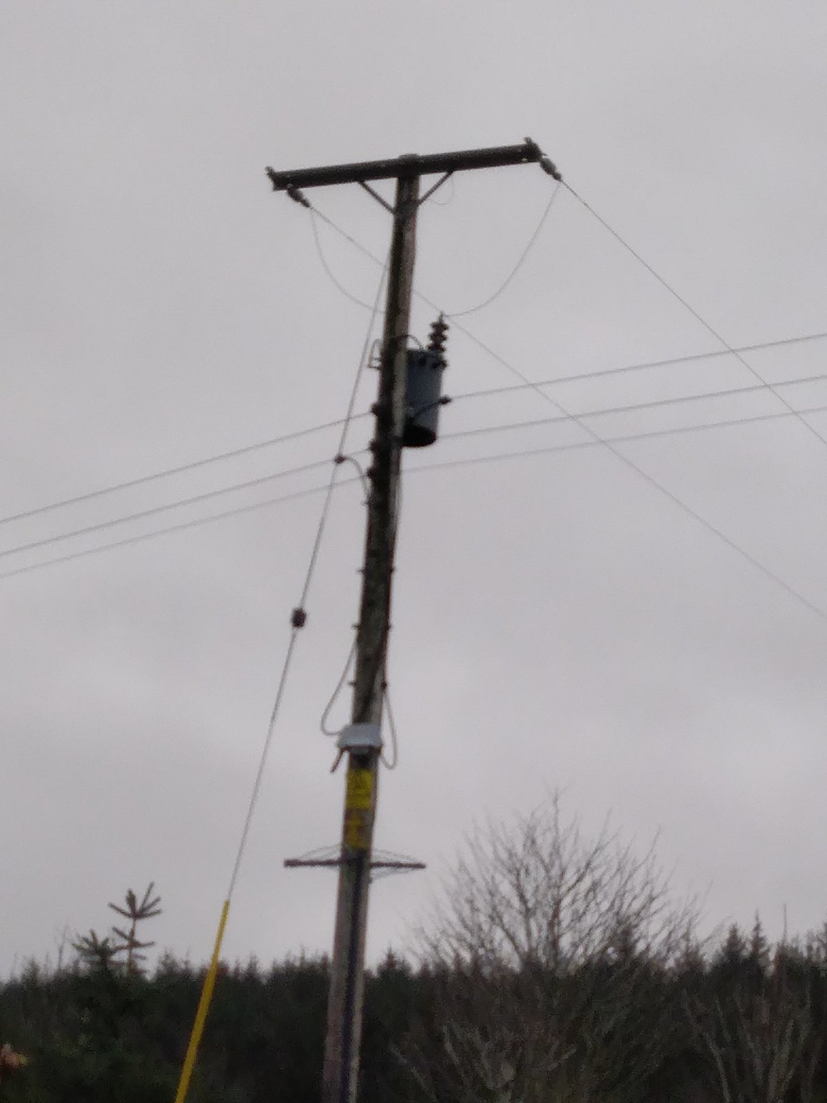

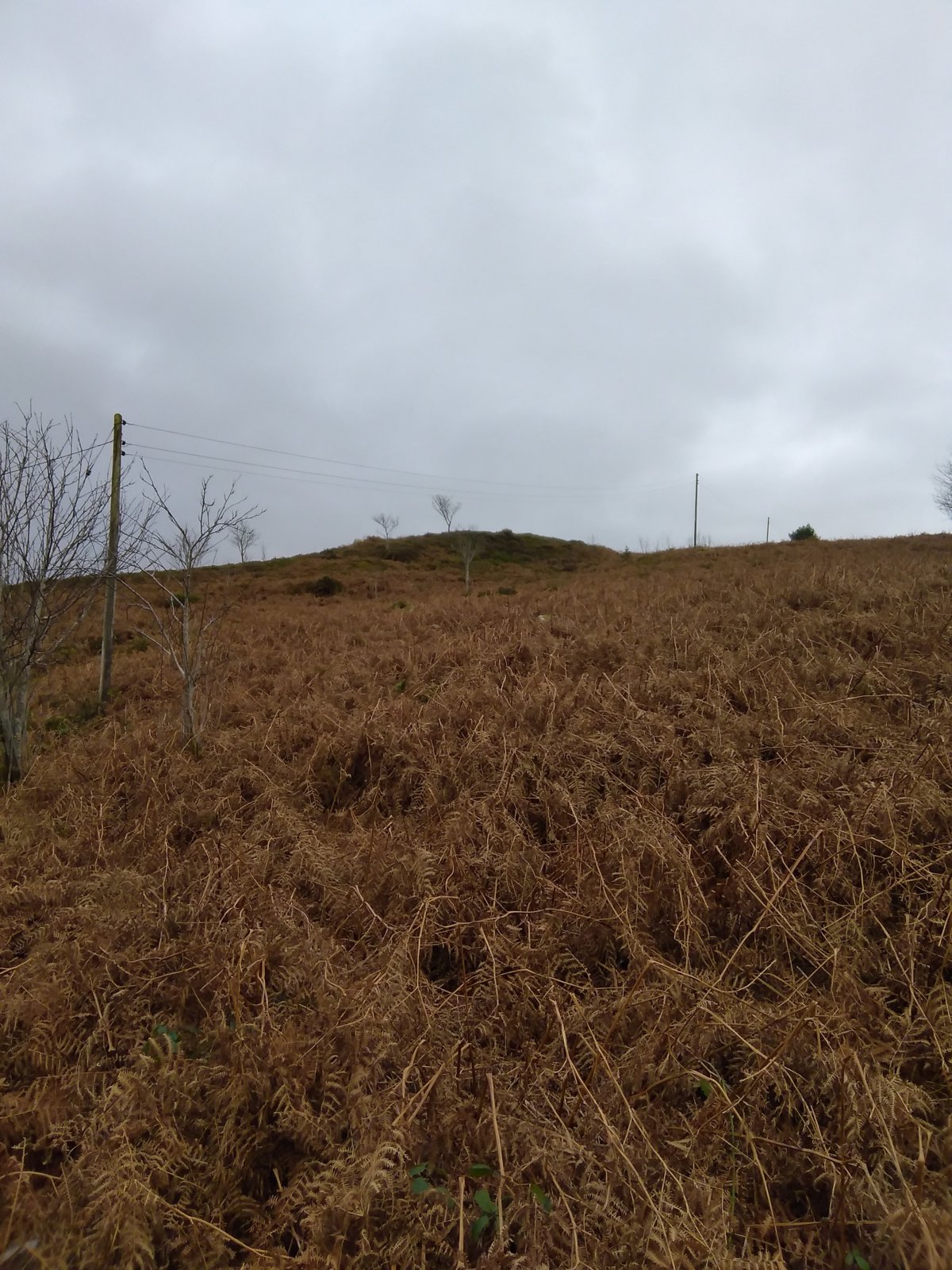

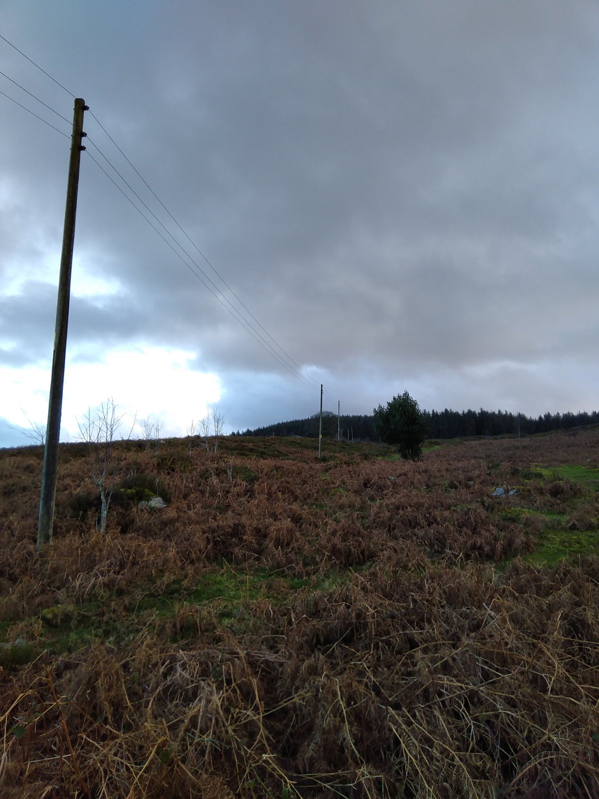

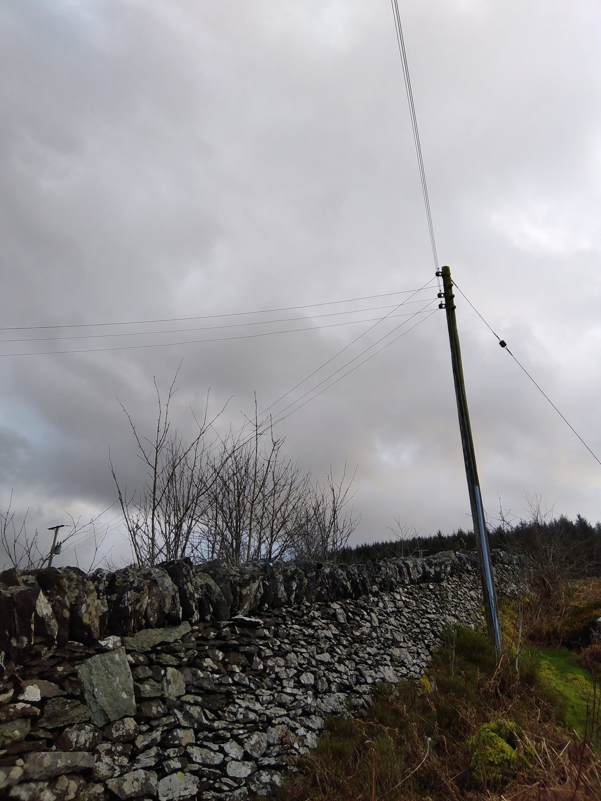

I'm posting (or trying) to post some pictures to help.

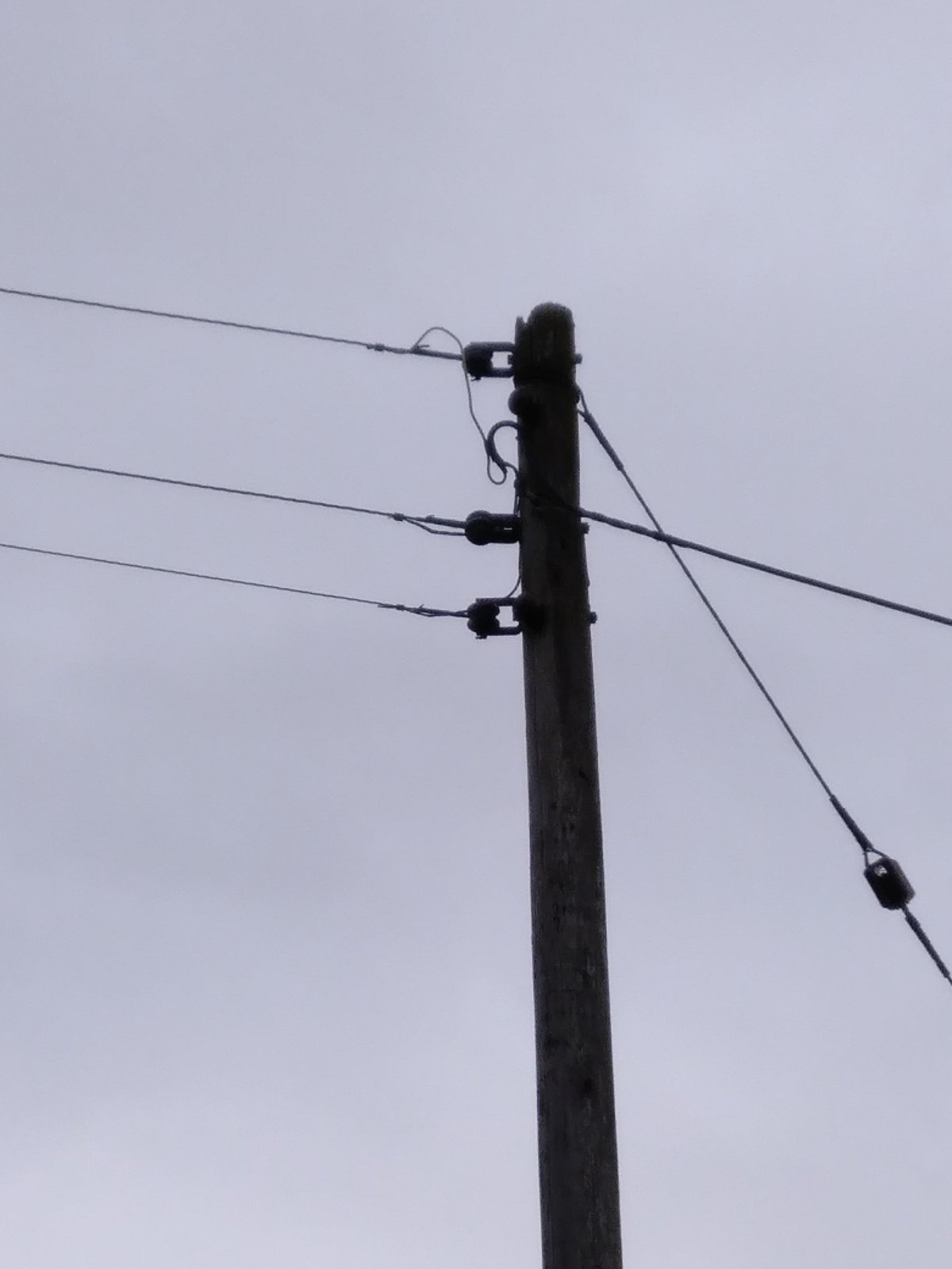

I'd be very surprised if the three conductors on the lines were live, neutral & earth. Never, ever, seen TN-S on a overhead. The cut-out doesn't have a PME label so it isn't TNC-S (rare with overheads but can be done with ABC cable). I suspect that when the feed was replaced it was intended that the customer supplied his own earthing arrangement but that never happened...most people seem to think that if the lights work then nothing can be wrong!

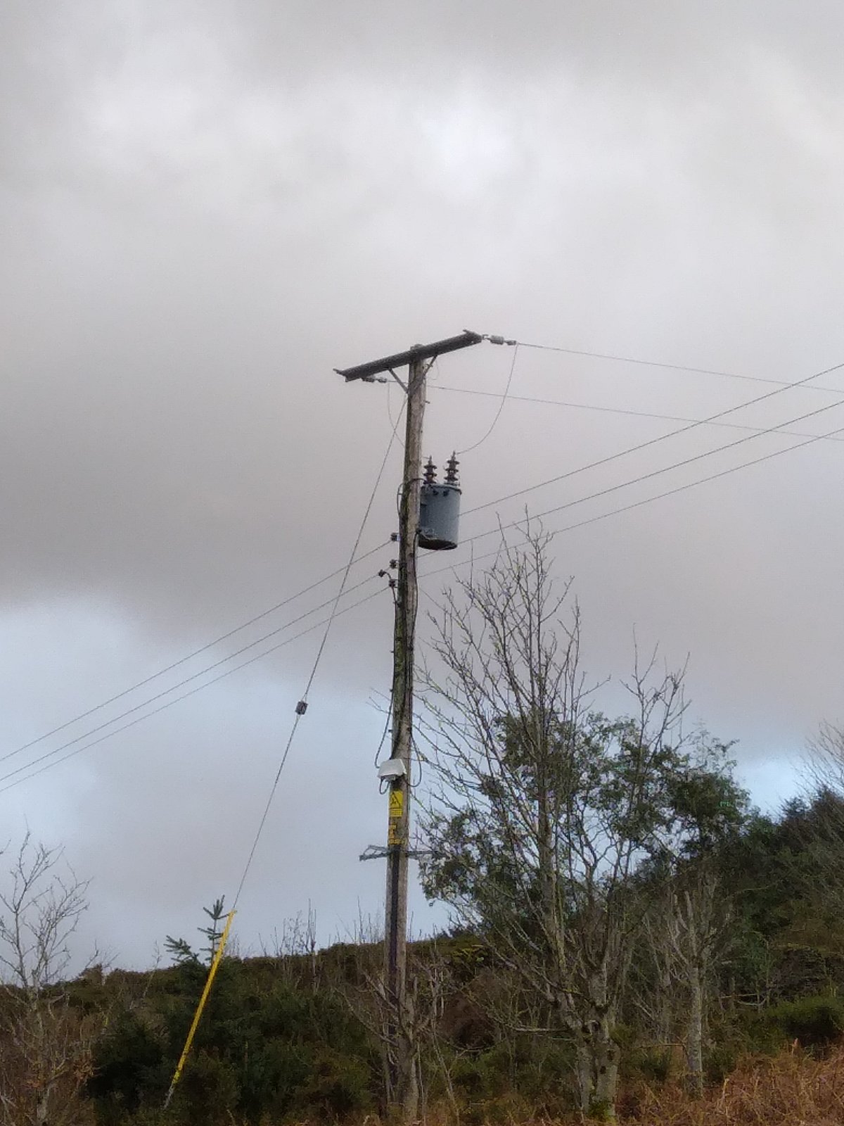

More likely to be split-phase with two 'live' conductor 180 deg apart & a neutral. It looks like there is a second fuse on the opposite side of the transformer pole? If there is then its highly likely to be split-phase. I suspect closer examination of the pole nearest the house will reveal that one of conductors isn't connected. Did the house ever have storage heating?
To answer your question... I think its supposed to be TT.

If you go and look closer at the transformer, (couldn't get too close, area now private land lol) there is a link between the middle and bottom ( thinner) cable.
Also, if I look up to the pole supplying the cable drop with binoculars I can see three 'cables' red top black middle and what looks like bare copper to the bottom.

It’s a single phase tank. But I too have never seen tns on the overheads.
Your lead-in appears to be concentric, there’s no pme label or an earth coming out of the neutral block. So it should be a TT stystem.
If the EFLI is <0.35 then your DNO would probably ‘give you’ pme, but why would you?
TT is a much safer system, especially on the overhead network.

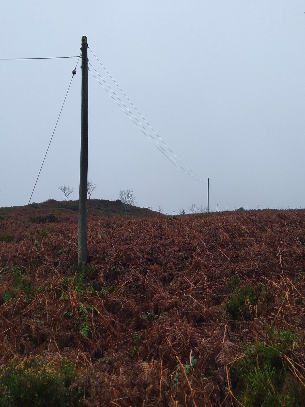

If you look at the image 'House Pole' and look carefully you can see a red cable (although fairly faded) at the top, a black cable, actually strands, in the middle and bare copper strands at the bottom (this is much clearer if I look up at the pole with binoculars)- possibly suggesting a 'split-concentric' cable?.

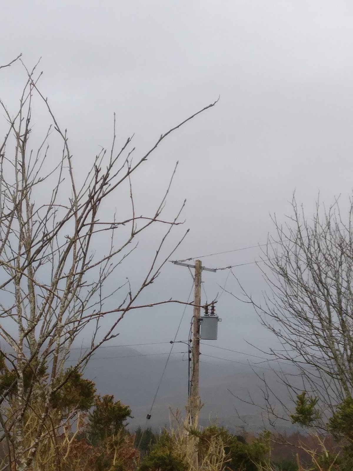

I have also included a closer view of the transformer. Looking from left to right, the three cables on the left go to another pole nearby, with a cable of the same appearance as that to my parents property in the image 'House Pole'.
The three cables on the right to the transformer, go to the pole in the first post (image 20200203) with one set of cables going to another nearby property (still served by three actual individual cables going from the chimney stack into the property) and the second set of cables going to the poles serving my parents property.
If you look carefully/zoom in to the image 'Other Side of Transformer' you can see a wire link between the middle cable and the thinner bottom cable.
When I had a look at the transformer pole, there is just the one fuse on it, in the grey enclosure, a cable from the transformer going into it, then a cable going out of it to the top cable, and from the other side of the transformer is another cable going to the middle cable (which has the wire link, shown in tho photo going to the bottom cable, from the bottom cable is a cable running, in some form of ducting/trunking, to the ground).
I have also include a clearer photo of the overhead line serving my parents property.

As I have already mentioned, the old cutout removed in 1990, was directly in that position, incoming supply prior to the black cable installed was three actual conductors (see photo 'Old Redundant Cables' in original post).
