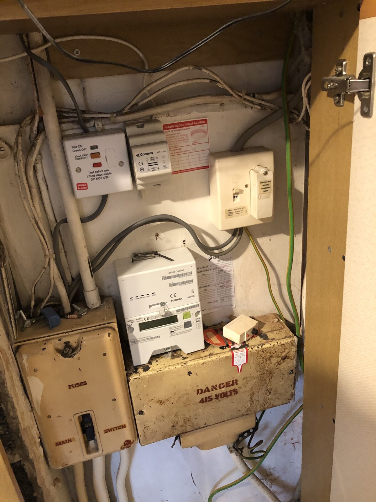

TNS supply Ze at 1.7ohm
My understanding is that if there is a DNO-supplied TN earth, then they are obliged to 'maintain' it (which, in the case of TN-S, often means changing it to TN-C-S) ??

So much higher could it be to be acceptable?

If that's your supply coming into the box marked 415V, it doesn't look like SWA.
It appears to have a copper strap round it.
I would describe as a wrap around P clip with a pinch bolt. I think it is copper or maybe brass?
I’ll ask my electrician if he knows.
However my first question remains
Is Ze of 1.7ohm ok?
That would depend on whether the supply is maintained by the DNO. What did your spark say should be done about it?

However my first question remains Is Ze of 1.7ohm ok?
It's a bit more than double what most people seem to regard ads 'the maximum' for TN-S.
Whether allowed or not, a Ze of that value would preclude having any circuits greater than 20A, and may not even be adequate for longish 20A circuits (or long 16A ones -unless one used unusually large cables. In other words, it would be 'impractical'
