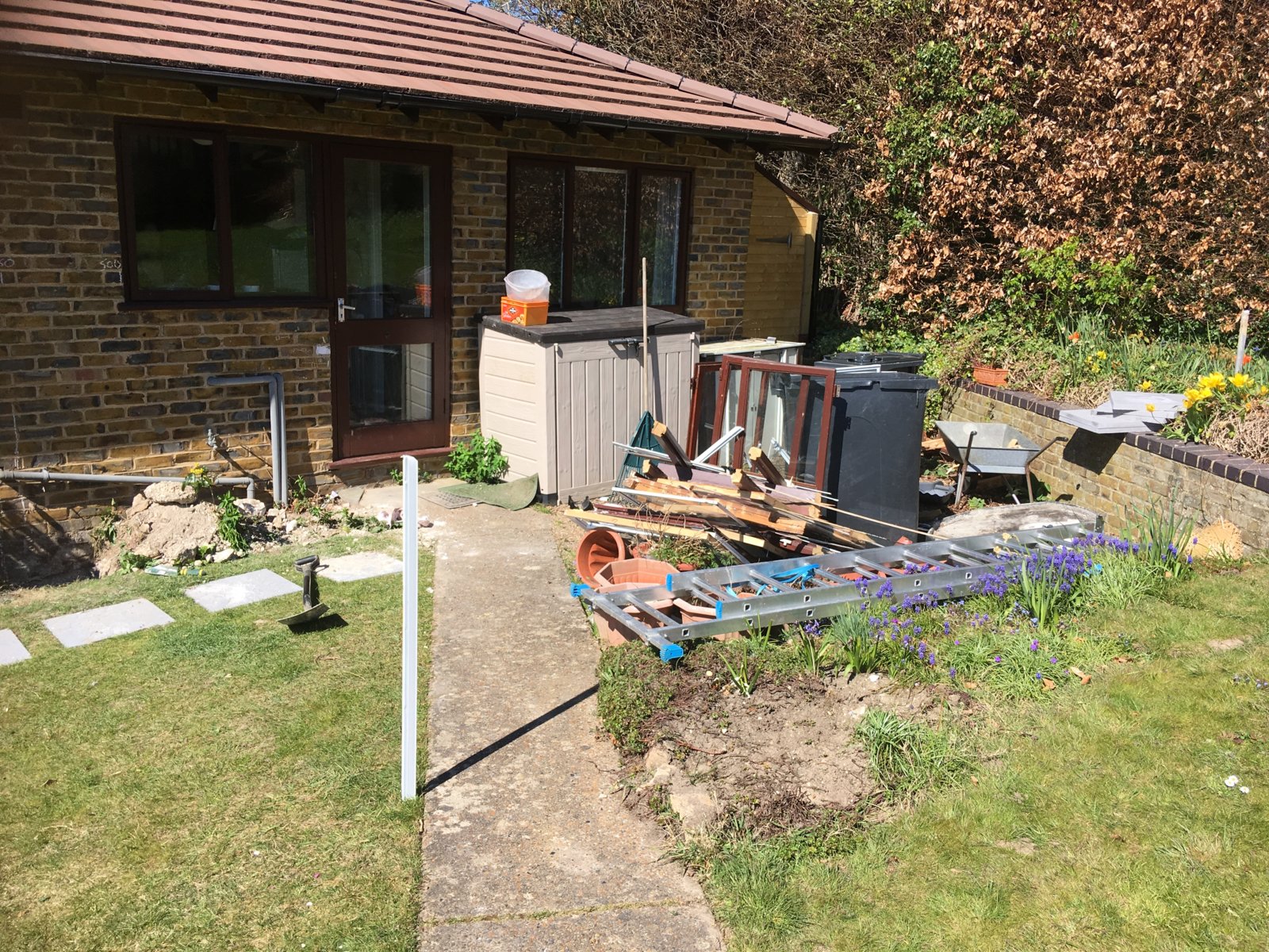

I am planning a conservatory/extension, and am unsure which way to go. It will be as per these before and after drawings. I've also shown a photo of it currently.
The advantage of a conservatory is that it does not need to be signed off by building regs, but it would mean I would have to have a separation from the dwelling. I may have put in doors to separate the 2 anyway so this does not necessarily put me off.
My question is, currently the doors and windows that would separate this conservatory from the dwelling are original single glazed wooden things; does this give me justification to replace them with (like-for-like) wooden single glazed bi-folding doors, as opposed to modern external UPVC jobs? Would I get away with these being sufficient to "thermally separate the conservatory from the dwelling", since they are replacing like-for-like?

What I build will be exactly the same either way; it's whether I decide to go extension or conservatory classification i.e. avoid BR with a conservatory but have to have thermal separation from the house.
Is thermal separation the only thing that means BR are not involved? If you are building the same structure either way, that seems like a loophole...
Thermal separation (i.e. external doors and windows between the two), and a dedicated heating system that is independent of the rest of the house are the main restrictions on a "conservatory".
So I couldn't make it one giant open plan loving space if it were to be a conservatory, though with bifolding doors between the two it wouldn't be far off.
Got that, it just that seems like a substantial building to attach to the side of your house, and not need BR, just because your calling it a conservatory (less glass than I would define a conservatory as)
I agree. I'm not sure myself hence the question.
Apparently there used to be a (BR or LABC) definition of a conservatory, and that the walls had to be 50% glass and the roof 75%. However in 2010 this was superceded to not include any specifics about ratio of glass.
Definition of conservatory from 2010 BR

The attached is a very interesting guide on conservatories.
  • labc_4893_techg_conservatories.pdf
Isn't it just.
Hence my temptation to build this "conservatory" as opposed to an "extension".
My reluctance would be that if it's a conservatory it is pretty isolated, unless you put a wide bifold or big french doors in.
