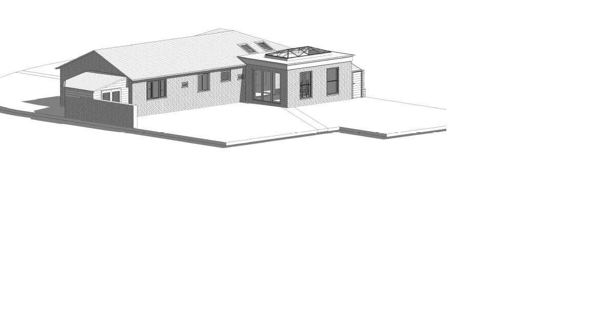

Well if you look at my drawing, it is an orangery as we know them.
Orangery/Extension/Conservatory.....call it what you like, but if it's thermal separated from the dwelling then it is technically a conservatory and therefore exempt from BR.

the BR rules for conservatories changed, I think in 2010 or 2013 cant remember, but the 50% glass in walls and 75% glass in roof was removed and became just 'substantially glazed'.
I used to email the LABC and say: 'this building will be substantially glazed, under 30 sq m, thermally separated. Do you consider it to be an exempt structure'.
as long as they responded yes, the job could go ahead without BR.
But is there a reason you want to avoid doing building regs?
if you build a brick built structure, having it inspected is peace of mind -especially the foundation.
That's right. The 2006 BR rules stated proportions of glass; this was superseded by the 2010 rules which give no mention of glass proportions.

Well, I kind of planned to separate the thing from the dwelling with the existing doors and windows anyway, so this thermal separation is no compromise really. Avoiding BR saves the best part of £1000 in fees, and avoids a lot of hassle and delays, plus I can get started digging the foundations etc while under lock down.

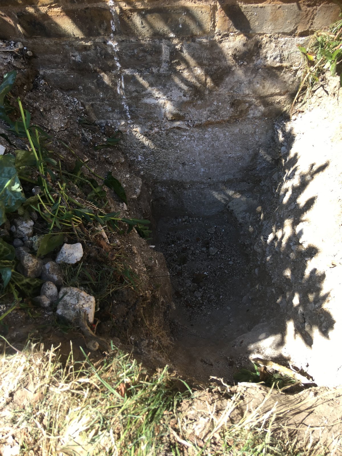

I've already tested one area of footings. I've dug down to the bottom of footings for the house; there is a solid chalk bed and then 45cm of concrete and then the first course of bricks. So I am happy to dig 45cm down to this solid chalk bed for the orangery footings.
