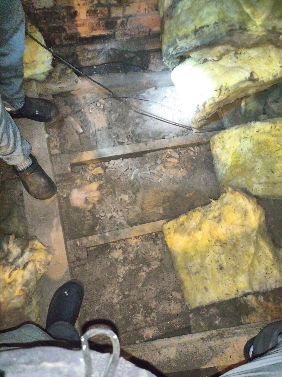

Hiya, someone has probably asked this question somewhere, but darned if I can find it when I need it.

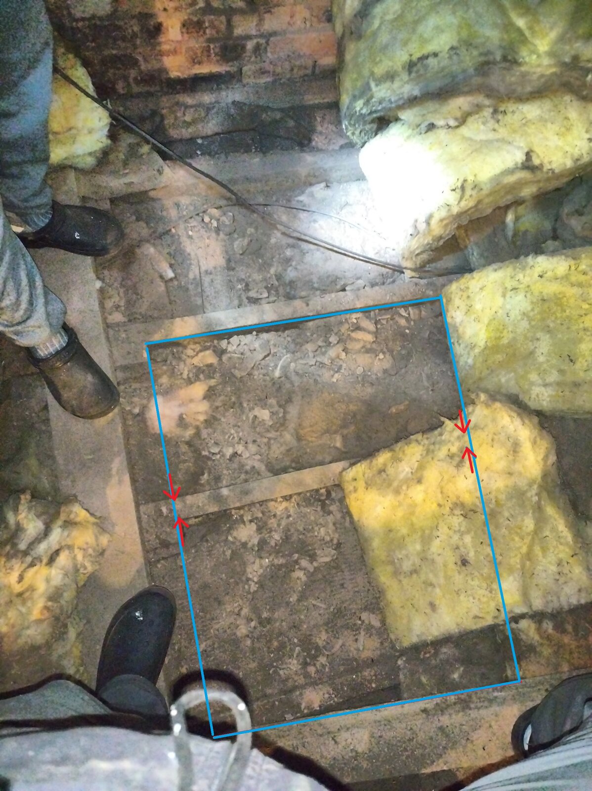

Want to cut out a loft hatch hole in a new place on the ceiling to make it easier to access the loft.
Basically, can I cut this timber (think its a joist maybe) and so I can make the hole approx. as as indicated in the blue?
I would cut it where the red arrows are in order to make a hole indicated in the blue frame.
Is there anything I put in, to support this joist and then cut it? A frame around the loft hatch which connects it to the joists?
Those joists are about 5cm x10cm and they are about 40cm apart, seem to lying on the top of the brick walls which has that large beam as well that we are standing on.
This is without the blue frame and I assume that is just plasterboard ceiling I could cut through?
I am not touching any of the main beams or strut thingymajigs. Pic below of the loft area and where the new hatch hole would be in marked up in blue frame:

Google joist trimming - this is how you create the opening. I would moved it a bit away from the wall as you'll need to fit a trim (like a door architrave) round the opening. Size of opening will be determined by the size of hatch you've bought or made.

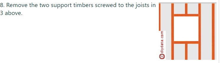

Thanks. Spotted this which you think is a reasonable guide?:
https://www.diydata.com/carpentry/loft-hatch/loft-hatch.php
I guess I use normal untreated soft woods in order to support and trim up the joist?

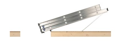

Was heading in the direction of creating my own hatch cover if I need about 80-85cm sq hole and fit my own ladders?
But am finding cheapo sliding ladders sets in seem to have 100cm+ space requirements behind the loft hole.
Just wondering if there are any cheap and cheerful ladder options that would not need 70-80cm length behind the hatch to store? - as there is wall there :(.
That would make it an extremely short ladder.
Your new hole does not have to be in the same place as your old hole. Further away from the wall will be easier for you to get through, and lift boards or rolls of insulation. The loft is so filthy that I presume the roof is unfelted. You can clean it if you like. Are the ceilings plasterboard or L&P?
Fix the trimmers to the joists before you cut anything. IMO the trimmers should be at least as big as the joists. Your link seems to suggest something flimsy.
I like to treat loft timbers with wood preserver. Round the hatch is a popular place for woodworm as they like the warmth that leaks up.
Drill pilot holes and use large coach screws, which you tighten with a spanner.

you need to look at the mechanics
floor to ceiling perhaps 2.4 at a shallow angle perhaps 2.5 with perhaps 250- 350mm overlap per section
so a a tripple 1m ladder will work as 2.4+600 [2 overlaps is 3m so 3 sections ]
you then go for say 800 you will be perhaps 5 sections that will drastically restrict the actuall opening
Thanks. Its a totally new hole - the other loft hole is in a different inconvenient space. Yes its an old 1940s semi and probs unfelted. I think the ceiling is plasterboard but not sure if I can tell easily as quite dirty. Not sure if L&P have to do something when cutting through it? Will just do the joist trimming first and then make the hole when ready to fit the ladder.
That new hatch space is in front of a large struty-hanger-roofy-ma-jig thing but about 80cm away from the neighbour wall with good headspace. Its the right location as might extend later and put in a perm stairs there.
https://www.diydata.com/carpentry/loft-hatch/loft-hatch.php - yep your right - they are suggesting 25 x 75mm but the current joists are 50 x 100mm.

My ladder is fixed to the trimmer, which obviously has to be substantial.
You're right next to a structural wall, bear in mind you might want decorative trim around the hatch. You will also lose space when doubling up the the trimmers, so design that in
i have a scissor loft ladder not cheap but fits through my 600mm hatch

Avoid the ladders, where the sliding joint uses a plastic joint component. I had two section one, and the plastic soon failed. My present one, is three section, the sections have sliding sprung bolts, which drop into place positively, at each side, when the ladder is extended. When the ladder is closed, and pushed up, it has a second bracket connected to the upper end, to guide it into place in the loft - so the ladder always describes the same arc, as it is pushed up.
In use, it feels very firm.

As said my present ladder, has a pair of sliding pivoted hinges, on the edge of the loft opening. The top end of the ladder has a hinged bracket, which is hinged where it meets the top of the ladder, and where it fixes to the loft floor - that forces the ladder to follow a fixed arc, as it is pushed up out of the way.
Remember, your ladder will need space above, when you push it up, pull it down. It needs to be carefully planned.
