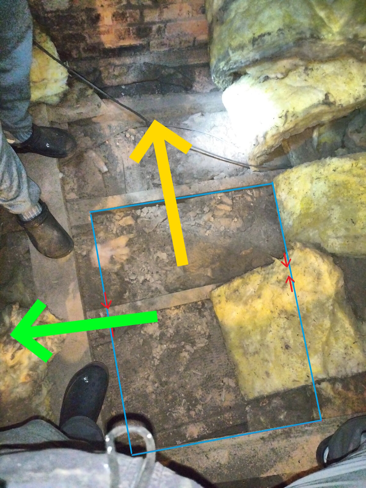

I do notice there is step up from the joists connected to the ceiling to the a main beam that we are standing on. Is this going to get in the way of the ladder retracting - if they don't go up towards the wall (yellow arrow) but instead go up the other way (green arrow).

If I can't get 70-80cm back retracted ladders, they will have to retract in the direction of the green arrow (rather than the yellow arrow). Is that beam is gonna get in the way and I am onto a hiding if I get the ladders to go that way?

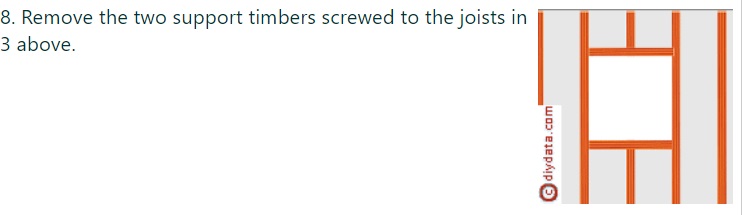

Guess I have to make the surrounding joists around the hatch flush with that higher beam and so its flat surface.
You would fix the ladder to the high timber.

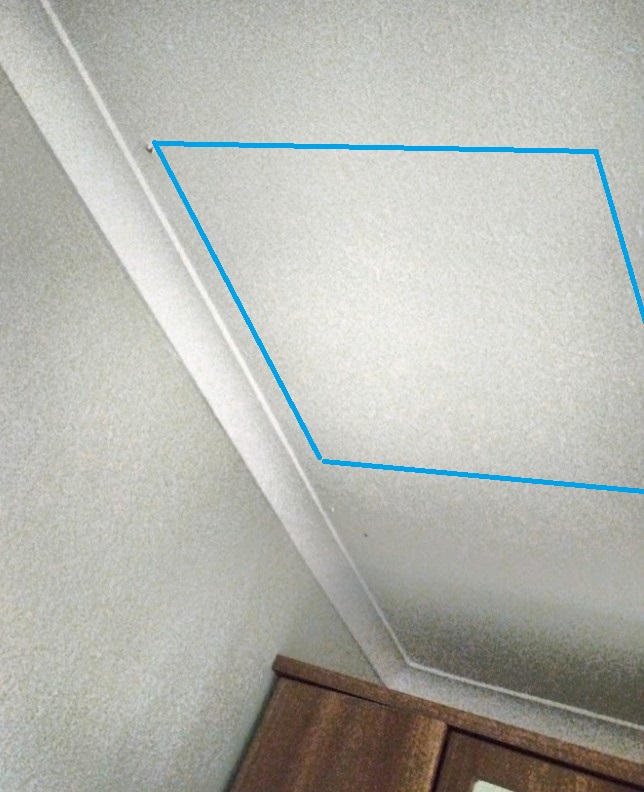

That wall in the bedroom below has some decorative archi-thingy on the ceiling.
Assume I have to come in a good 15-20cm+ from that loft big beam for the hatch hole to begin.
Perching the ladder onto that high beam will mean ladder will clear the lip and make it down the hatch hole when pulled down?
It will sit on the top edge of the beam and slope down. About a 1 in 4 slope I would guess.
You could add a substantial trimmer if you want.

https://www.diydata.com/carpentry/loft-hatch/loft-hatch.php

If i have to fit the ladder sideways (green arrow) - the main beam is about 10cm higher then the joist and needs about 20cm to avoid the ceiling edge - that is 2:1 slope which is less steeper than a 1:4 slope of the ladder movement - so if attaching the ladder to the main beam that would not work (I think?). Suppose I can just add a higher trimmer joist so the ladder clears and attach it to that edge. But I don't need to waste time freaking out about this. OK, ok... I think I can chill about this.

And thinking about it, make sense to have the ladder facing a space then walking up it and not facing a wall. So will go with moving the ladder into the green arrow direction.

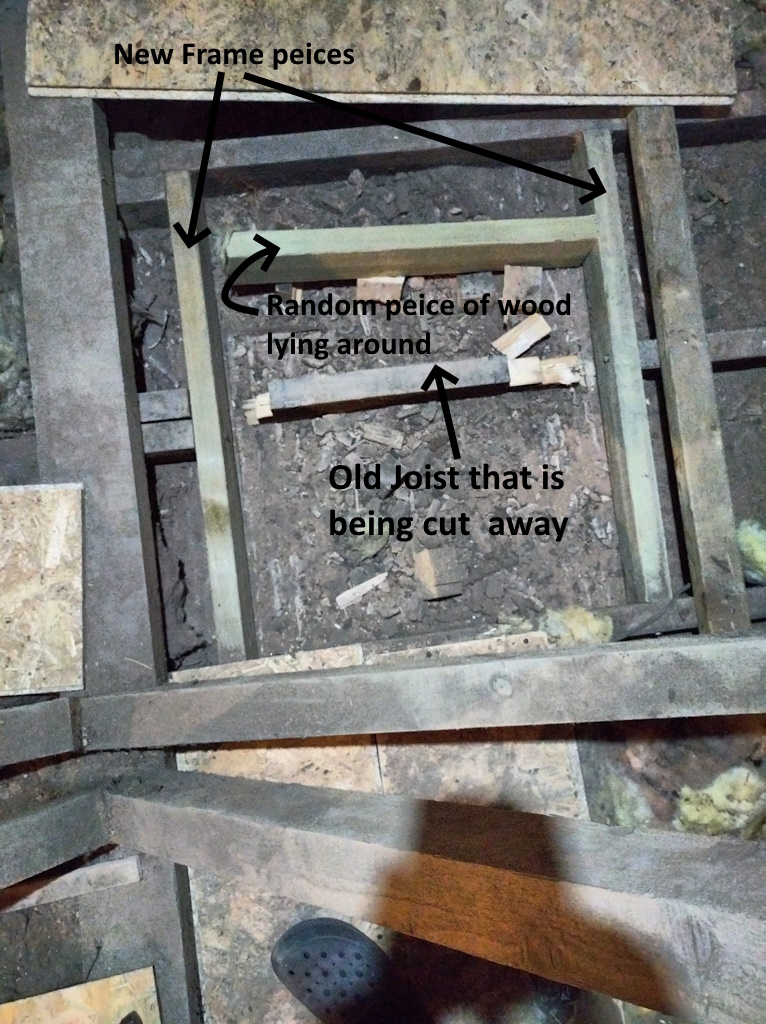

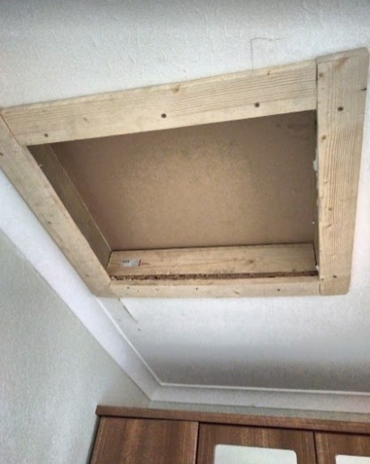

Made some progress today. Pic after first new joist piece.
Next one in below..
But I don't think it is very square at all. Maybe 1cm-0.5cm smaller gap on the bottom between the new pieces then gap on the top - not sure if should bother trying to correct this and how?
Also are there are any tricks to cutting that ceiling? - its lath and plaster stuff (lots of small strips of wood with nails into the joists) and not plasterboard. Maybe drill guide holes and then saw it from below rather than the top? Use a angle grinder? Anyway of ensuring it doesn't drop down and carry the dust down with it into the bedroom?
It certainly doesn't look it. You can use the 3, 4, 5 rule to check for square e.g. if you measure 600 along the joist from your noggin and mark it, then 800 along your noggin, it should be 1000 between the 2 marks if it's square. Then measure off that one for the other, and check between the 2 corners, they should be exactly the same. You can use any number but the longer the better, I'm assuming those joists are 400 or 450 centres so the numbers I used should work for you.

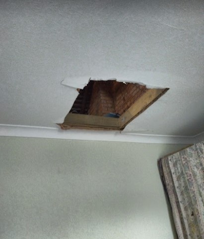

Hi, great info, but alas didn't see it and everything is a bit wonky now., with a bit of ceiling damage....

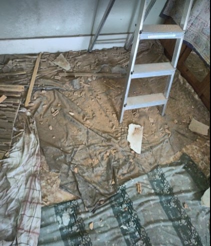

OMG the mess...
Now, where the heck do I find ladders from? Most of them seem to have an anchor metal pieces which I guess you have to tread on when you are up the top? - anyway to avoid this? Also are there any suggested ways of putting handles or holders once into the loft for safety - so u don't fall back?
