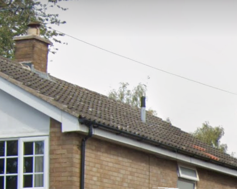

Check the soil pipe vent is clear at the top.
I did have a quick look from the ground when I got home from work and the grid on top looked clear, I will get some ladders up there tomorrow evening and have a closer look though
Yes that would be my plan of attack but I doubt it will reveal much unless you can get up on the roof to actually look down/rod it. Something I would be daft enough to sort but some people have more sense
