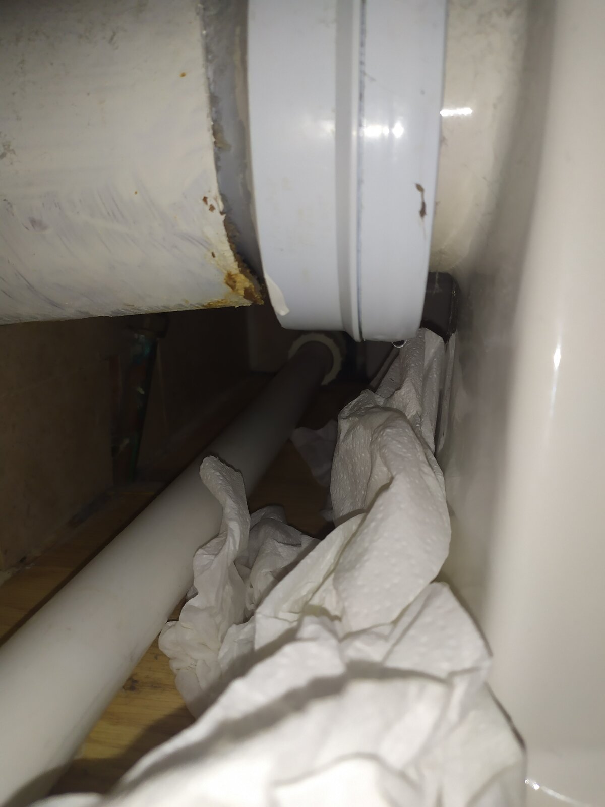

Woke up this morning to a puddle around the toilet!

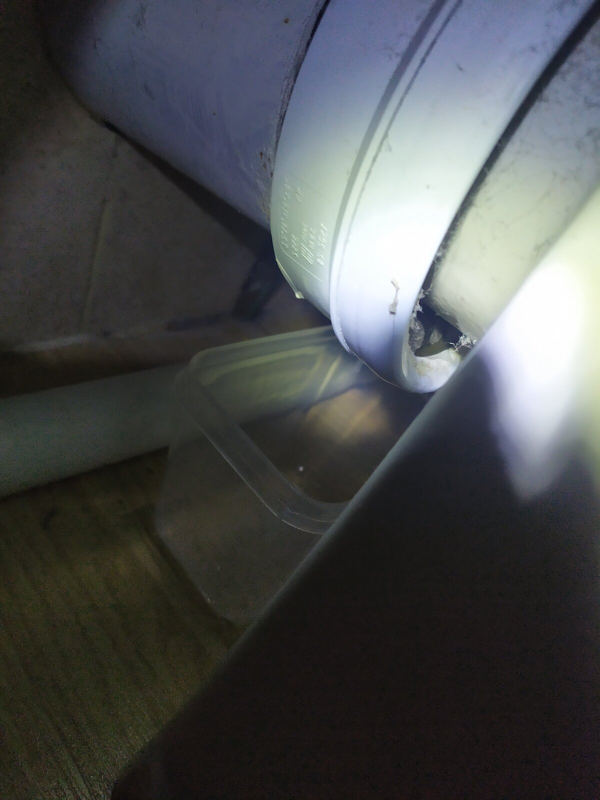

Different leak this time, appears to be coming from the waste pipe at the back. Not sure why that would start leaking as I didn't touch that area. Maybe re-tightning the cistern to pan/wall moved it slightly. Any ideas?
(you can see the drip forming on below pic, looks like it is coming from that seal perhaps)
Cheers.
Could it be coming from above ,but collecting at that point ?
A bit odd for the pan connector to leak if you didn't move the pan itself.
Looks like it is coming from bottom of the seal to me. The cistern was pulled into the wall when tightening the screw, perhaps that moved it enough to disturb the seal?
Not wanting to disturb anything else much more, I wonder if there is enough play in the toilet floor screws to just push it into the pan connector more?
