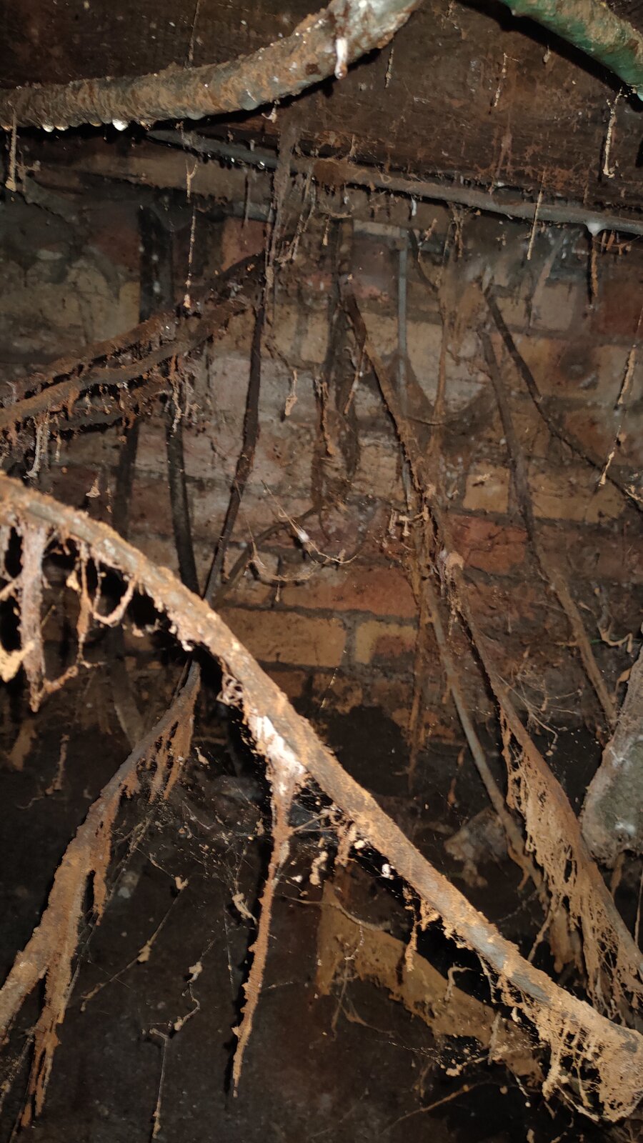

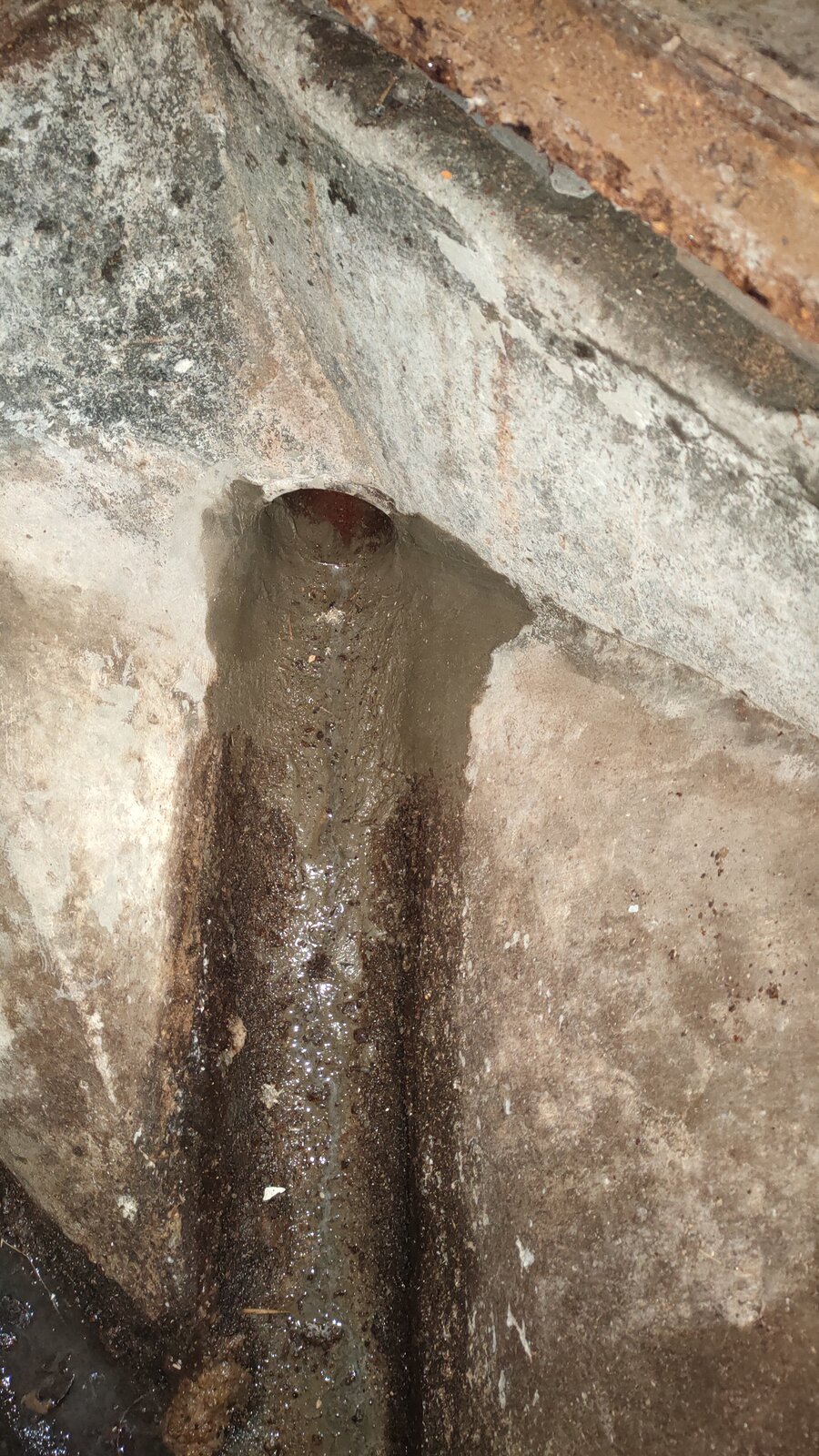

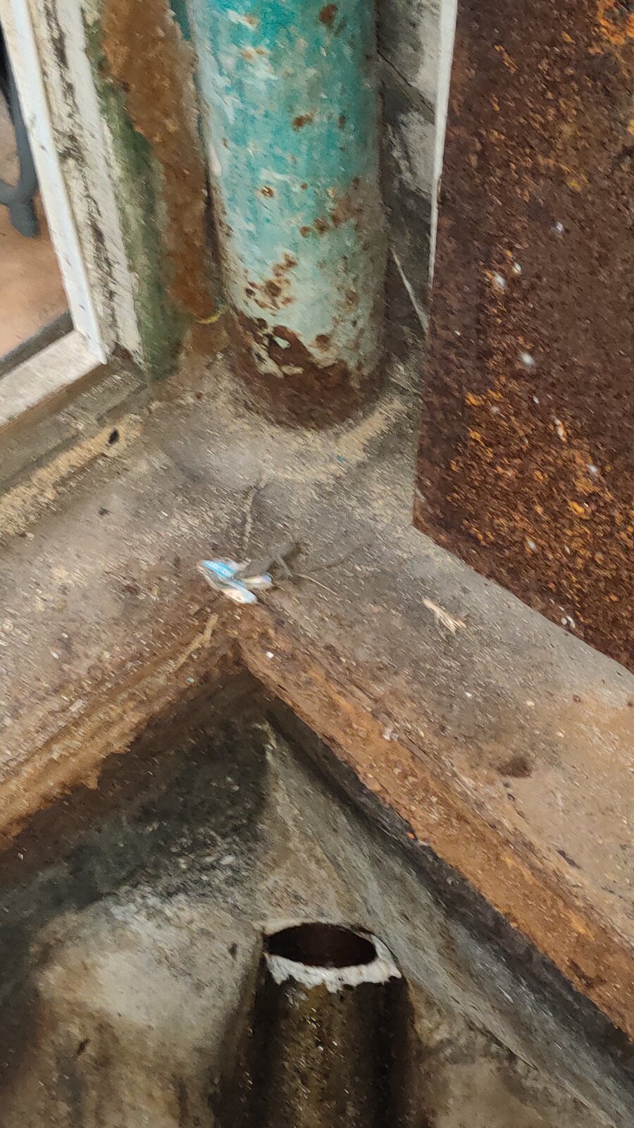

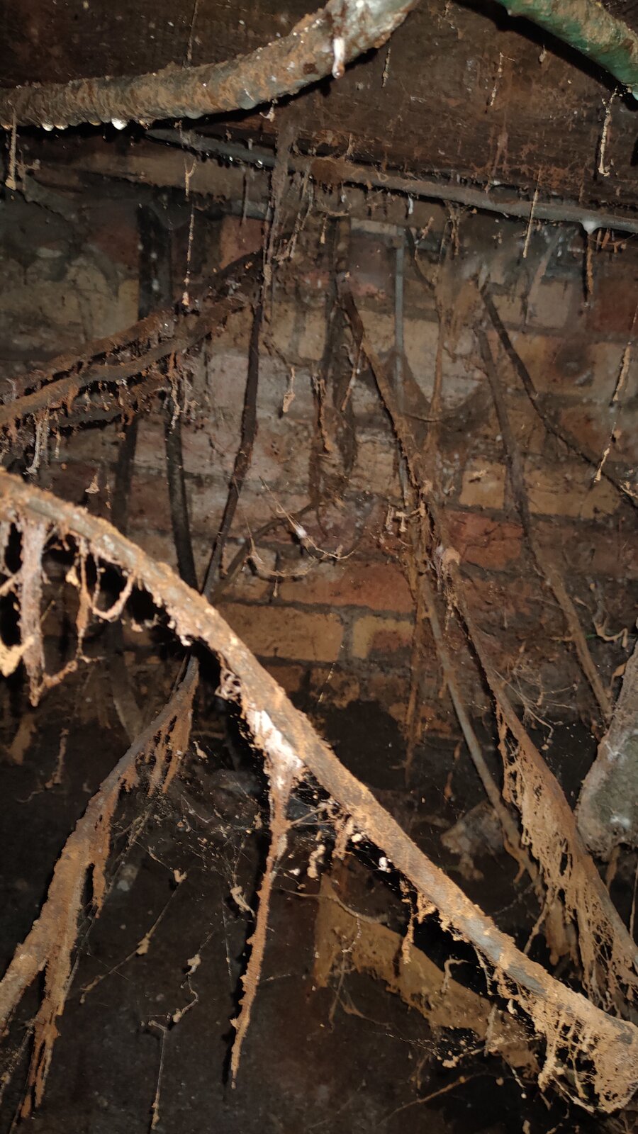

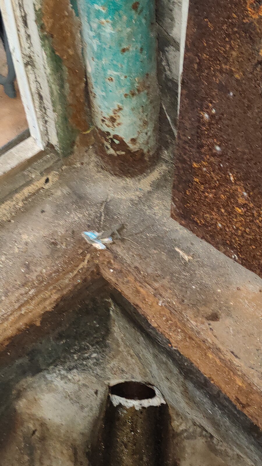

Plumber came, made a reasonable guess the leak was water getting back under a gap below the exit pipe. Tried a seal with that white sealant. £60. Said he could come back and cement it in. That would be another £60 so I did it myself. £14 for Bostik Cementone "waterproof" masses left. Unfortunately didn't work so logically the leak is probably at the other side where it is next to and behind the foundation wall! Would have been worth £60 if correct! Logical thing to try first but I can't keep shelling out £60 per hour for the bigger job ahead now I'm on a low income. So obviously now a big job so gone via Insurance. Will still cost hundreds though. £250 excess!! Trace and access. Floorboards up and the works looks like. Now that's a job that would demand a higher rate!

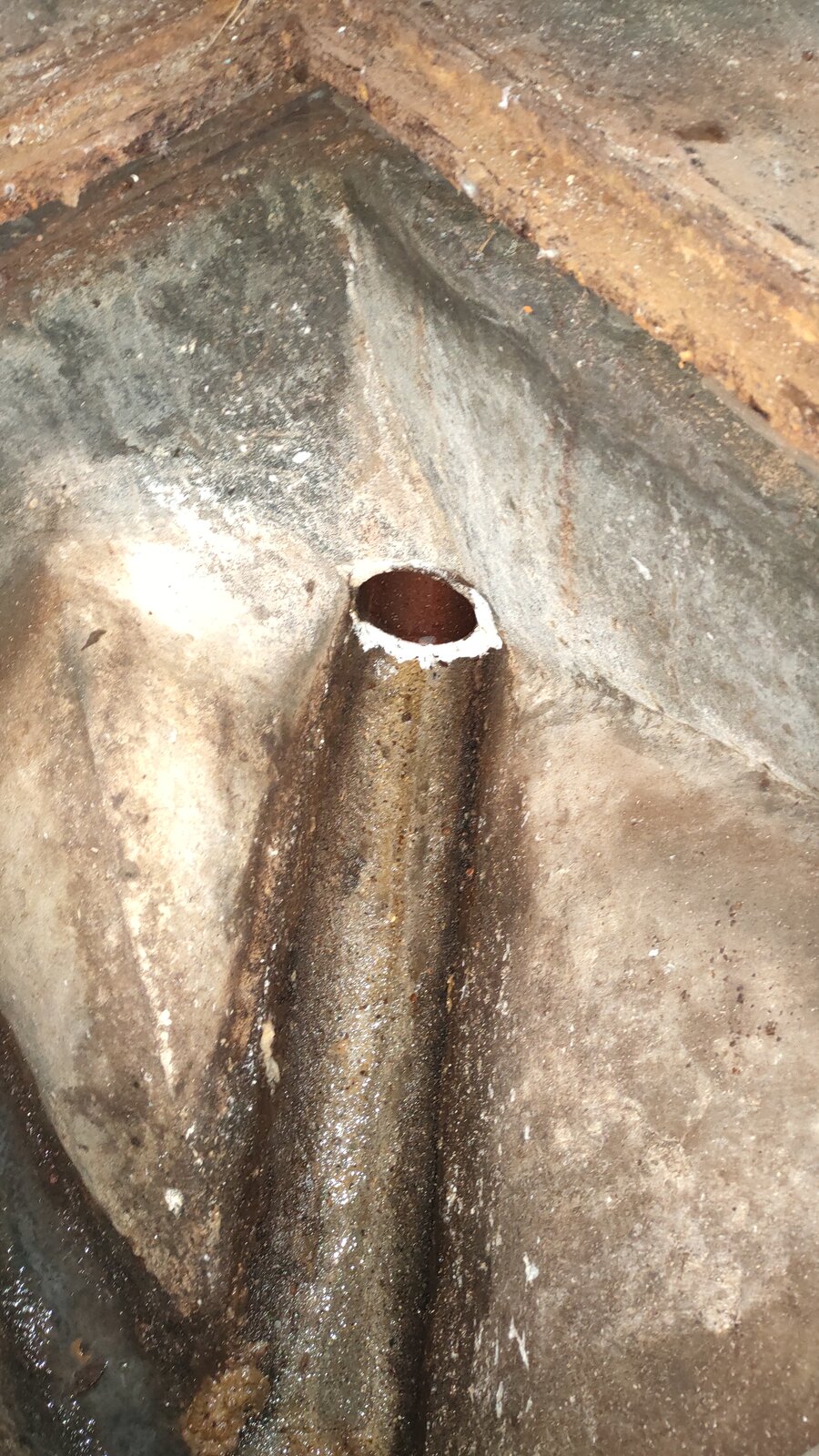

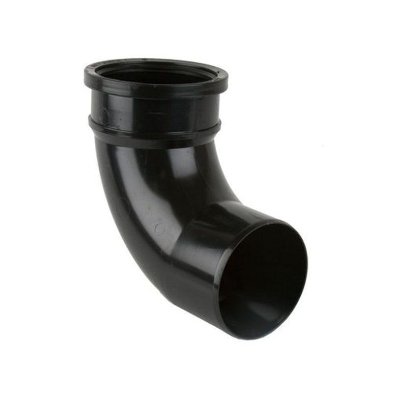

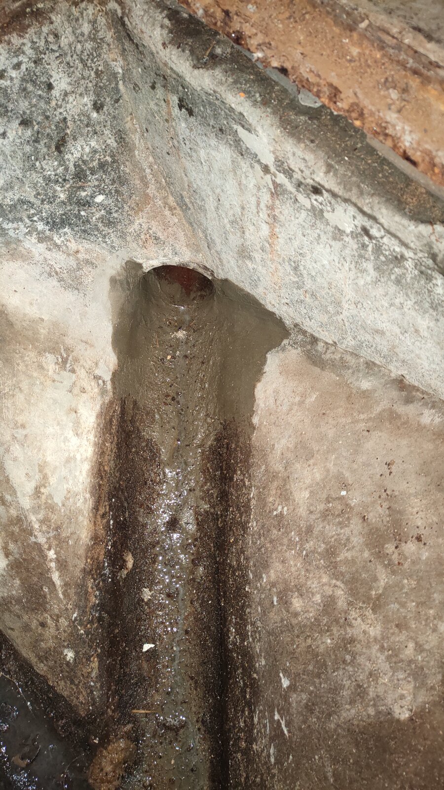

Exactly my system. Going to cost me £500 to line that tiny pipe. If it was simply underground as in the photo instead of where it is I would dig it up myself. I used my own DIY camera and it does seem to be broken at the joint as suggested by the plumber.

It's only a 2 foot curved pipe and looks like gone at the joint - I adapted my own camera I used for the car to look. Fits into washing machine pipe perfectly for easier control and as it's a very short length of pipe easy.
