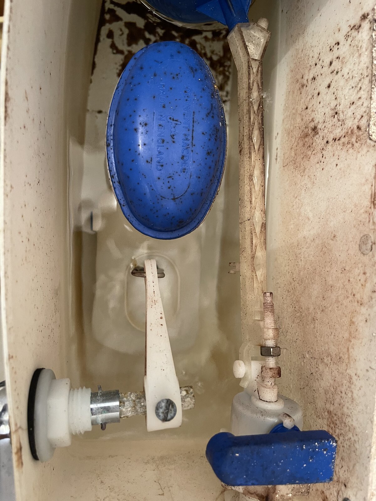

As HERTS says,it’s your washer that needs replacing.Hi, does anyone know why my toilet makes a weird noise when flushing? I have an old style toilet. Are there any issues with the pipes?
Would that 100% fix it or will I need to change the whole toilet?Washer in float valve needs to be replaced.
Andy
Is it a knocking /vibrating noise ?Would that 100% fix it or will I need to change the whole toilet?
Yes, it’s a bit drastic changing a toilet for a washer, or worse case a new float valve.Would that 100% fix it or will I need to change the whole toilet?
Also which one is the washer?
It is a vibrating noise. Sometimes I also get a knocking noise.Is it a knocking /vibrating noise ?
I will try. Also one part drips when I flush.It is in the unit in the bottom right hand corner of your photo, where cold water goes in. Simple check - try flushing, but holding the arm up on the unit, if it makes no noise until the arm is released, then it is the fill valve.
