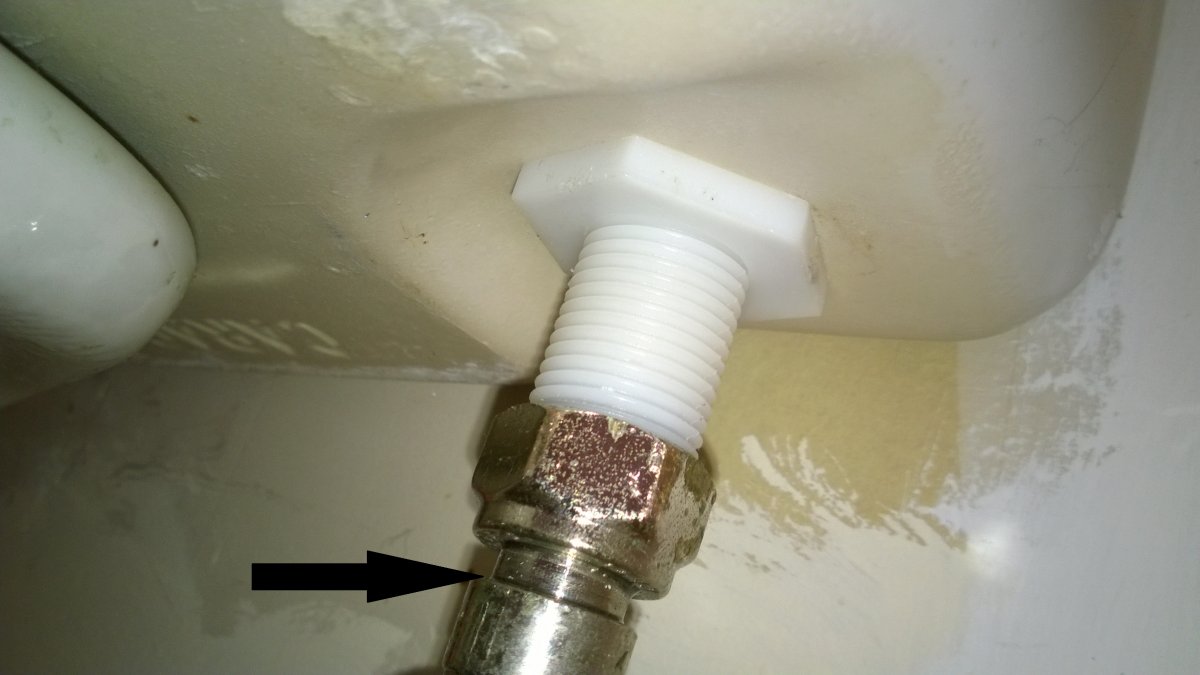

Toilet refilling slowly
they are pushed together, the nut is to stop them coming apart. Pull the metal pipe down.
Hi,
Thanks for this. The metal nut has actually been tightened up in the image. When I undo the metal nut it goes down to where the arrow shows in the attached image and no further, the plastic tube seem to go down a little further and I cannot get it out.
Thanks,
D
You either need to have a little free play in the feed pipe below the fitting to pull down or loosen the cistern to lift it up and off the inlet feed pipe..
