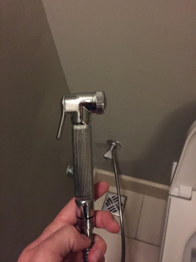

Hi folks,
I've been in the Southern Hemisphere for a few weeks and noticed that most toilets have a little sort of shower-head spray-gun type device next to the bowl used to blast away any 'remnants' of your movements, instead of a toilet brush. It seems like a mighty fine idea and much more hygneic than a festering brush so I'm going to incorporate it into my new wet room.
Only problem, I can't find the key piece of kit in my usual stores. Picture below, it's basically a thumb operated spray gun much like you'd get for the garden hose but nice and chromed up and with a shower hose attachment.
Anyone seen something like this for sale anywhere in the U.K.?
Cheers.

Not allowed without a break tank and pump arrangement. But everyone one that has asked about them on here has demonstrated how little they care for their health and that of their neighbours and have ploughed on anyway.

What's all this about them not being allowed? So I can put one on an outside tap surrounded by rat droppings and dog crap with just a double check valve but suddenly in the vicinity of human feaces it needs a whole new set of regs?

The reason for use is in the title "Muslim" & "Douche" ffs, and not allowed by water regs in the UK but as Dan said you see them all over.

It's treated the same as the bidet image above - Water Regulations require that it has backflow prevention to Fluid Category 5. A double check valve only protects to Cat 3. Essentially you're not allowed to connect it to the water main in the UK - it must be tank fed on its own dedicated supply
