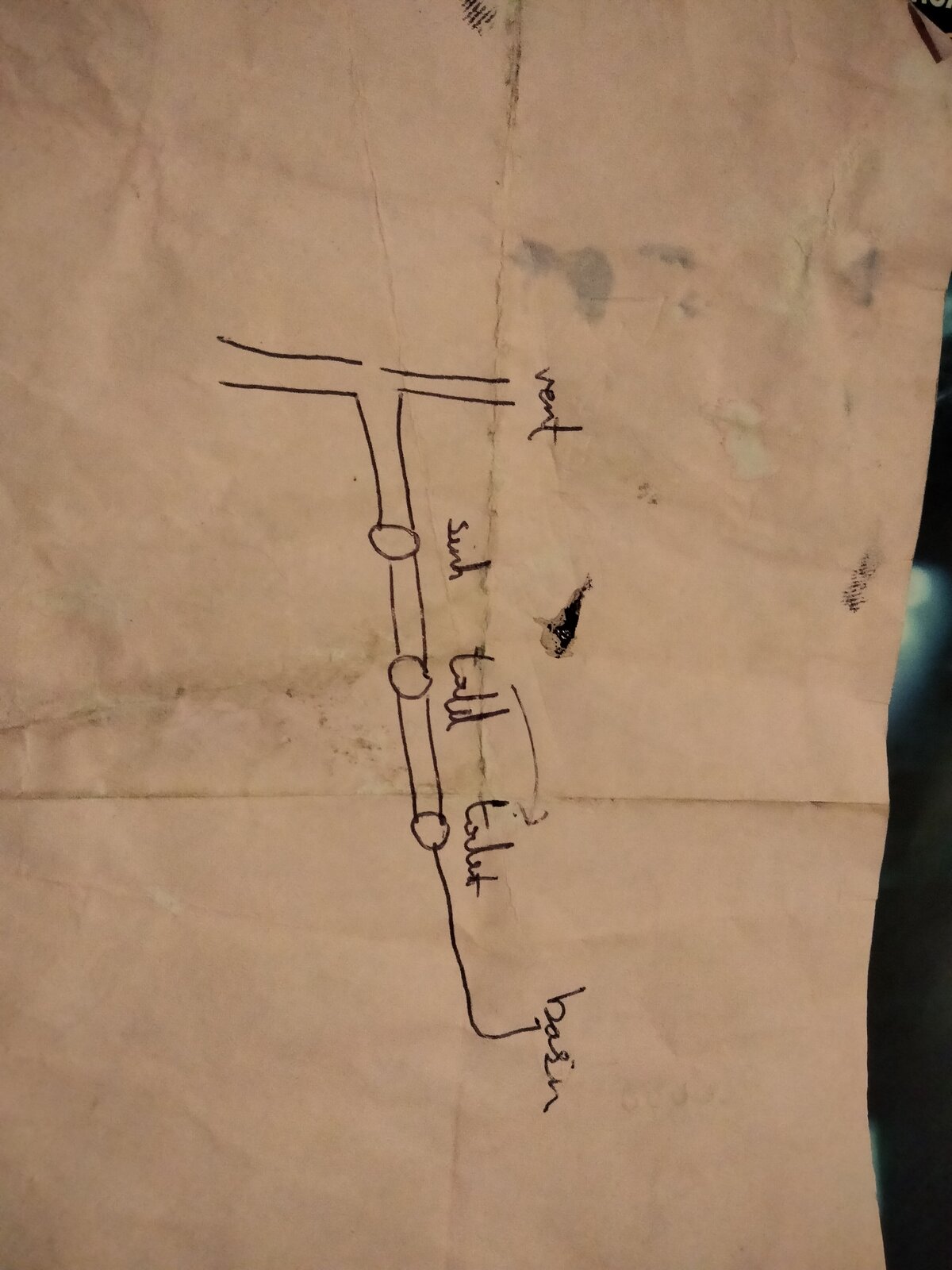

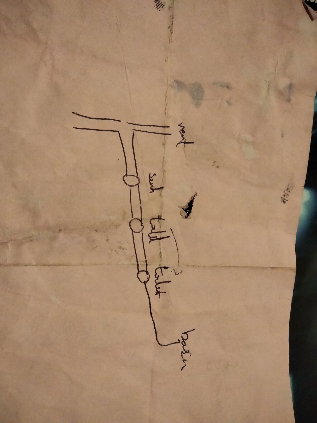

It seems to be poo etc appearing in the toilet trap. Is it likely a blockage or lack of vent causing it. If was a blockage could a plunger help remove.
A plunger is unlikely to help. It could be either a blockage/obstruction in the pipe or lack of a vent. You can check for a blockage by lifting the manhole cover, then having someone operate the flush - the flushed water should very quickly appear and very quickly be gone.
The flushing one toilet affecting the level in the other, suggests their is no proper vent. They all do need a vent of some type.
There is no blockage I managed to look down the pipe via removing the external elbow where the soil pipe enters the building and replace with a tee and extend to have and external vent. But the problem has continued.
That is the lay out with flushing the toilet closest the sink leads to water going back up the toilet at the end of the run. Nearest the basin.
