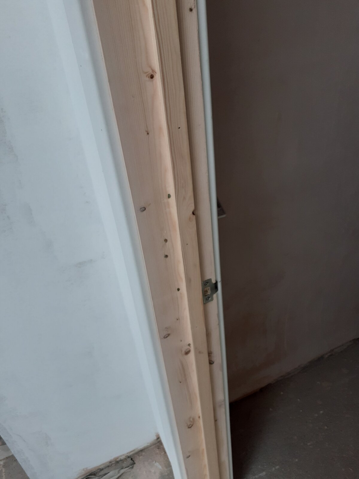

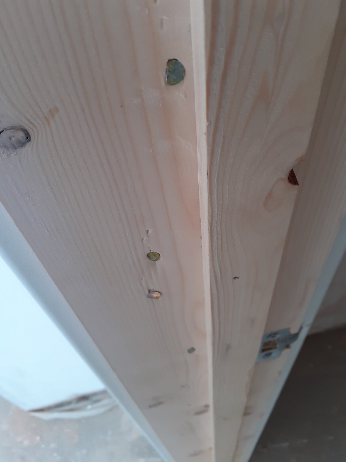

No. The bigger head nails don't need to sit inside the hollow. Just make sure you centre it on the nail head and strike it vertically. If you are not holding it vertically it may slide off and damage the surrounding wood.
So no need for a wider or bigger nail punch? I
Stanley do three sizes. The largest can even be used for small oval nails... Bahco do 4 sizes, Starret do 5... I think
No, I've always found the 3 standard sizes are sufficient. Then again, I don't use nails a lot unless it's for rough form work or casing where the nail heads are flush will be eventually covered.

Regarding above pixs. I know hole punches are not used for big headed nails
It was just to give scale. The nail positioned up to the punch (in pix)was the smallest I could find. I just seemed to remember the one I borrowed being bigger than the biggest Stanley one but could be wrong. I thought the nails have to be small enough to fit INSIDE the punch not same size

How would I get these 5mm (approx) nails below surface before filling then painting on architraves
